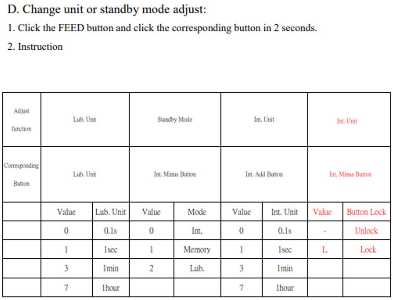

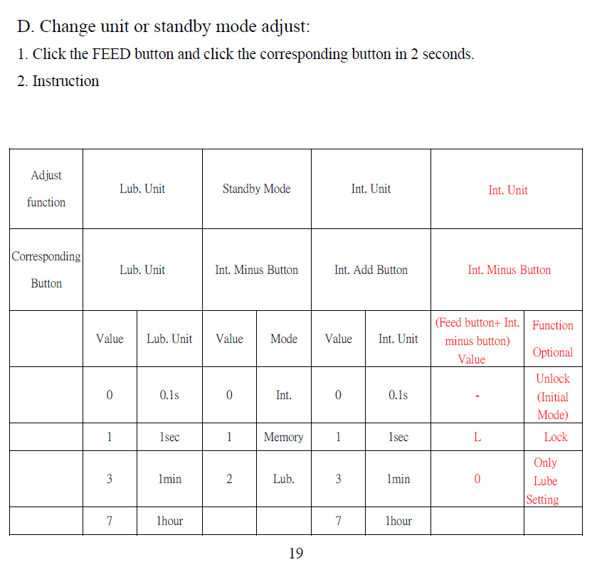

If you have an auto oiler, that seems to be counting down the interval time in seconds, rather than minutes, follow this procedure to change units, to minutes.
To access the configuration, you have to press the FEED and Interval Down Arrow at the same time.
Once accessed the setup mode, you have to use the last arrow to select the “-” Symbol, release the feed button to confirm the setup.
