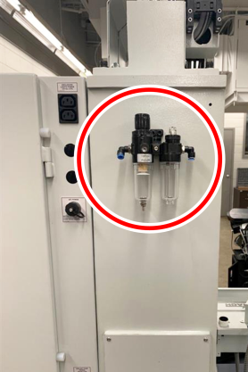

  1. Identify the two holes on the back of the column. This is the mounting location for the FRL.
Figure 2: FRL installed on the machine.
  1. Install the FRL bracket on the machine with your own hardware.
  2. Connect the air lines to the quick-connect bushings.
