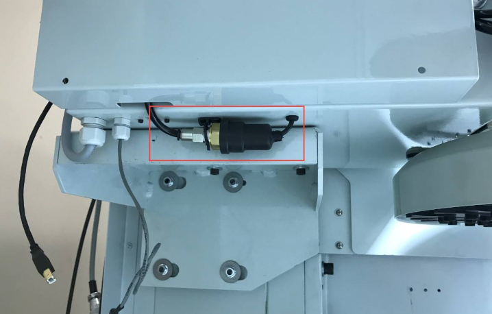

Left Hand Side View of ATC
Verify air pressure at your FRL and compressor
Reason: Air pressure too low.
For a properly function ATC and Power Drawbar, your machine FRL should be set between 90-120 PSI.

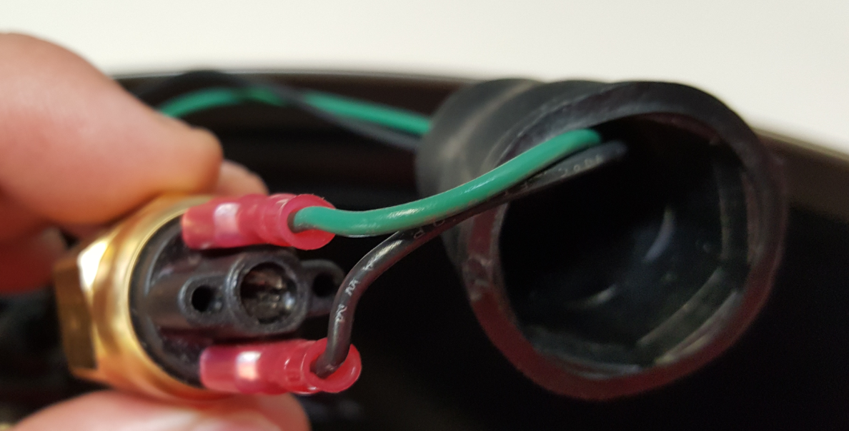

Disconnect and/or replace the sensor
Disconnect the two wire leads from the ATC board, which opens the circuit and allows the machine to run.
Recalibrate the sensor
There is an adjustment screw under the rubber boot in the back of the machine for the pressure sensor. Set your regulator at the lowest pressure your air system provides and turn the screw until the “Air Pressure” LED on the status tab turns green. Inward should set it to a higher pressure and outward should set it to a lower pressure. (Newer sensors have a 3mm hex bolt, instead of the flat blade)
