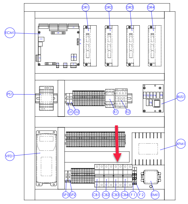

Console isn’t receiving power
Test the power button functionality
Examine the green ring around the power button. It should light up when you press the power button.
Examine power input to the console
Examine the green LED on the power brick for the console. If it's not lit, examine and reseat the power cords to the power brick.
If further action is needed, inspect your machine's Accessory circuit breaker.
If the monitor and the controller both don't have power, examine the power cords for damage or exposed wires, and then reset the CB3 circuit breaker.

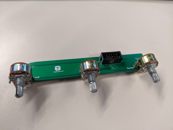

RPM, Feed Override, or Max Velocity knobs don’t work

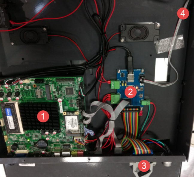

Examine the connectors on the ribbon cable
Remove the rear panel of the console.
Examine the connectors on both ends of the cable going from J4 on the control board to the potentiometer board.
Examine the USB connection to the control board
Examine the USB cable going from the header on the computer motherboard to connector J12 on the control board.
If you are able to move the RPM, Feed Override, and Max Velocity sliders with your finger or mouse, the USB daughter board will need to be replaced. (PN 39146)

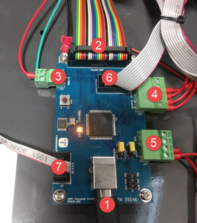

Buttons don’t respond (Cycle Start, Feed Hold, LEDs, MPG)
Examine wiring to buttons
Examine the wire inputs to connector J13 on the control board. If any wires are loose, tighten the screw terminals.
Using a continuity tester, measure the resistance between terminals 1 and 2 when Feed Hold is pressed and terminals 3 and 4 when Cycle Start is pressed.
If there's continuity at the terminals on the control board and the buttons still don't work, examine the USB cable to the control board.
If there's not continuity at the terminals when the buttons are pressed, remove the lower rear panel of the console and examine the screw terminals on the rear of the buttons themselves.
If you have tested all terminals and the buttons still don't have continuity when pressed, replace the buttons:
Feed Hold Button (PN 37363)
Cycle Start Button (PN 37362)
Verify that the power LED on the console control board lights up when the console is turned on. If it doesn't light up, and you have confirmed the USB connection, replace the control board (PN 39146).
