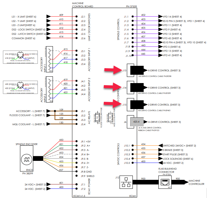

Reseat the connectors on the ECM Board and Motors
  1. Power off the machine.
  2. Examine the data cables at the machine control board and the servos removing then re-connecting them to ensure they are seated.
    1. Machine control board: Degson style
      1. 424 (J13) (X-axis)
      2. 425 (J14) (Y-axis)
      3. 426 (J15) (Z-axis)
    2. Servos: Molex style
770MX ECM Board

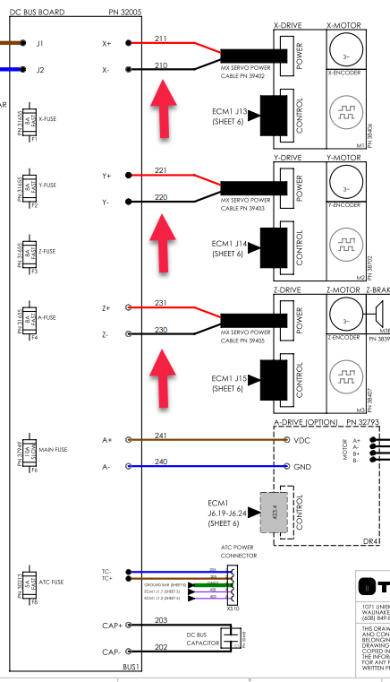

  1. Examine the power cables at the DC-BUS and the servos removing then re-connecting them to ensure they are seated.
    1. DC-Bus: Spade connector
      1. 210/211 (X-axis)
      2. 220/221 (Y-axis)
      3. 230/231 (Z-axis)

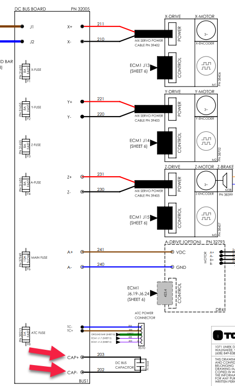

770MX DC Bus Board
Inspect the DC-BUS Capacitor (C1)
Reason: The C1 (DC-BUS) capacitor is defective.
  1. Power off the machine. Then, unplug the green power connectors on all of the axis drivers (X, Y, Z, and A).
  2. With the electrical cabinet door open, power on the machine.
  3. Examine the green LED on the DC-BUS board, and then twist out the Emergency Stop button and press the Reset button. The green LED should come on.
  4. Push in the Emergency Stop button.
    1. If the LED goes out in two seconds or less, the capacitor is defective and must be replaced. If the LED takes five seconds or more to go out, the capacitor is OK.
  5. If the results are not conclusive, power off the machine. Then, unplug the green power connectors from the axis drivers (if they're not already unplugged).
  6. Power on the machine). Then, carefully measure DC voltage on wires 202 (common) and 203 on the DC-BUS board.
    1. If there's a DC voltage of a nominal 65 Vdc (55-75), this indicates the capacitor is OK.
    2. If there's a DC voltage of a nominal 40 Vdc (35-45), this indicates the capacitor is defective.
770MX DC Bus Board

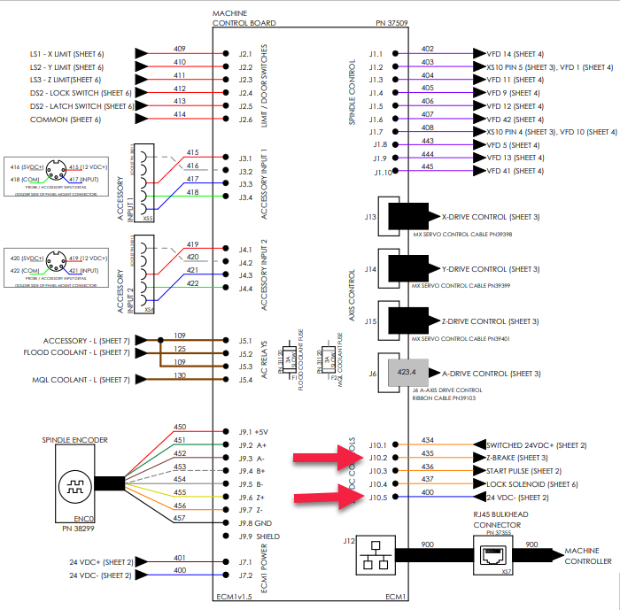

Inspect the Axis Brake
Reason: The axis brake is failing.
  1. With a multimeter, check for 24Vdc between wires 435 and 400 on the ECM board.
  2. If 24 Vdc is not present, the relay on the ECM board has failed and the ECM board needs to be replaced. If 24 Vdc is present, the brake has failed and needs to be replaced.
770MX ECM Board
