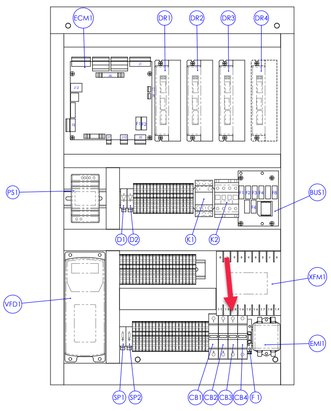

If the monitor and the controller both don't have power:
Examine the power cables for damage or exposed wires and replace if needed.
Reset the CB3 circuit breaker.
770MX Electrical Cabinet
