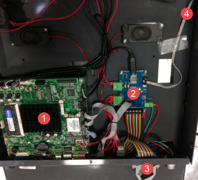

Console isn’t receiving power
Test the power button functionality

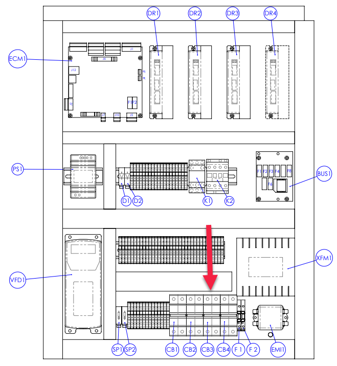

Examine power input to the console
770MX Electrical Cabinet
Configure the display output settings in BIOS
    4. Panel Color Depth: 24 Bit

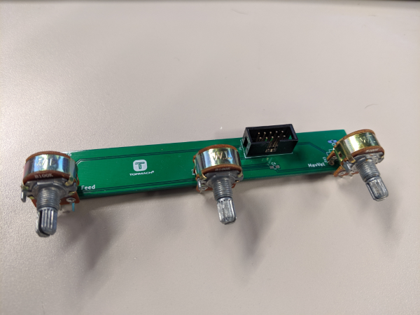

RPM, Feed Override, or Max Velocity knobs don’t work
Examine the connectors on the ribbon cable

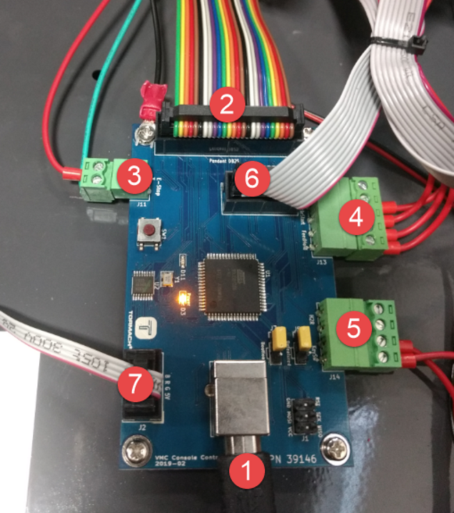

Examine the USB connection to the control board
  1. Computer
  3. DB25 Connector for Pendant
Daughter Board
  3. E-Stop circuit connection
  5. Key switch input
  7. Front panel LED connector
Potentiometer Board
