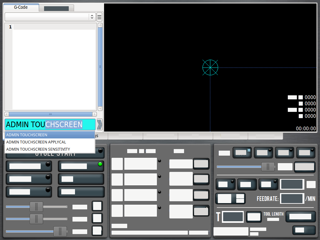

From the PathPilot interface, in the MDI Line DRO field, type ADMIN TOUCHSCREEN and press the Enter key on the keyboard. Then follow the onscreen prompts to calibrate the touch screen.

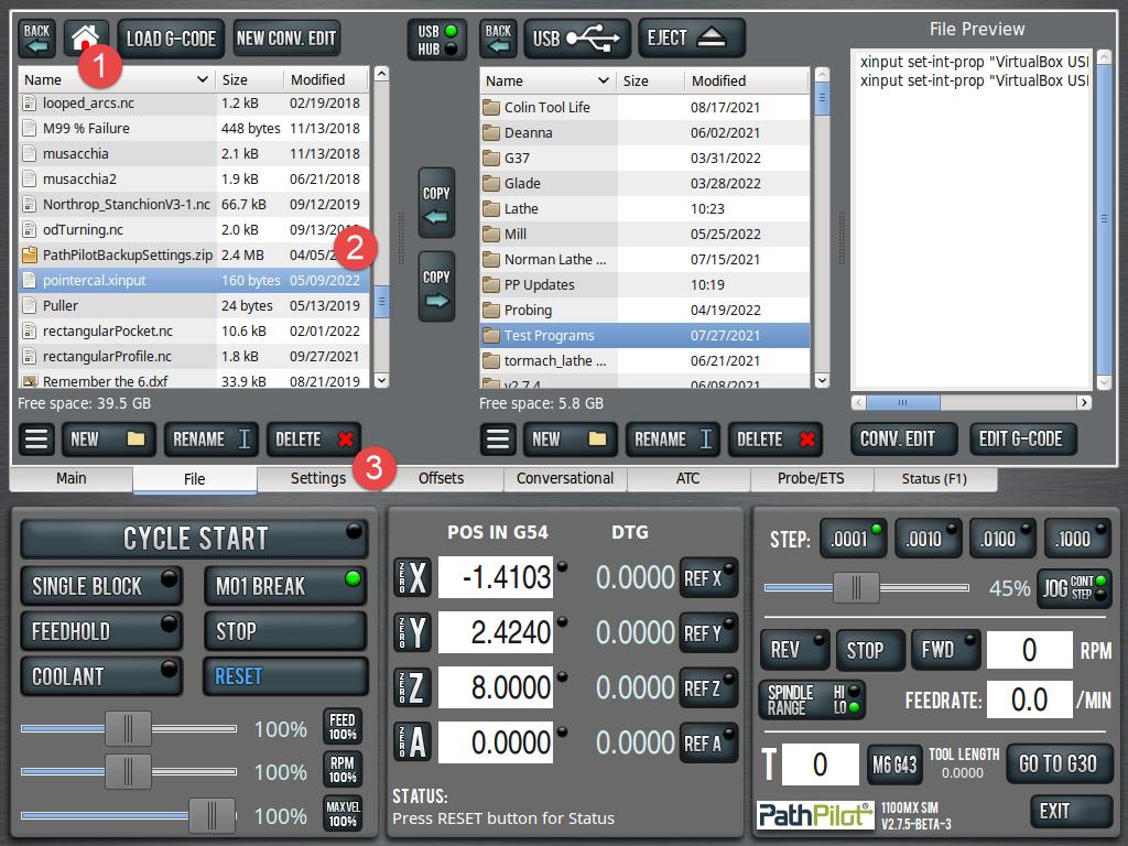

Go to the File tab in PathPilot. Press the Home button.
Locate the pointercal.xinput file and highlight it.
Press the Delete button.
Exit out of PathPilot and re-boot controller.
Upon restarting the controller, Path Pilot should prompt you to go through the touch screen calibration, make sure to touch all 4 touch points with finger or stylus (not mouse).
