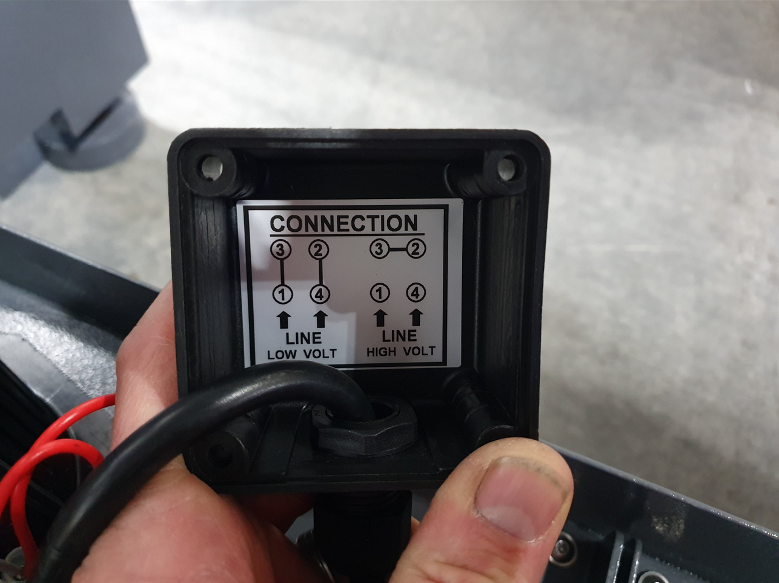

Reseat the Coolant Pump Power Cord

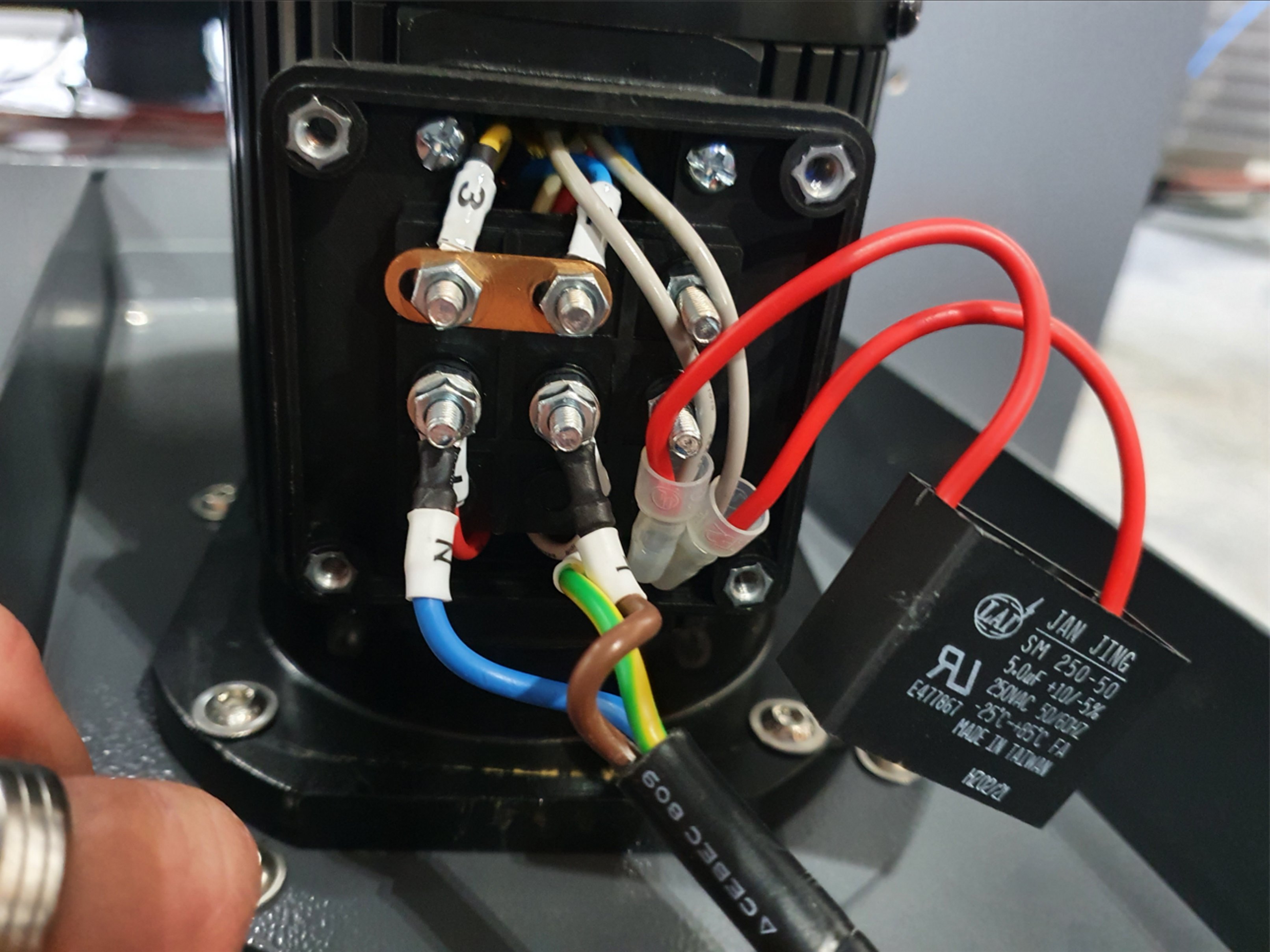

Inspect the Coolant Pump Strapping
Your pump should be wired for low volt configuration.

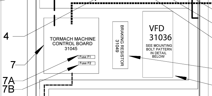

Inspect Fuse F2 on Machine Control Board
Reason: Fuse F1 on the machine control board is blown.
  1. Power off the machine.
  2. Locate and remove the F2 fuse from the machine control board (7B).
    2. If the fuse measure 0-5 Ω, reinstall it into the machine control board.
If the coolant pump shorts, the 3 A, slow-blow, F1 flood coolant fuse on the ECM1 control board blows before CB3 trips.
  1. Unplug the coolant pump power cord from the machine and examine it for damage.
  2. Test the coolant pump by:
    1. If possible, plug it into a known good outlet to see if it turns on.
    2. Use a digital multimeter to verify the motor’s resistances from winding-to-winding and winding-to-ground. If any winding-to-winding resistance measurement is a short (near zero resistance), an open circuit, or if the winding-to-ground resistance is a short, the coolant pump must be replaced.
