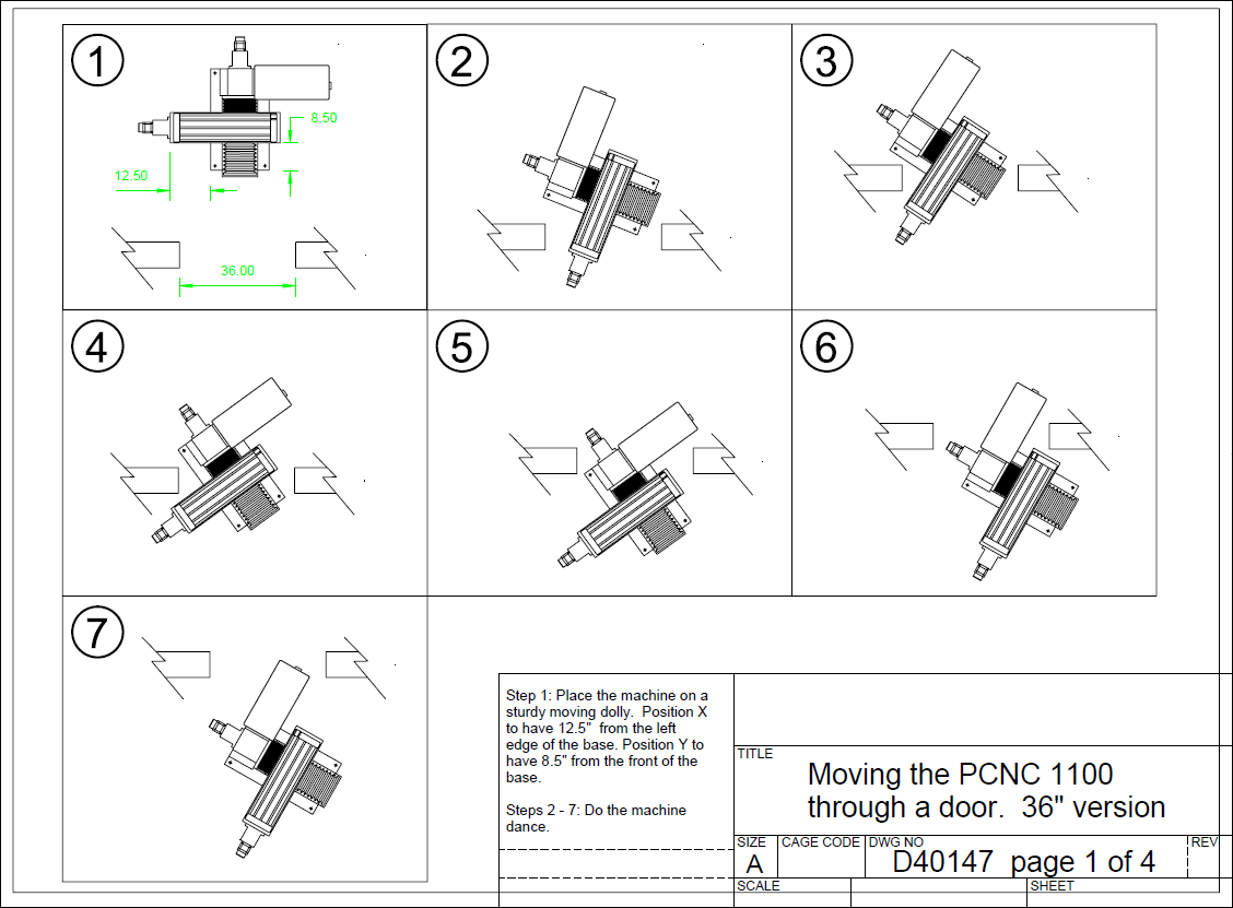

The following illustrations demonstrate how to move a PCNC 1100 (or M/MX) through different doorway widths.
  • High-capacity furniture dollies
36 in. Doorway

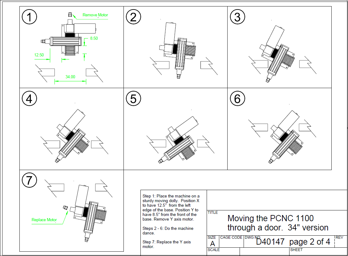

34 in. Doorway

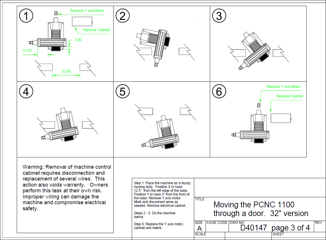

32 in. Doorway
(warning) REMOVING CONTROL CABINET VOIDS WARRANTY! (warning)

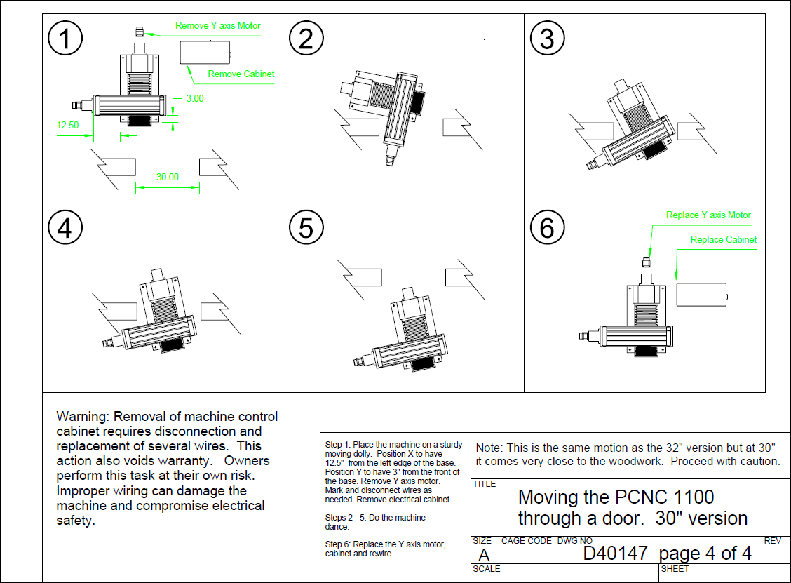

30 in. Doorway
