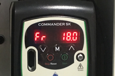

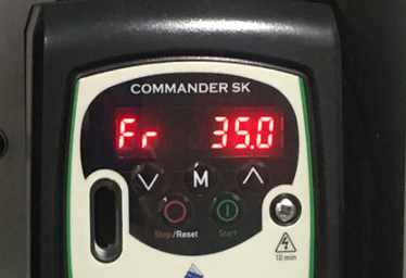

Spindle Calibration
To improve spindle speed accuracy, calibrate the speed control signal. This procedure is not necessary for mill operation.
This procedure requires access to the electrical cabinet while the mill is powered on.
CAUTION! Electric Shock Risk: Points within the electrical cabinet contain high voltage. Do not make contact with any part of electrical cabinet unless specifically instructed to do so. Failure to do so could result in serious injury.
  1. In the PathPilot interface, toggle the spindle belt position by clicking Spindle Range until the LED light is illuminated next to LO.
IMPORTANT! Ensure the spindle belt is in the low position. A mismatch between the spindle range button in PathPilot and the actual spindle belt position will result in the commanded speed being different from the indicated RPMs.
  1. Set the spindle speed to 500 RPM. Depending on your workflow, do one of the following:
  • Type S500 in the MDI line and press Enter on the keyboard
  • Type 500 into the S DRO and press Enter on the keyboard.
WARNING! Moving Parts Hazard: Keep hands, feet, hair, and clothing away from moving parts. Failure to do so could result in serious injury or death.
  1. Ensure there are no tools in the spindle; start the spindle.
  2. Inspect the value displayed on the front panel of the VFD; the recommended range is detailed in the following table:
PCNC 1100
34-36 Hz (see Figure 10)
PCNC 770
17.5-18.5 Hz (see Figure 11)

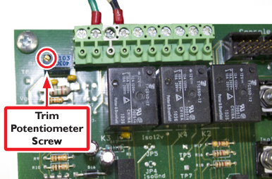

Figure 10
Figure 11
  1. If the value is outside of the recommended range, use a small, flat-bladed screwdriver to adjust the Trim Potentiometer Screw on the Machine Control Board (see Figure 12) until the value on the front panel of the VFD displays within range.
Figure 12
NOTE: If better accuracy is needed, use a tachometer to measure actual spindle speed.
