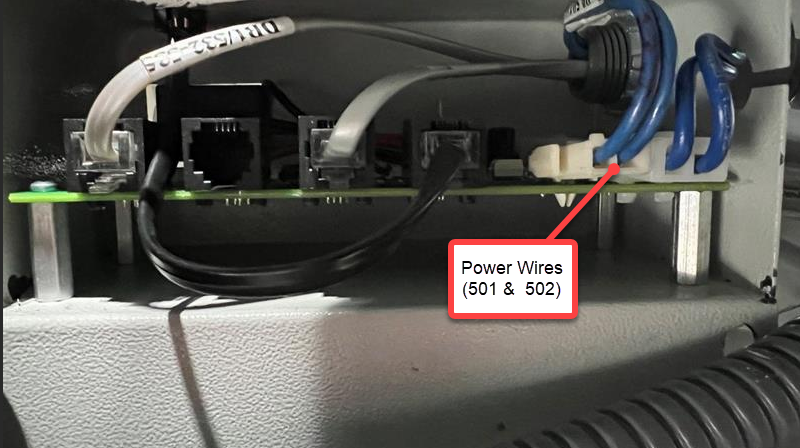

Check the Voltage on the Power Drawbar Board/Solenoid
Reason: There may not be 12 VDc going to the power drawbar and/or solenoid.
  1. Using a multimeter, check for 12 Vdc on wires 501 and 502 at the power drawbar board.
  1. Depending on the result, do one of the following:
    1. If there isn’t 12V at the location: There may be an issue with the daughter board (31980) or wall wart power supply if you do not have an ATC. Contact Tormach Tech Support for guidance on how to proceed.
    2. If there is 12V at the location: Go to Step 3.

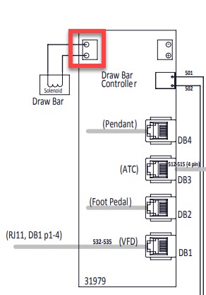

  2. Check for 12 Vdc on the wires that go to the solenoid at the time the power drawbar is pressed. These wires don’t have labels, but they're connected to the white connector on the back side of the PDB controller. Put the leads on each terminal once disconnected, and then press the PDB pendent.
    1. No power at the solenoid connector at the time the pendent is pressed: The power drawbar board (31979) is likely bad and will need to be replaced. Contact Tormach Tech Support to verify this before placing an order.
    2. Power at the solenoid connector at the time the pendent is pressed: The drawbar solenoid (31498) is likely bad and will need to be replaced. Contact Tormach Tech Support to verify this before placing an order.
