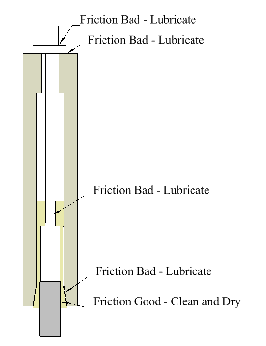

A collet with drawbar is shown below. The collet is closed by screwing the drawbar into the collet. Looking at the cross section, it becomes obvious that there are multiple sliding surfaces where force applied at the drawbar wrench can be lost due to friction. The only place you want to have friction is between the tool and the inside of the collet. There should be anti-seize lubricant used on the outside of the collet, the threads in the collet, and both sides of the drawbar thrust washer. Friction in any one of those areas will diminish the necessary force between the collet and the tool, making the tool more likely to slip.
![](../__attachments/3795484674/image-20210517-202704.png?inst-v=f3bbd44f-67ba-4391-a327-348520a51a3c)

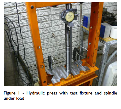

The test procedures focused on static force pullout of a TTS tool using a hydraulic press. Two variables were considered:
Surface preparation where the inside of the collet meets the outside of a tool, where high friction is necessary.
Surface preparation where low friction is necessary. This is the outside of the collet, the threads, and the
thrust washer area at the top of the drawbar.

Keep the shanks of collet mounted tools clean and dry. Tools must be cleaned when they arrive. The oil used to prevent rust during shipment is very detrimental to tool holding ability. Tools should be cleaned on occasion as they can accumulate way oil and oil from coolant emulsions.
Keep the inside of the collet clean and dry. Similar to the tools, collets must be cleaned of preservative oil
when first received.Lubricate the outside of the collet and the inside of the spindle taper with anti-seize lubricant. These are
sliding surfaces and are best kept lightly lubricated. You can use Tormach PN 31273 or any other good quality anti-seize type lubricant. Lubricate sparingly to avoid risk of the lubricant migrating to the inside of the collet. Only the first inch of the spindle taper needs to be lubricated.Lubricate the threaded section of the drawbar, the thrust shoulder, and the thrust washer with anti-seize
lubricant.Drawbar torque generally needs not exceed 30 ft lb unless extreme machining conditions are expected.

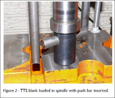

Testing Methodology and Tools
Load was applied with a 12 ton HF hydraulic press. Load was measured with a Dillon force gauge. The testing fixture was built to reach around the spindle and apply load directly to the TTS tool holder. The TTS blank has a 5/8” hole bored through for a short length of 5/8” rod to be fitted in. The bottom of the long arms of the fixture are radiused to match.

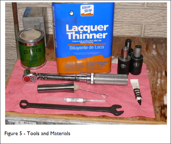

Tools and Materials used:
![](../__attachments/3795484674/image-20210518-140717.png?inst-v=f3bbd44f-67ba-4391-a327-348520a51a3c)
Klean Strip Lacquer Brand
All abrasives were Clover Brand
Snap-On 0-75 ft. lb. click type torque wrench
Ungar brand Anti-Seize compound
Not shown: WD-40 and way oil

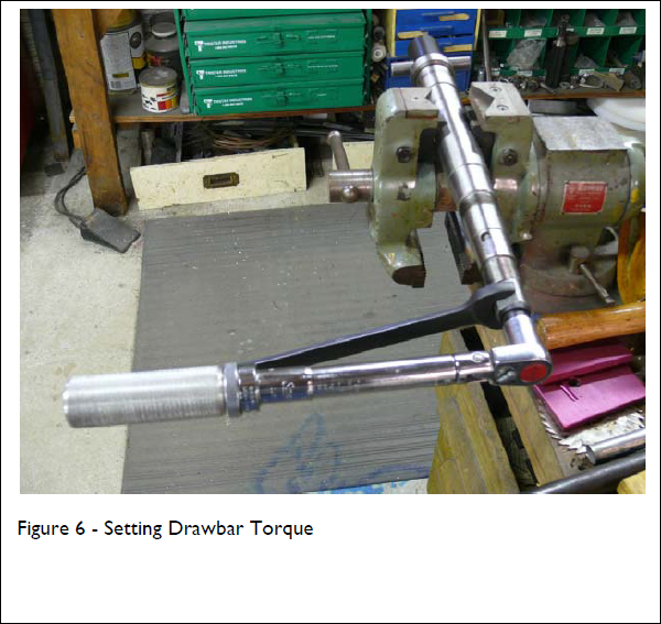

Spindle was held in a pipe vise for “tool changes”. Good torque wrench etiquette was followed. If a clean “click” was not achieved it was loosened and re-tightened.

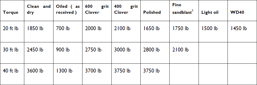

Testing Alternative Friction Surfaces
While the conventional recommendation is to keep both the tool and the inside of the collet clean and dry, this practice is not always followed. In the first sequence of tests, the Clean and Dry condition is compared to a variety of reported practices. All tests were repeated 3 times or more if results were outside of the statistical norm. The variation here is only on the friction surface of the inside of the collet. Treatment of the other areas followed recommended procedures. This means there was anti-seize compound applied on the thrust surfaces of the drawbar and outside of the collet, collet threads, and drawbar washer. In cases where the results showed significantly less resistance to pull out compared to Clean and Dry, testing was not continued.
![](../__attachments/3795484674/image-20210518-141653.png?inst-v=f3bbd44f-67ba-4391-a327-348520a51a3c)
Observations:
The As Received condition of new tooling has the tool coated with heavy oil, necessary for protection against rust during shipment. It is very clear that this oil should be removed. Cleaning with WD40 can remove the heavy oil and provides some protection against rust, but the holding power remains below that of the clean and dry condition. Use of a fine abrasive suspended in oil, such as Clover lapping compound, has been recommended by some people as a method of preventing rust while at the same time improving collet/tool interface friction due to the abrasive.

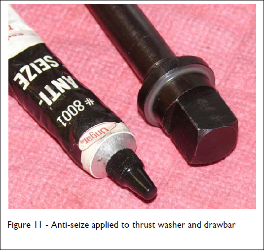

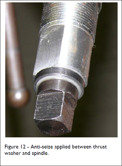

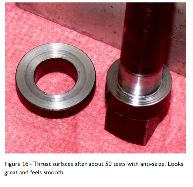

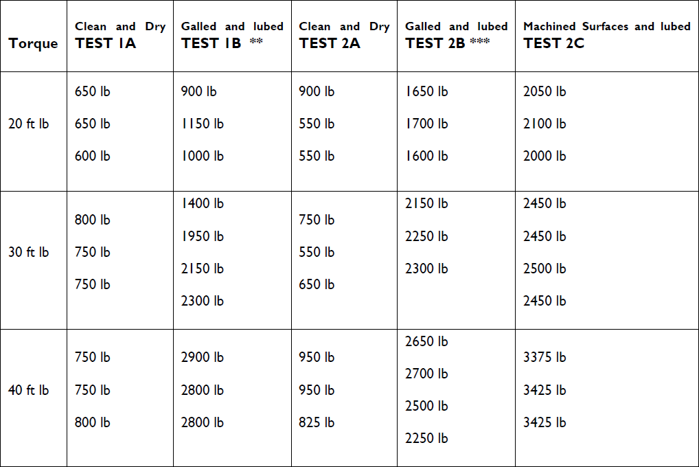

Testing Alternative Drawbar Preparations

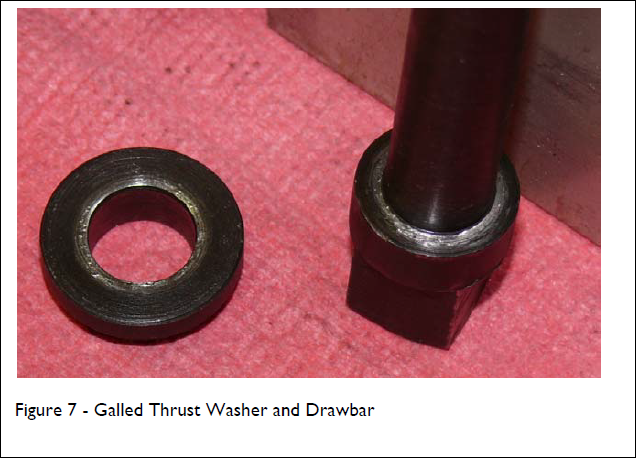

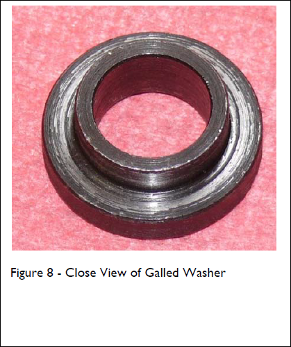

We are aware that not everyone will bother to apply anti-seize lubricant to the drawbar, threads, or collet taper. This set of tests reveals the impact of lubricant, or lack of lubricant, on those surfaces. This testing was done with a new drawbar, new drawbar thrust washer, new collet, and new TTS blank.
(1) Note: The sand blasted finish wore off very quickly, reapplication not worth yield.
![](../__attachments/3795484674/image-20210518-142314.png?inst-v=f3bbd44f-67ba-4391-a327-348520a51a3c)
** This data should be read from top to bottom. Results improved as the drawbar wore in.
*** This data should be read from bottom to top. Testing Started at 40 foot pounds and worked down, wearing the galled surface in.
Clean and Dry means the drawbar, thrust washer, collet and spindle were degreased and washed with lacquer thinner. The first column (Clean and Dry TEST 1A) produced the parts for the second column since the washer and drawbar became galled during the clean and dry test. In the second column, Galled and Lubed, the galled parts from the Clean and Dry test that were then lubed with anti-seize compound. It was applied liberally to the thrust washer and top of drawbar and drawbar threads and sparingly applied to the outside tapered surface and top of the R8 collet.
Machined Surfaces and lubed means the parts from Galled and lubed Test 2 were re-machined for a good mating surface. Two sides of the thrust washer, the shank and head of the drawbar were machined, and the top of the spindle was dressed with a diamond lap.
It became apparent in Test 1 that it was wearing in as the torque went up. The test was repeated with a new drawbar and thrust washer ( Test 2 ) and first torqued it to 40 foot lb and worked it back and forth a few times with a wrench and then started collecting data and worked down. ( See *** )
Observations:
Let us review the table and describe the results in more explicit terms. Clean and dry on the drawbar bearing surfaces is clearly a bad situation. This is 1A and 2A. The sliding surface at the thrust washer and drawbar were immediately damaged. In 1B and 2B, we didn’t bother to repair the damaged surface, we simply added
lubrication. Sometimes it worked OK (2B), sometimes it didn’t (1B). We only restored to proper force levels when we not only lubricated, but also repaired the surface by machining (2C).

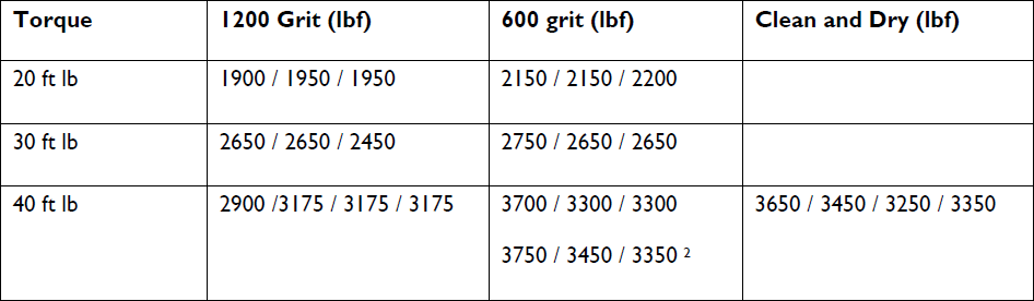

Additional Testing of Alternative Friction Surface

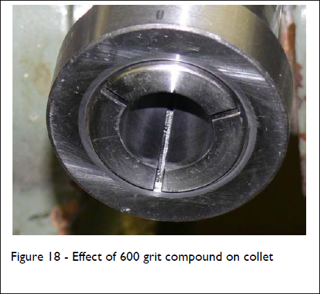

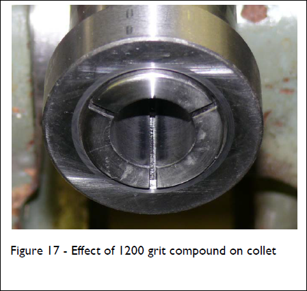

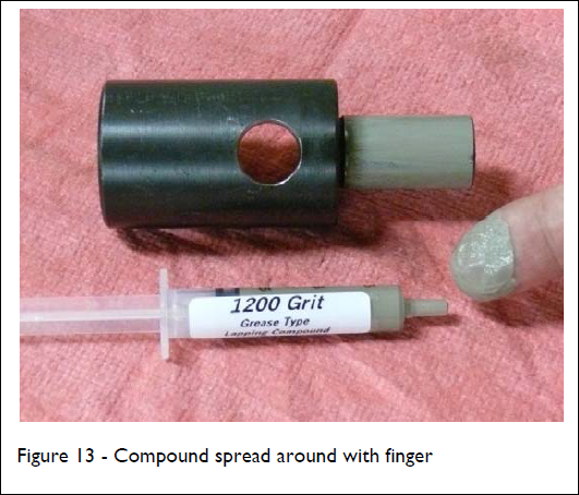

The initial round of testing included the use of oil based abrasive lapping compound as a way to protect against rust with the oil of the compound, while counteracting the lubricant with the abrasive. It’s clear from the tests that there is increased friction due to the abrasive, but the practice of putting an abrasive material in a precision ground collet is questionable. There should be no wear if the collet did not slip, but there remains risk that abrasive grit will migrate to the outside of the collet, where it slides against the spindle taper. Conservative use and proper procedures can mitigate the risk, but the issue remains. The question came up of just how fine a grit could remain effective for increasing friction. While any abrasive will remove
metal, in practice it becomes apparent that grit finer than 1000 is more of a polishing compound than a metal removal agent. If small amounts of very fine grit were to migrate from the inside of the collet to the outside of the collet, it would be unlikely to result in any significant change in spindle taper geometry. It would be more likely to polish the inside of the spindle and thereby reduce friction, which is what is desired between the collet and the spindle taper. This lead to the tests that compared 1200 grit to 600 grit lapping compound.
![](../__attachments/3795484674/image-20210518-143548.png?inst-v=f3bbd44f-67ba-4391-a327-348520a51a3c)
![](../__attachments/3795484674/image-20210518-143637.png?inst-v=f3bbd44f-67ba-4391-a327-348520a51a3c)

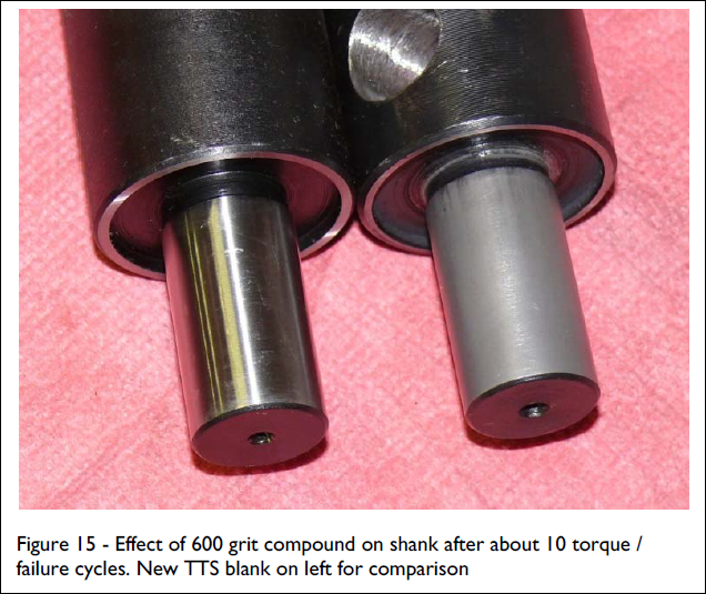

(2) 600 grit re-applied
The testing was done with the collet and drawbar from Test 2 with machined thrust surfaces. The abrasive paste was applied to the TTS shank only, and the 1200 grit was done first. For comparison, the 600 grit test was repeated with these same parts. The shank and collet were cleaned with lacquer thinner before applying the coarser grit. At 40 foot pounds of torque, we noticed that after the first test the force required to “pop” the collet decreased. This resulted in the 40 ft. lb. test being repeated with a fresh application of abrasive paste. With similar results, we concluded that the “pop” or failure of the grip broke down the abrasive grit, and is unlikely to be a problem unless it fails. Essentially, the majority of the large abrasive particles were probably broken with the instant of the first slip.
After the 600 grit test, we cleaned the shank and collet and retested Clean and Dry to see what, if any,
affect the abrasive had on the parts. As before, after the “pop”, results were reduced with each failure as it burnished the surface. Without the failure it does not appear that burnishing would occur.
Observations:
Use of 1200 grit lapping compound shows some reduction in gripping power relative to the 600 grit,
however the difference in gripping power is insignificant. The different in observable wear on the
parts is significant.
