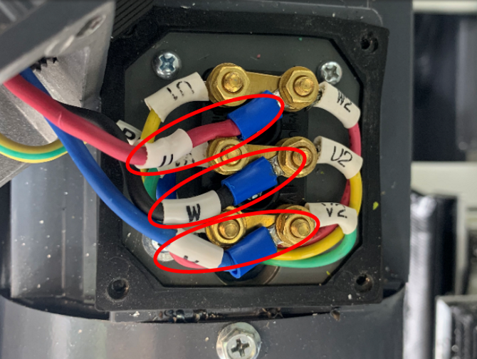

In the event that your RapidTurn motor in spinning in the improper direction, no need to worry. This is an easy fix!
  • Adjustable wrench
  • Phillips Screwdriver
Open up the RapidTurn Motor Junction Box
Swap the position of two of these wires: U, V, W
DO NOT MOVE U1, V1, W1, or U2, V2, W2!
