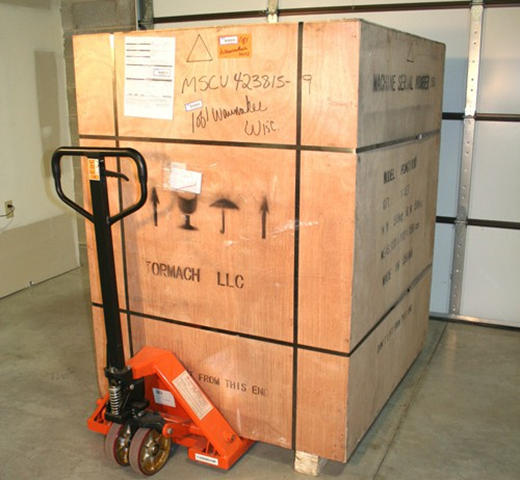

Moving the Crate
The PCNC mill is loaded on a standard pallet and can be off-loaded from a truck with a tailgate lift and moved (on smooth surfaces) using a hydraulic pallet jack to the installation location (see Figure 1).
Figure 1

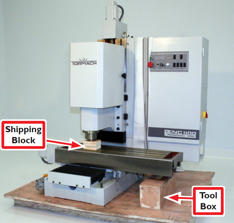

image-20241120-205243.png CAUTION! Sharp Objects: Be sure to wear gloves when uncrating mill. Failure to do so may result in serious injury.
  1. Use strap snips and a small pry bar to open and disassemble shipping crate. Remove top of crate first, followed by four sides. Figure 2 shows crate removed.
Figure 2
