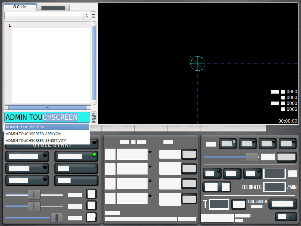

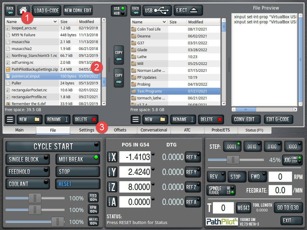

Touch Screen isn't Responding
Reseat the USB Cable (touch screen only)
  3. Press the Delete button.
  4. Exit out of Path Pilot and re-boot controller.
