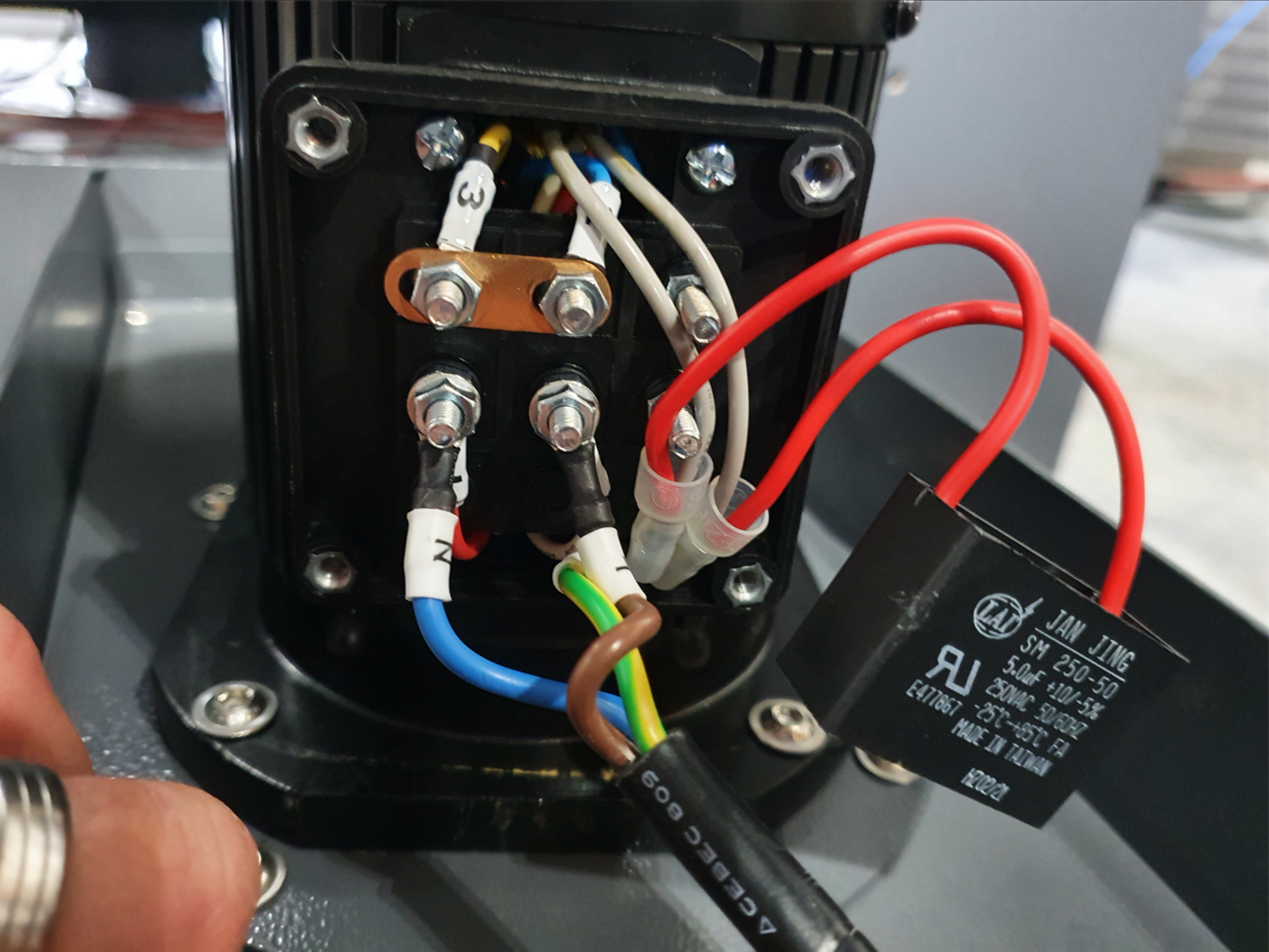

Reseat the coolant pump power cord
Inspect the coolant pump strapping

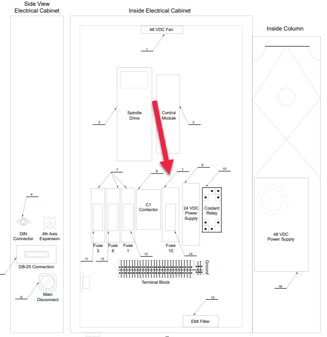

Inspect fuse F10
Reason: Fuse F10 is blown
  1. Power off the machine.
  2. Locate and remove the F10
    2. If the fuse measure 0-5 Ω, reinstall it.
440 Electrical Cabinet

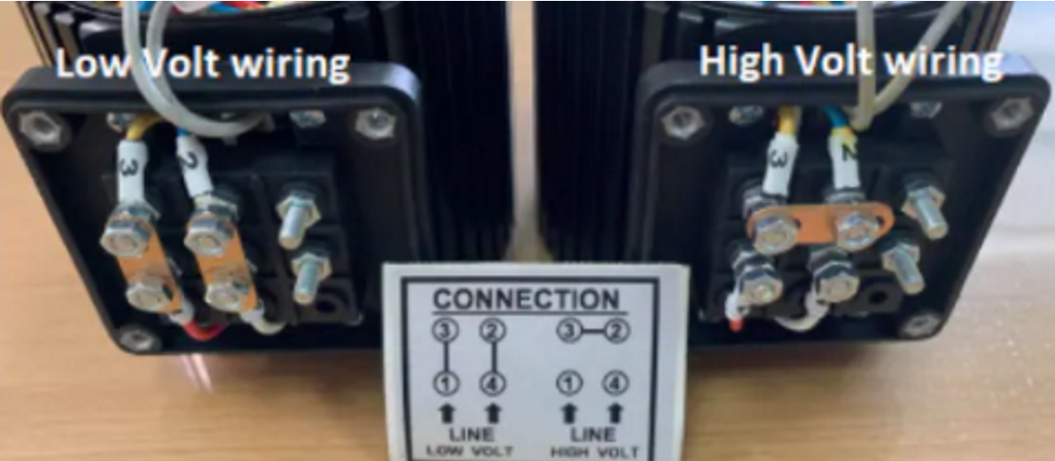

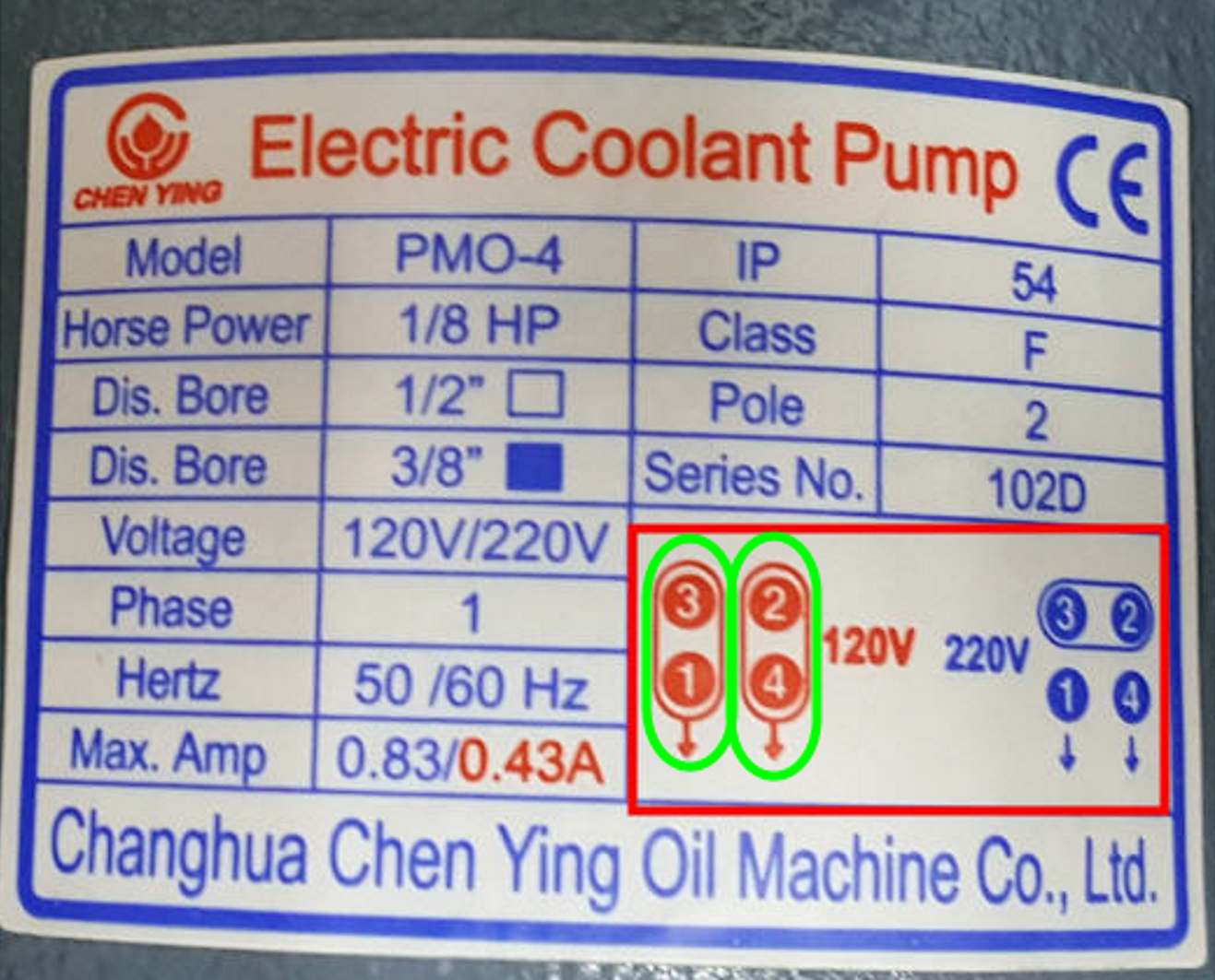

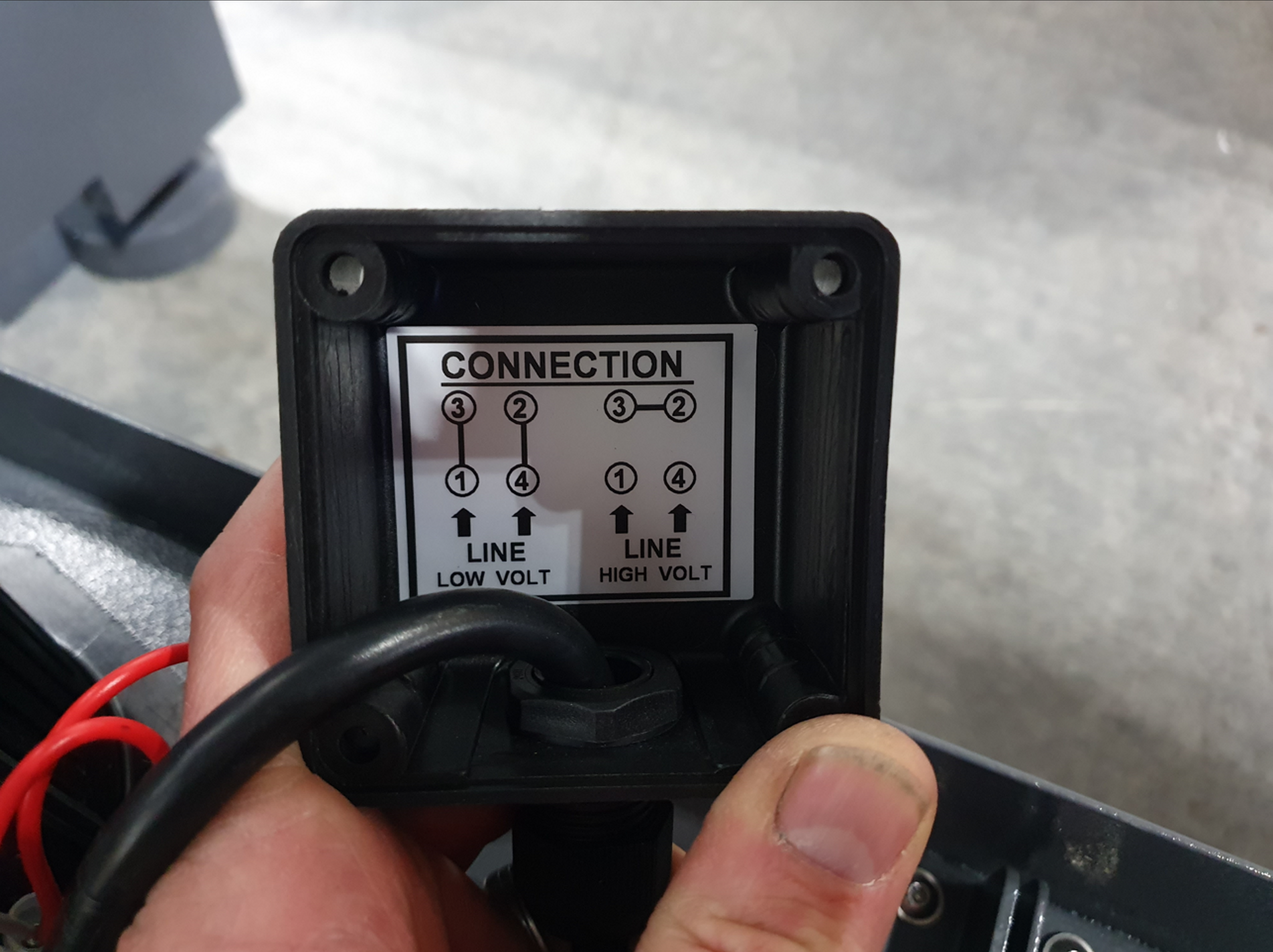

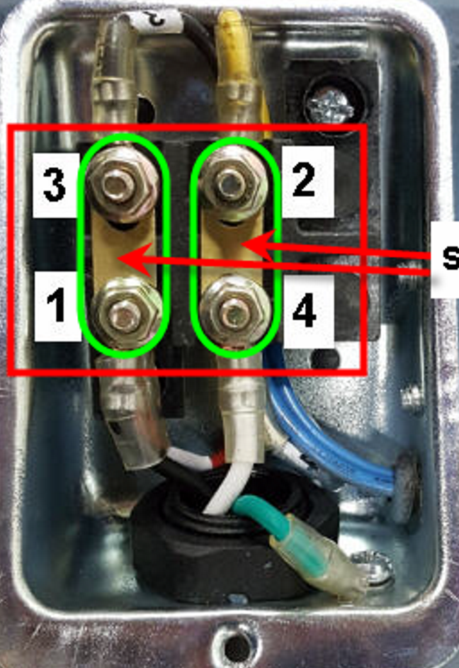

  1. Unplug the coolant pump power cord from the machine and examine it for damage.
  2. Test the coolant pump by:
    1. If possible, plug it into a known good outlet to see if it turns on.
    2. Use a digital multimeter to verify the motor’s resistances from winding-to-winding and winding-to-ground. If any winding-to-winding resistance measurement is a short (near zero resistance), an open circuit, or if the winding-to-ground resistance is a short, the coolant pump must be replaced.
