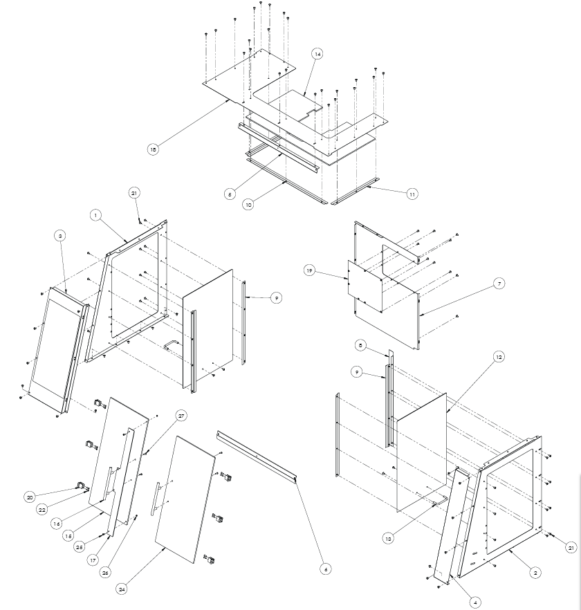

Enclosure Exploded View
Enclosure Parts List
