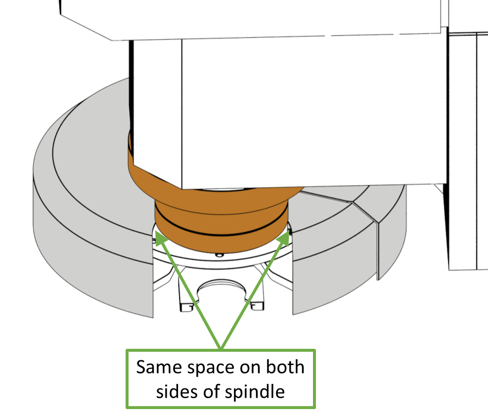

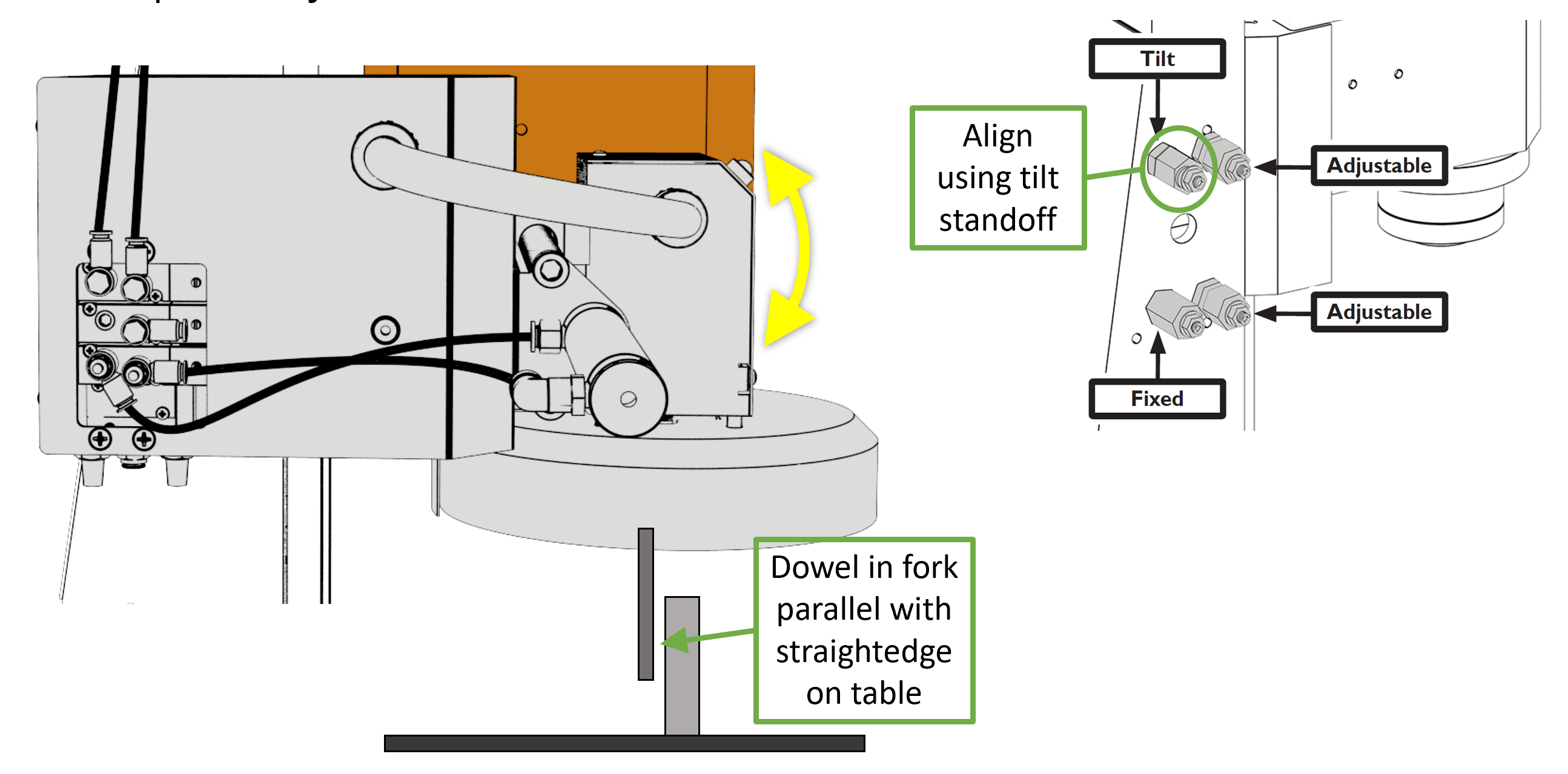

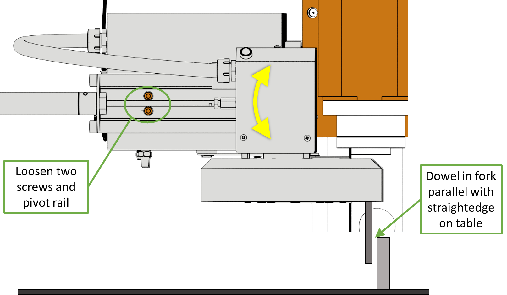

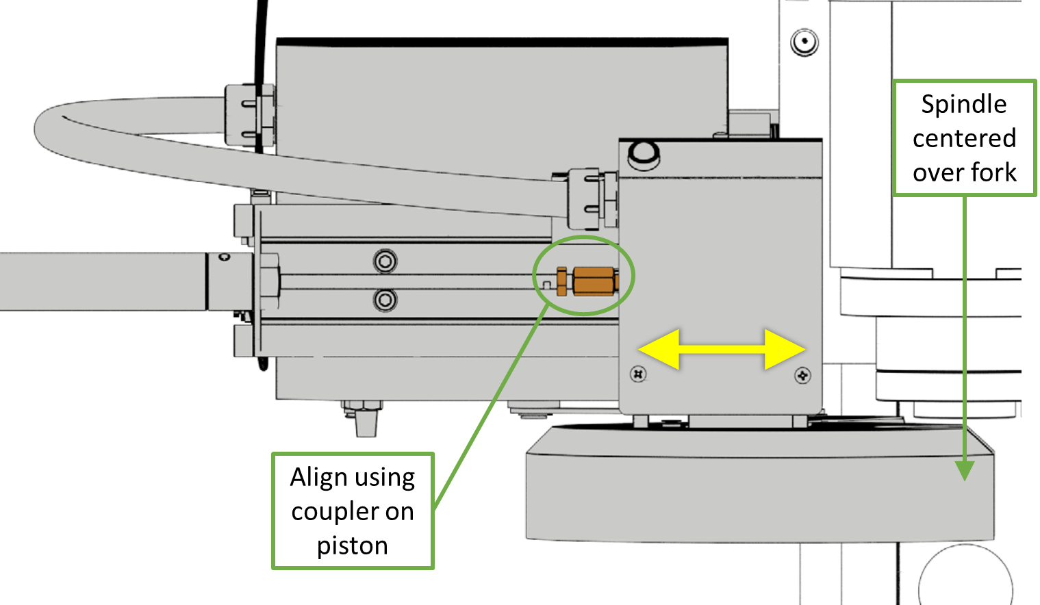

Align the ATC with the Spindle Nose.
Align the ATC in the X direction.

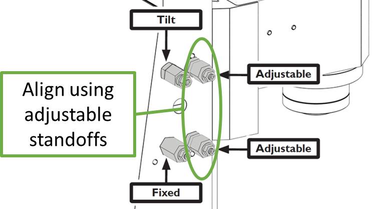

Adjust ATC Tilt in X Axis
Adjust ATC Tilt in Y Axis

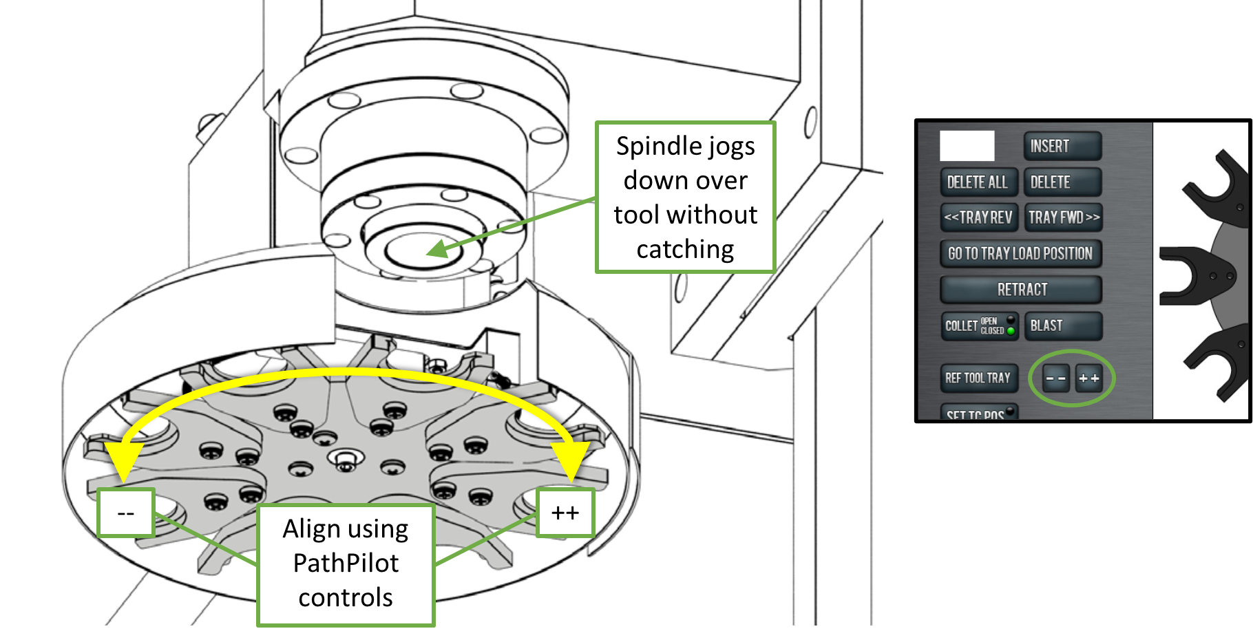

Adjust Tray Rotation

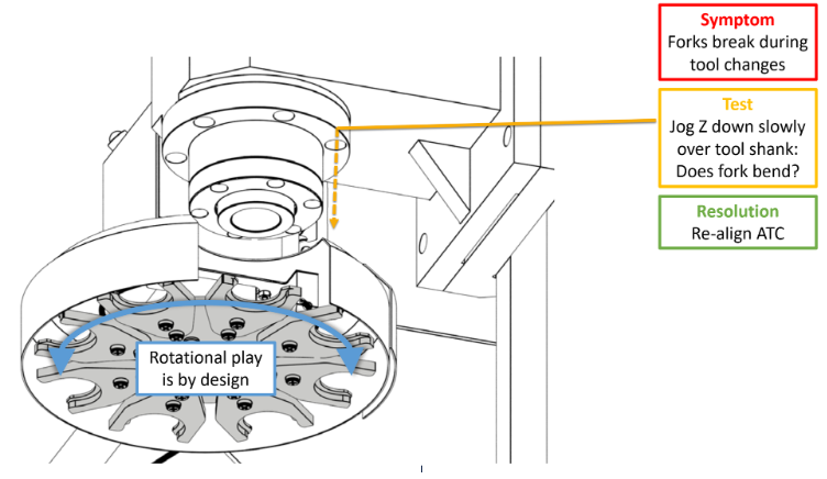

Forks Breaking During Tool Changes
Reason: Misalignment

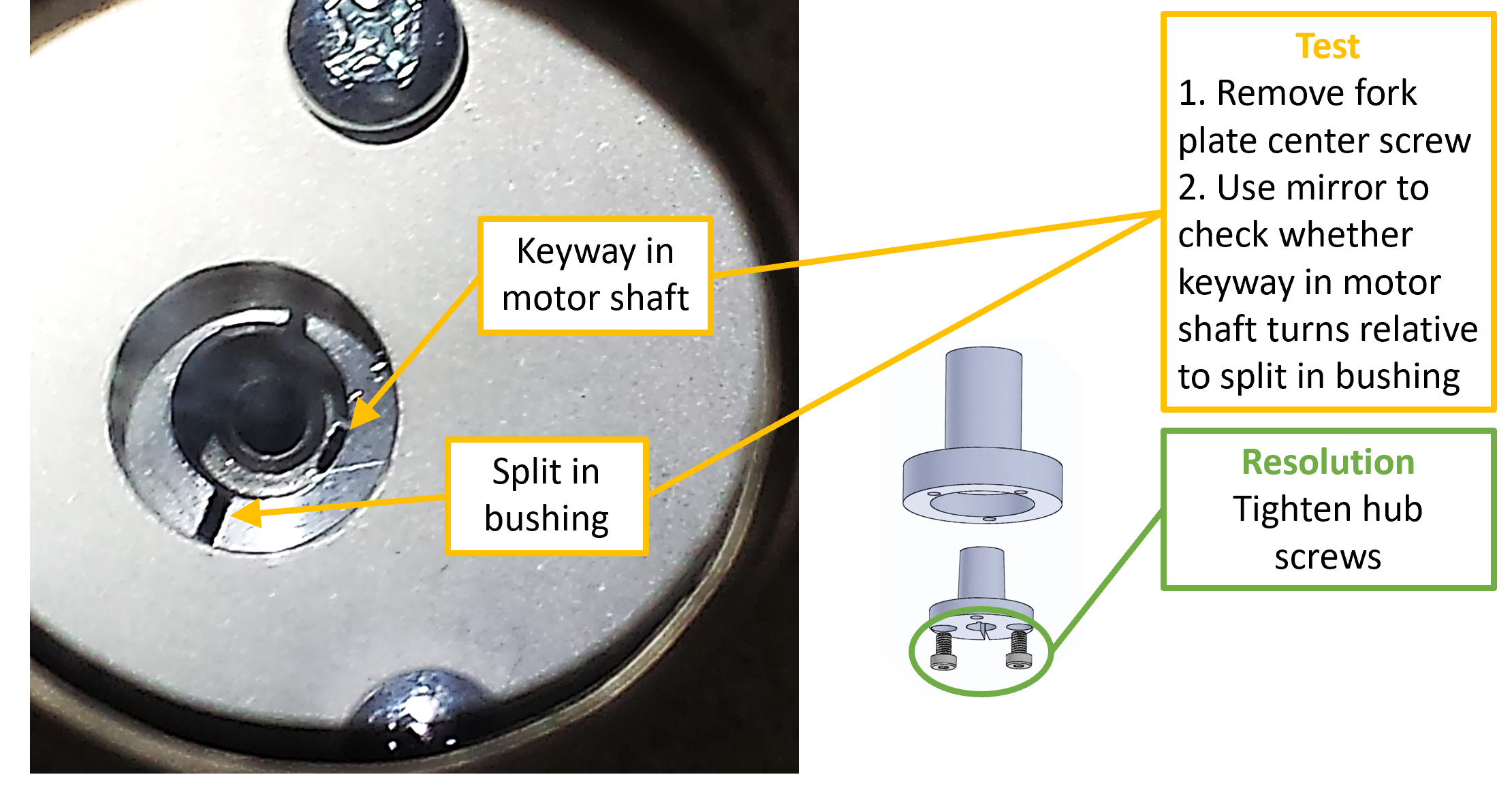

Forks Breaking After Several Successful Tool Changes
Reason: Loose hub

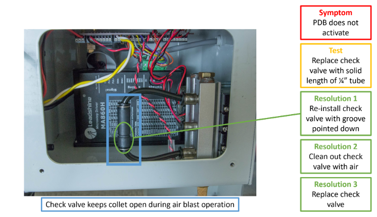

Power Draw Bar Does Not Activate
Reason: Check valve

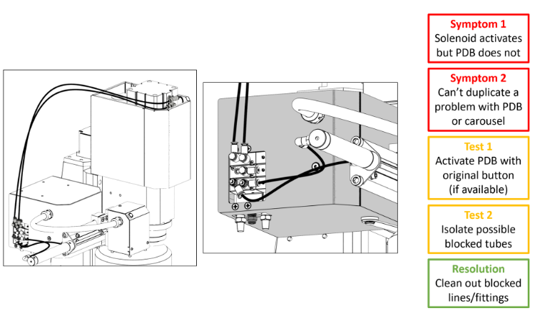

Solenoid Activates but PDB Does Not
Reason: Blocked air lines

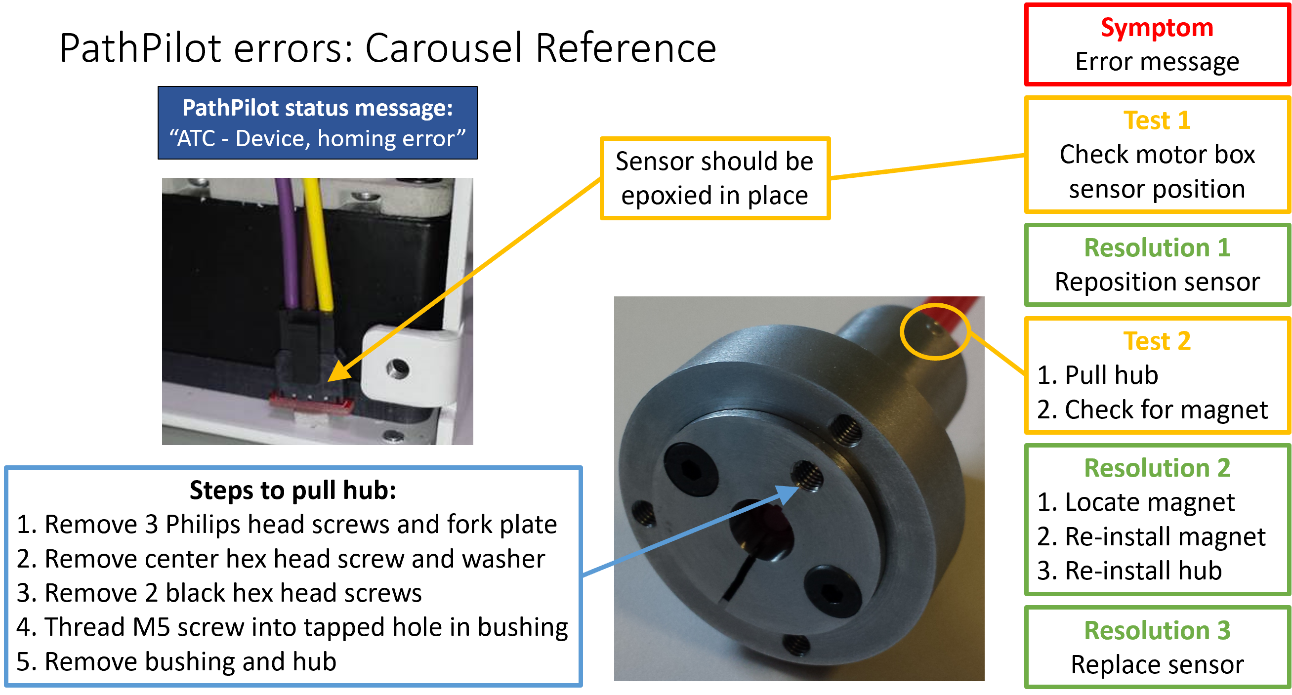

ATC Fails to Reference Tray
Reason: Misaligned sensor or magnet. Bad sensor.

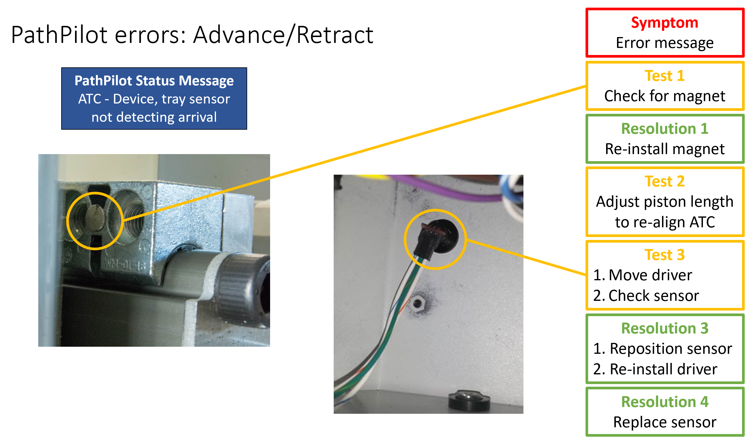

ATC Tray Sensor Not Detecting Arrival
Reason: Misaligned magnet/sensor. Bad sensor.
