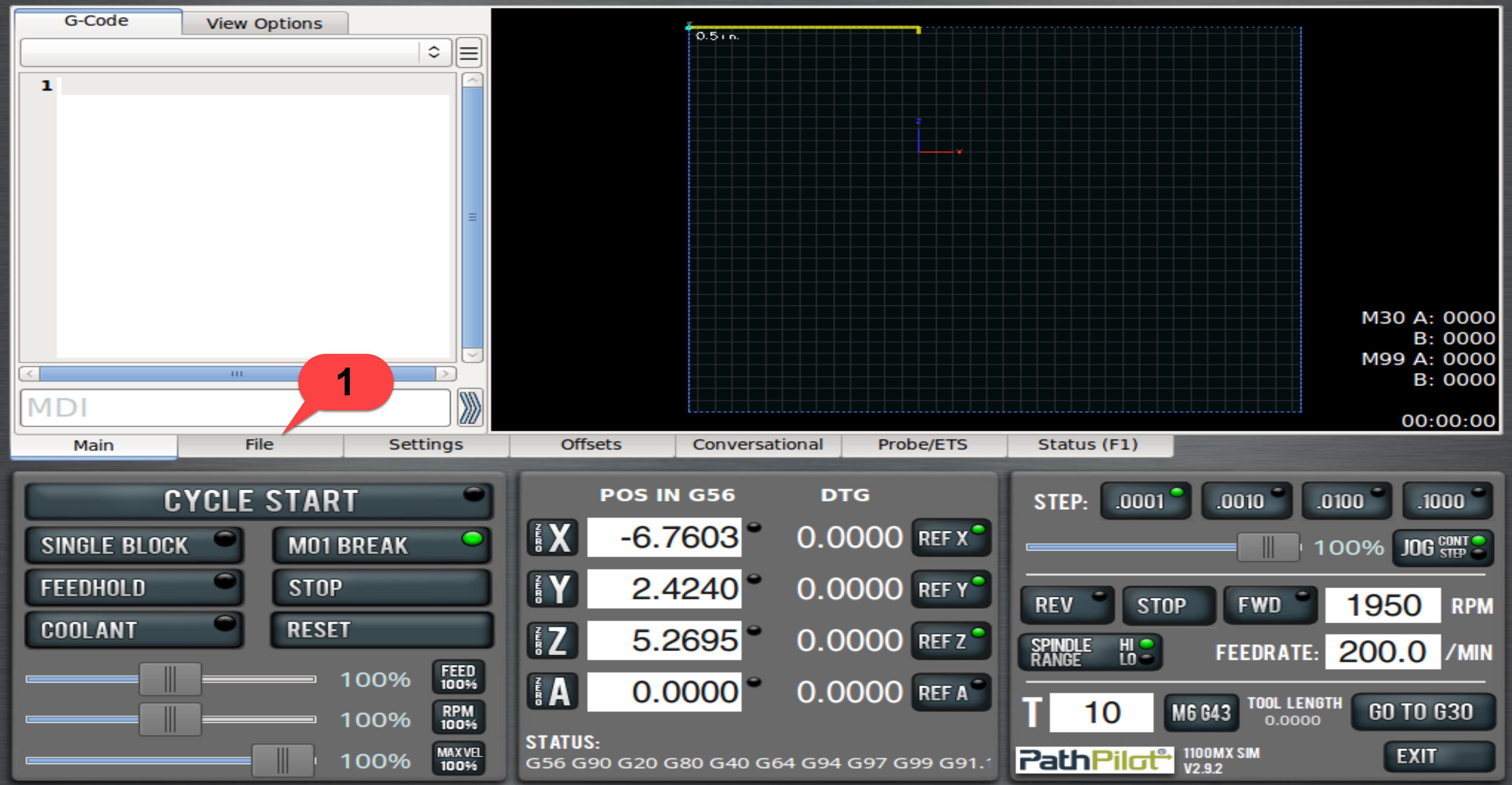

Step 1

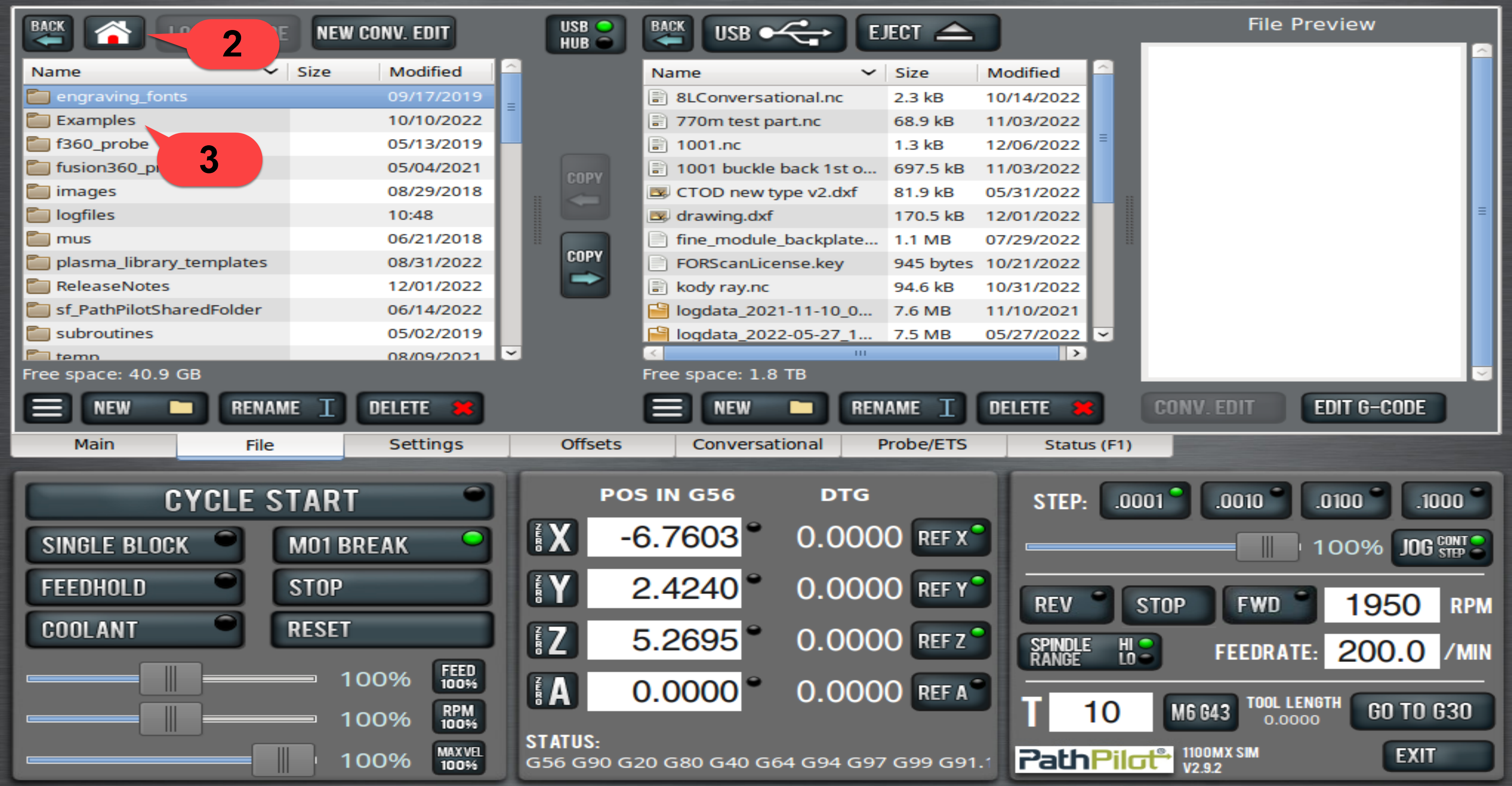

Click the File tab in PathPilot.
Step 2
Click the Home button to come back to the main file directory. Then, locate the Examples folder, and double click.

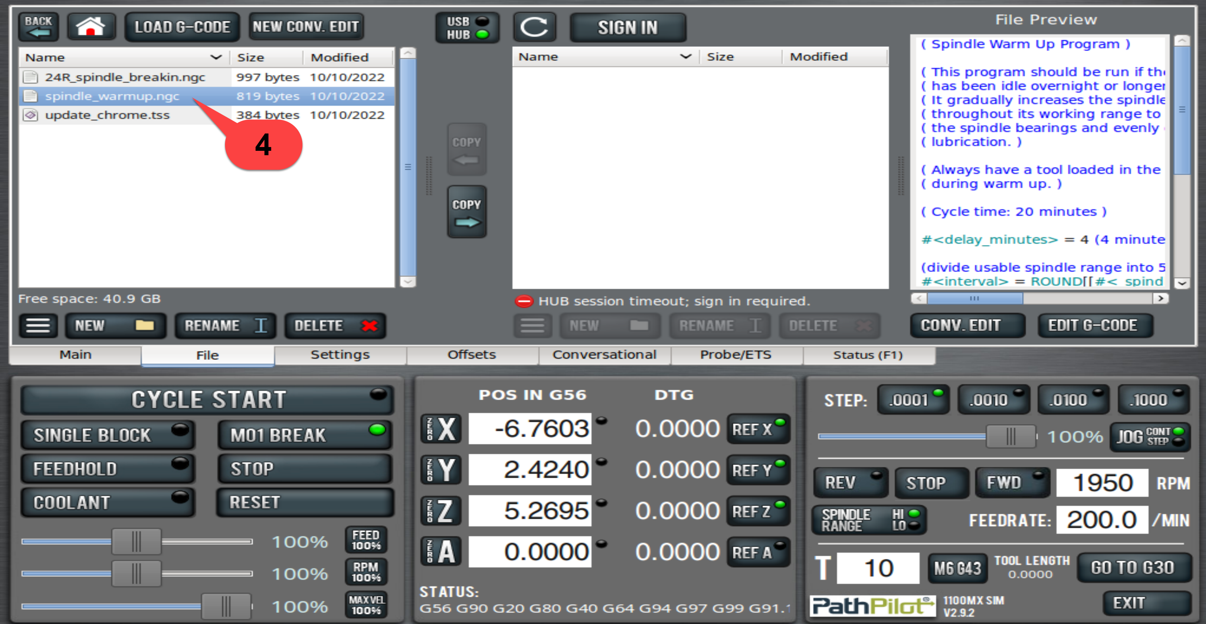

Step 3
Locate the spindle_warmup.ngc file, and load the program. This warm up program will run for twenty minutes. Please see the embedded program notes before running.
