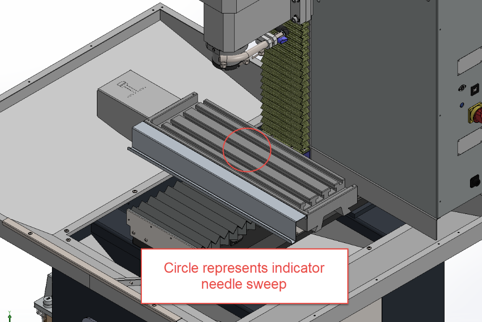

Mount the dial test indicator to the spindle such that rotating the spindle by hand rotates the indicator. Move the table to have it’s center in the Y axis positioned under the spindle centerline. Adjust the magnetic base of indicator rod such that when spun by hand the indicator needle reaches both edges of the table in the Y axis (sweeping the greatest circle possible).
Record the indicator readings at each of the positive and negative most points of the X and Y axis. Different indicators will reach either positive high or positive low, but positive high will be most common.

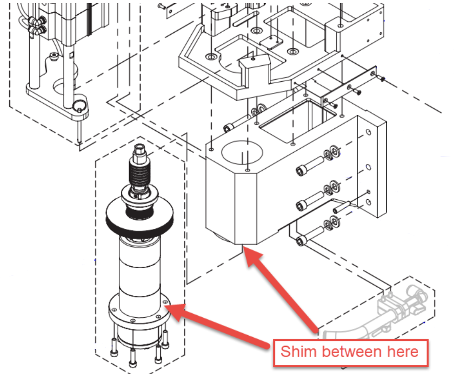

Shimming
DO NOT READ THE INDICATOR OFF OF A FIXTURE PLATE OR ANY COMPONENT EXCEPT THE MACHINE TABLE
To insert the shim, remove the indicator from the spindle, loosen the spindle belt tension, then loosen the spindle flange bolts, but do not remove them. Ensure that the flange drops enough to insert a shim of the needed thickness. If it does not drop, tap the drawbar or spindle pulley with a dead blow hammer, until it drops.
After inserting the shim in the desired location, tighten the flange bolts, then take another reading with the indicator. Repeat the procedure until the indicator needle shows less than .0005” movement in at least a 6” circle.
