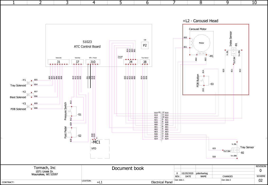

Transfer the Wires
You now have access to the ATC control board. In this section, you'll transfer most of the wires to new connectors before removing the control board.
Find the 5-pin connector provided in this kit (connector J10).
Holding the connector in the orientation shown, transfer wires 201 (red), 200 (black), 818 (yellow) and 819 (white) from the old control board to the new connector as shown in the following image.
Find the 4-pin connector provided in this kit (connector J7).
Transfer wires 813 (red or blue) and 812 (black) to the new connector, as shown in the following image. If you have a foot pedal installed on your mill, transfer wires 829 and 830 from the PEDL connector on your control board (not shown).
Full wire order for the 4-pin J7 connector (left to right): 813, 812, 829, 830.
Find the 8-pin connector provided in this kit (connector J1).
Transfer wires 805 (red), 804 (black), 807 (red), 806 (black), 809 (red), 808 (black) to the new connector as shown in the following image (starting on the left).
At this point, the remaining wires on the ATC control board (from left to right) are the tray-in sensor, the carousel index sensor, and the drawbar release button (as shown in the following image).

Install the New Control Board
NOTICE! You must take care to keep the control board clean. Before you install the new control board, make sure that the ATC enclosure is free of chips or debris. The presence of chips could cause damage to the control board.
Remove the old control board from the ATC.
If you removed the tray-in sensor to add extensions, re-install it now.
Slide the terminal block assembly into the ATC and secure it using the studs that were previously used for the stepper driver.
Install the new control board onto the mounting posts.
Plug in the USB control cable.
Plug in the two black molex connectors on the control board.
Plug in the 4-, 5-, and 8-pin green connectors.
Connect wires 815 (orange), 814 (white), 822 (purple), 821 (yellow), 820 (brown) to the new terminal block provided in this kit.
NOTE: The wires that you're installing go from right to left, and they don't match the colors of the wires on the other side of the terminal block.
Don't mix up the order of the purple, yellow, and brown wires. If they're out of order, the tray indexing sensor won't function.
Remove the four stepper motor wires from the green connector you unplugged from the stepper driver. You can discard this connector — the wires will be connected to the new terminal block.
Place the four stepper motor wires into the new terminal block. The order, from right to left, is as follows: 800 (black), 801 (green), 802 (blue), 803 (red).
Connect the three wires from the tray in sensor to the last three terminal blocks. The order, from right to left, is: 826 (red), 825 (blue), 824 (black).
