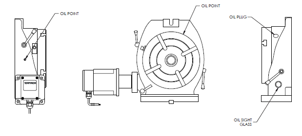

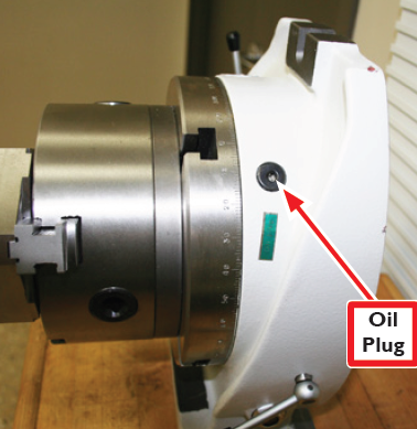

It’s important to note that, after you’ve installed the rotary table and 4th axis driver, you must complete the following procedures before initial use:

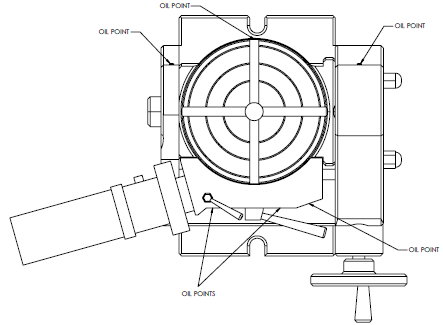

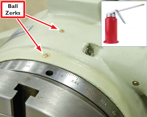

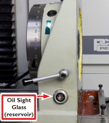

  • Fill the rotary table with oil. For information, see the Lubrication section later in this document.
IMPORTANT! Operating without lubrication voids warranty.

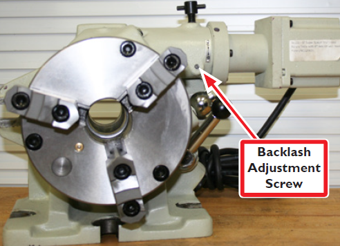

  • Adjust the backlash. For information, see the Adjusting Backlash section later in this document.

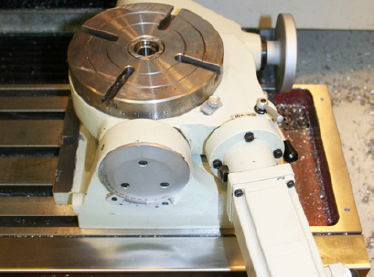

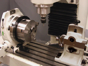

Mounting Vertically (typical A-axis)
  1. Position the 4th Axis on the left side of table (see Figure 1).
Figure 1
  1. Use Toe Clamps to secure.
NOTE: The Tilting and Super Spacer tables are typically positioned on the right-hand side of table.
Mounting Horizontally (typical C-axis)
  1. Position the 4th Axis on the right side of the table (see Figure 2).
Figure 2
  1. Use Toe Clamps (included) to secure.

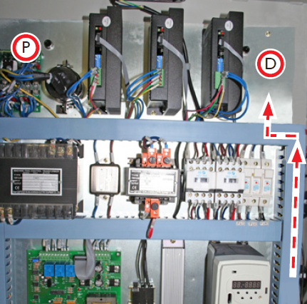

  1. Identify location D in electrical cabinet as shown in Figure 3 to install 4th axis drive.
Figure 3
  1. Loosely attach one M4 screw in the bottom of the two tapped holes; rest drive on screw.
  2. Attach one M4 screw in the remaining tapped hole; tighten both M4 screws securely.

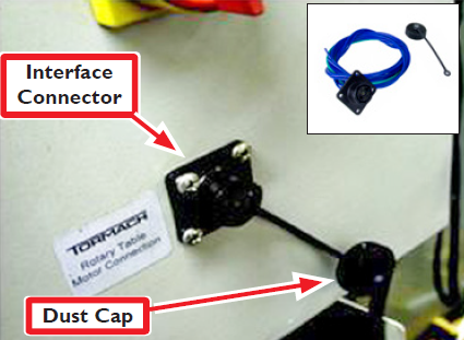

Mounting Interface Connector
  1. Locate the blanking plate (if equipped) below the main disconnect switch, to the right of the electrical cabinet. Remove and set aside four screws.
NOTE: Use larger of two blanking plates for 4th Axis.
  1. Thread the Interface Connector wires through the side of the electrical cabinet (see Figure 4 and inset); secure using four screws set aside in Step 1.
Figure 4
NOTE: Interface Connector’s Dust Cap is attached on bottom right screw (see Figure 4 and inset).

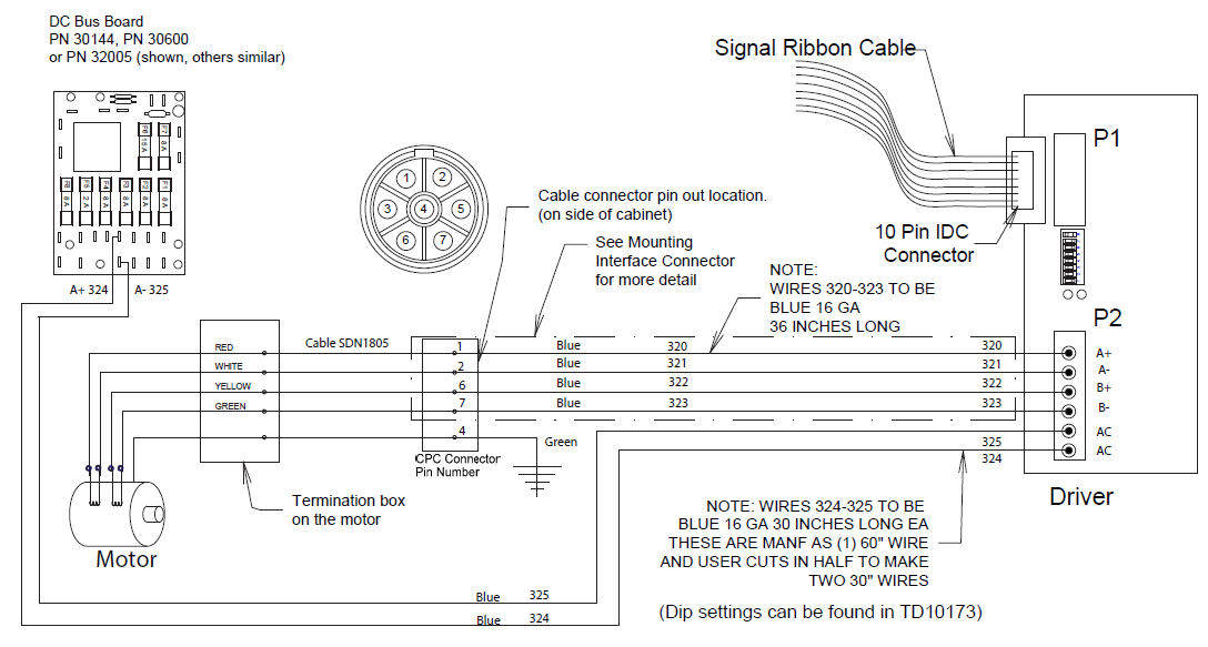

  2. Route wires 320-323 from Interface Connector through wire troughs and to location D as shown in Figure 3.

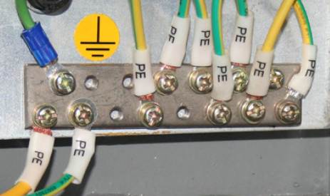

  3. Older mills are equipped with a Ground Bar (see Figure 5), while newer mills have a green Ground Terminal Block (see Figure 6). Identify the ground connection specific to your mill and route green ground wire.
Figure 5: Ground Bar
Figure 6: Ground Terminal Block
  1. Based on ground connection identified in Step 3, either use pre-mounted ferrule for Ground Terminal Block connection (see Figure 6) or clip off Ferrule, strip wire back 1/4” and crimp on ring connector for Ground Bar connection (see Figure 5).

  1. Make ground wire connection as detailed below:
Ground Bar
  1. Route ground wire via lower wire trough and connect to any Ground Bar terminal screw (see Figure 5)

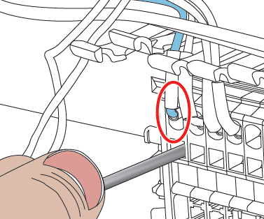

Terminal Block
  1. Route ground wire via lower wire trough.
  2. Slowly insert end of a small, flat-head screwdriver straight into any slot in green section of Ground Terminal Block (see Figure 7).
    Important! Do not move screwdriver up or down inside terminal block. Failure to do so could result in terminal block damage.
  3. Once resistance is felt, insert wire into terminal block (see Figure 8); slowly remove screwdriver.

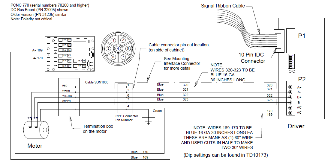

Power Wire Connections
  1. Identify the blue power wire (included) with two 1/4” crimp connector ends; cut it in half to make two power wires that are required for installation.
  2. Using a wire stripper, strip off 1/4” of insulation on cut end of blue power wire to expose bare metal.
  3. Add wire labels (included) to stripped ends of blue power wire. For more information, refer to PCNC 1100 Wiring Overview and PCNC 770 Wiring Overview sections later in this document.
NOTE: Wire connections for PCNC 1100 and PCNC 770 varies. See related section for information.
PCNC 1100
PCNC Mill
Serial Number
1100 Series I
1-1325
1100 Series II
1326-1999

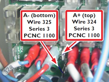

1100 Series 3
2000 and up

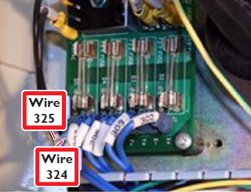

  1. Plug crimp connector end of wire 325 to connector marked –A on the DC Bus Board (at location P in Figure 3); plug crimp connector end of wire 324 to the connector marked +A (see Figure 9 and Figure 10). Refer to PCNC 1100 Wiring Overview section later in this document for wire labeling details.
Figure 9: PCNC 1100 Series 1 & Series 2
Figure 10: PCNC 1100 Series 3
IMPORTANT! Wire identification is critical; for more information, refer to PCNC 1100 Power Wiring Overview section later in this document.
  1. Route loose end of power wire to drive (location D in Figure 3).
PCNC 770
PCNC Mill
Serial Number
770 (early models)
70000-70199
770 Series 3
70200 and up

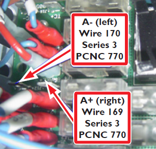

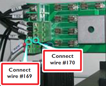

  1. Plug crimp connector end of wire 170 to connector marked –A on the DC Bus Board (at location P in Figure 3); plug crimp connector end of wire 169 to the connector marked +A (see Figure 11 and Figure 12). Refer to PCNC 770 Wiring Overview section later in this document for wire labeling details.
Figure 11: PCNC 770 Series 1 (early models)
Figure 12: PCNC 770 Series 3
IMPORTANT! Wire identification is critical; for more information, refer to PCNC 770 Power Wiring Overview section later in this document.
  1. Route loose end of power wire to drive (at location D in Figure 3).

  1. In the electrical cabinet, locate the loose Ribbon Cable under the wire trough cover (in line with ribbon cables to existing drives).
  2. Plug Ribbon Cable into IDC Connector on drive (see Figure 13).
Figure 13
  1. Locate Connector Plug on drive; this is for power (see Figure 13).
  2. Install power and motor wires in Connector Plug with wire numbers visible; refer to Tormach technical document TD10173 (included) for wire connection details.
IMPORTANT! Wire identification is critical; for more information, refer to PCNC 1100 Power Wiring Overview and PCNC 770 Power Wiring Overview sections earlier in this document.
  1. Match DIP switch (see Figure 13) settings on drive as detailed in technical document TD10173 (included).

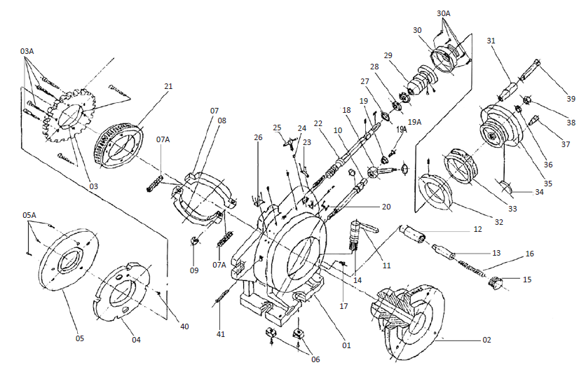

Components of the Standard, Super Spacer, and Tilting tables are shown in Figure 14, Figure 15, and Figure 16.
Figure 14: Standard Table
Figure 15: Super Spacer Table
Figure 16: Tilting Table

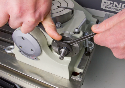

IMPORTANT! Backlash should be adjusted prior to first use as detailed later in this document.
IMPORTANT! This product ships without oil and must be filled before being put into service. Operating this product without lubrication voids warranty. Refer to the Maintenance section for detailed instructions on how to lubricate Standard, Tilting, and Super Spacer rotary tables.

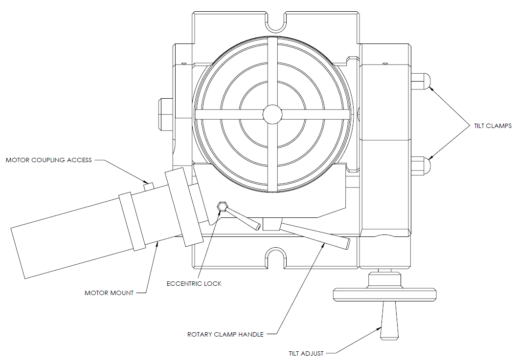

Rotary Clamps: To keep the table from rotating during heavy milling operations, tighten the clamps with the clamp handles. The clamps should be loosened during motorized rotation to allow free rotation. If the clamps are locked during a move, correct position will likely be lost.
Tilt Clamps: The Tilting Table has two Tilt Clamps that are tightened to lock the tilt position; tighten prior to machining (see Figure 16).
Engaging and Disengaging Worm Drive: On Standard and Tilting tables, to disengage the worm gear so the table can be turned by hand, loosen the Eccentric Lock (see Figure 14), rotate the eccentric by turning the Motor Mount as far as it will rotate clockwise, and re-tighten the Eccentric Lock. To re-engage the worm, loosen the Eccentric Lock, rotate the motor mount as far as it will rotate counterclockwise, and tighten the Eccentric Lock.
Rotate the table slightly, if necessary, by hand so the worm gear can engage the ring gear. If the worm is not completely engaged, the table will exhibit excessive backlash.
On a Super Spacer Table, rotate the motor mount counterclockwise to disengage the ring gear and clockwise to engage it; tighten the Eccentric Lock.
Adjustable Reference Mark: (see Figure 17) Used to read angles directly off the table, the clamp holding it in place can be loosened to allow the pointer to be moved to an exact degree mark.

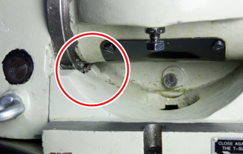

Used to align the angle of the Tilting Table from horizontal to vertical (see Figure 18).
Figure 18

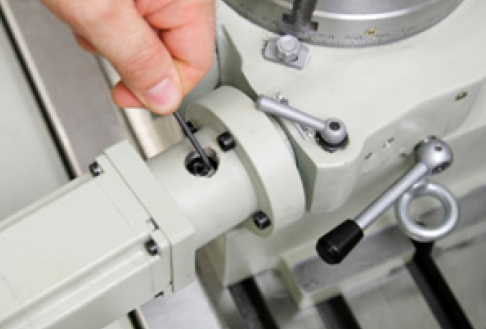

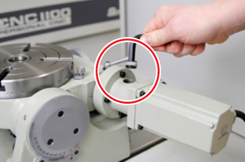

Locking the Eccentric
Power is transmitted from the axis motor to the rotary table by worm gear at the end of the drive shaft. Use the Eccentric Lock (shown in Figure 14, Figure 15, and Figure 16) to stop the eccentric sleeve from rotating. This must be done before the worm drive is engaged to prevent the drive from disengaging during use.

Lubrication
IMPORTANT! Rotary tables ship without oil and must be filled before initial use. Operating this product without lubrication voids warranty.

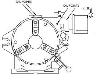

Lubrication-related locations for the Standard Rotary Table, Tilting Rotary Table, and Super Spacer Table are shown in Figure 20, Figure 21, and Figure 22. The standard rotary tables have an oil reservoir and Oil Points, better known as Ball Zerks (spring-loaded oil fittings), that must be filled with AGMA 2 gear oil or SAE 30 weight motor oil before first operation.
Figure 20: Standard Table
Figure 21: Tilting Table
Figure 22: Super Spacer Table
NOTE: Do not use way oil on 4th Axis or any rotary products.
Ball Zerks (all tables)
Using a trigger-style oil can (included), fill the Ball Zerk oil fittings (see Figure 23 and inset). Depress the zerk’s spring-loaded ball with the tip of oil can and pump until there is back pressure.
Figure 23
The oil reservoir (Standard table) is filled via the Oil Plug (see Figure 20 and Figure 24).
Figure 24
The oil reservoir should be filled with the table oriented (horizontal/ vertical) as it will be used. With the table in the horizontal position, fill the reservoir halfway up the Oil Sight Glass (see Figure 25). With the table in the vertical position fill the reservoir until oil just begins to leak out at the bottom of the table. If overfilled, the reservoir will slowly leak oil until it reaches the proper level.
Figure 25
NOTE: When the oil reservoir is filled with the rotary table in the horizontal position, and then the rotary table is shifted to a vertical position, oil will leak out.
Place the rotary table in a pan or on a stack of newspaper until the excess oil has drained out (this many take a day or two). The rotary table can be used while oil is leaking out. Tilting Tables have six Oil Points, while Super Spacer tables have four. Neither table has an oil reservoir like the Standard Table.
IMPORTANT: Because Tilting and Super Spacer tables do not have an oil reservoir; frequent oiling is required.
Adjusting Backlash
CAUTION! Pre-mature Rotary Table Wear: Be sure to adhere to backlash adjustment procedures. Failure to do so could result in machine damage (pre-mature wear on rotary table’s ring and worm gear).
Backlash is an important element in managing overall accuracy. The rotary table has a number of internal sliding surfaces that depend on a hydrodynamic oil film for low friction and long life. Similar to the adjustments of the lead screw nut and gibs (on mill or lathe), adjustment of clearances between internal moving parts seeks common ground between extreme precision and long life.
If backlash is adjusted to zero, the worm screw and other parts are subject to excessive wear, friction, and consequently, table stalling. As the screw turns, the oil shears off at the gear interface – with no film to protect against metal-to-metal wear. Correctly adjusted backlash provides both long life and a minimum of backlash.
  1. Backlash is adjusted by positioning of the Backlash Adjustment Screw. For the Standard Table, see Figure 26; for the Tilting Table, see Figure 27; and for the Super Spacer Table, see Figure 28.
Figure 26: Standard Table
Figure 27: Tilting Table
Figure 28: Super Spacer Table
  1. The Backlash Adjustment Screw is accessed by removing the protective cover screw on top of it, or loosen a jam nut.
  2. Loosen Backlash Adjustment Screw six turns counterclockwise.
  3. Disengage Eccentric Lock and clamp handles.
  4. Engage motor/worm gear by grasping it and rotating it fully (counterclockwise on Standard and Tilting tables; clockwise on Super Spacer Table). Verify the table does not turn; the table will not turn if the motor is engaged.
  5. With counterclockwise pressure on the motor using one hand (clockwise on Super Spacer table), slowly tighten the set screw until resistance is felt to the pressure.
NOTE: Pay attention as this resistance is subtle.
  1. At this point, the set screw is just against the worm drive. Tighten the set screw approximately 1/4 turn, which will rotate motor slightly. This step creates a gap between table and worm gear for an oil film.
Alternatively, to set backlash by the numbers, adjust for a minimum backlash of 30 arc-seconds. Measured at the outer circumference of an 8” diameter circle with a dial indicator, 30 arc-seconds will be 0.0006” of lost motion.
  • Setting backlash to 60 arc-seconds will sustain a thicker oil film, yielding lower friction and longer life. This would be 0.0012” on the outside of an 8” circle.
  • Setting backlash greater than 90 arc-seconds (1.5 arc-minutes) is not recommended; it will do nothing to improve the life of the mechanism and can result in chatter during machining operations.
  1. Replace cover screws.

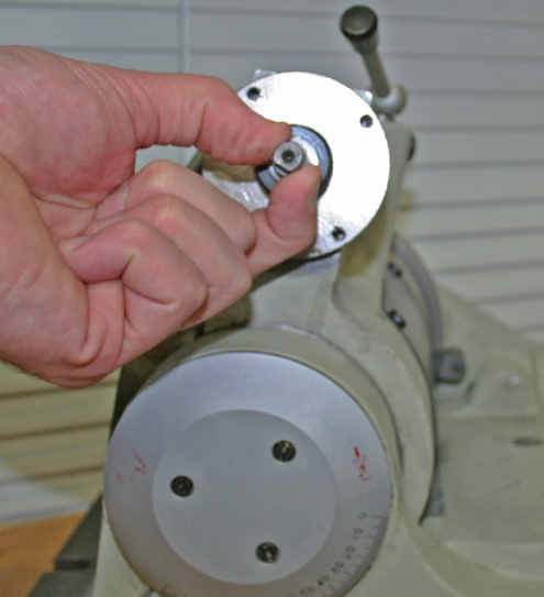

Inspect or Tighten Motor Coupling
In the rare instance where a motor coupling is loose or cracked, this will cause the table to slip relative to motor rotation and subsequently lose position.
  1. Remove the set screw on the motor mount (see Figure 29).
Figure 29
  1. Jog the motor until the first of two coupling screws inside motor mount can be accessed.
  2. Tighten screws on coupling.

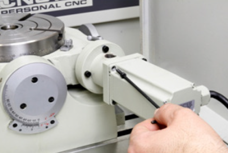

Motor Coupling Removal
  1. If removal is required, loosen the socket head cap screw and the set screw on the motor coupling; do not remove (see Figure 30).
Figure 30
  1. Detach the motor from the motor mount by removing four mounting screws (see Figure 31). Remove the motor with the coupling still attached (see Figure 32).
Figure 31
Figure 32
  1. With motor out, inspect the coupling and tighten the remaining coupling screws on motor shaft.
  2. If coupling is broken, remove motor coupling and replace with 6” rotary table coupling (PN 31840) or 8” rotary table coupling (PN 30715).

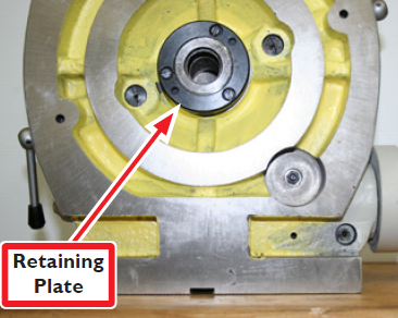

Worm Axial Adjustment
To adjust for wear in the worm gear, the lock nut must be adjusted. Location of the lock nut is shown in the exploded views later in this document.
  1. Follow the steps in the Inspecting/Removing Motor Mount and Coupling section earlier in this document to remove motor and coupling.
  2. Apply a dab of grease to the back side of the spacer. Location of the spacer is shown in the exploded views later in this document.
  3. Using two spanner wrenches (PN 30485), tighten (or loosen) the lock nuts (see Figure 33). Adjust the spacer nut (PN 35557) so there is no axial play when turned by hand (see Figure 34) in the worm shaft and the shaft moves freely; Do not overtighten the locknut.
Figure 33
Figure 34
Table Adjustment
On the Standard, Tilting, and Super Spacer tables, test for correct axial adjustment by disengaging the worm and rotating the table by hand; slight drag should be felt. If not, loosen the three screws in the Retaining Plate (see Figure 35) two turns with a flathead screwdriver. Next, tighten or loosen Retaining Plate with an Adjustable Pin Spanner Wrench (PN 31118). Rotate the plate clockwise to increase drag and counterclockwise to decrease drag. Location of the aforementioned parts are shown in exploded views later in this document.
Figure 35

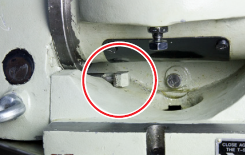

Engaging Locking Lugs on Tilting Table
The Tilting Table has two locking lugs. When intentionally or inadvertently moved out of position, the table will not tilt within the full range of motion.
In particular, the more interior locking lug is difficult to realign/fit with the recessed grove. To manually align this lug, manually crank the handle and move the table to a position that allows access to the displaced part.
Using fingers or a small tool, move the locking lug back into place. In its correct orientation, only the cap of the lug will be visible (see Figure 36 and Figure 37).
Figure 36: Lug In
Figure 37: Lug Out

A blown fuse on the DC bus board
Low
Inspect fuse
A blown fuse is usually the result of a bad drive. If a fuse is replaced and it immediately blows, suspect a bad drive or bad wiring to the drive.

Remove the motor leads from the connector plug on the drive. Measure the resistance of motor windings and compare to values in the table below. If the resistance is out of range, check wiring carefully. If the wiring is good and the resistance readings are out of range, the motor is defective.
A-axis
From
(Black Probe)
To
(Red Probe)
Resistance Ω
320
321
322
323
0.5-2.0 Ω
>1 MΩ
>1 MΩ
322
323
321
0.5-2.0Ω
>1 MΩ
All Wires Above
Ground Bar
>1 MΩ

Motor Wiring
Medium
Check motor wiring
Set motor wiring per Electrical Installation section. Reversing the leads on either coil will change motor direction.

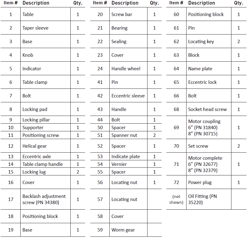

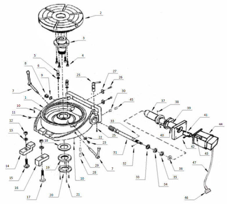

Parts List
Standard Rotary Table (exploded view)
Standard Rotary Table Parts List
Tilting Rotary Table (exploded view)
Tilting Rotary Table Parts List
Super Spacer Rotary Table (exploded view)
Super Spacer Rotary Table Parts List
Integrating with Custom System
The Motor, Cable, Plug, and Pinout are shown in Figure 38. Motor wiring is shown in the corresponding Motor Wiring Chart below.
Figure 38
  • The cable plug is: AMP CPC series 211400-1
  • The mating receptacle is: AMP CPC series 211398-1
Motor Wiring Chart
Plug Pin
Cable
Motor Connection
Motor Function
White 1
Red
Phase A+
Black 1
White
Phase A-
NC
NC
Shield
Case
Case ground
NC
NC
White 2
Yellow
Phase B+
Black 2
Green
Phase B-
