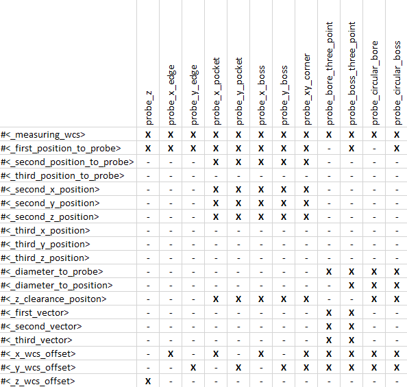

Parameters Used
The probing routines in Pathpilot make use of several parameters, which will need to be set appropriately for each use of a probing routine.
Parameter Use Chart
“X” indicates a required parameter for the given probing routine
“-” indicates an unused parameter for the given probing routine
“O” indicates and optional parameter for the given probing routine
Parameter Descriptions
#<_probe_fine_feed_per_min>
The fine feed rate for probing a feature. Set via the Pathpilot Probe Setup page.
#<_probe_rough_feed_per_min>
The rough feed rate for probing a feature. Set via the Pathpilot Probe Setup page.
#<_probe_rapid_feed_per_min>
The rapid feed rate for probing a feature. Set via the Pathpilot Probe Setup page.
#<_measuring_wcs>
The work coordinate system to be set during a probing routine. Given as a value between 1 and 500, eg G54 = 1, G54.1 P10 = 10. The measuring work coordinate system does not have to be the same as the work coordinate system used for positioning in probing routines.
#<_first_position_to_probe>
The absolute position in the positioning WCS for the probing move to finish at. The specified coordinate should always exceed the expected position of the probed feature. The axis represented depends on the probing routine being called; for probing routines calling multiple axes this parameter will represent the X axis.
#<_second_position_to_probe>
The absolute position in the positioning WCS for the probing move to finish at. The specified coordinate should always exceed the expected position of the probed feature. The axis represented depends on the probing routine being called; for probing routines calling multiple axes this parameter will represent the Y axis.
#<_third_position_to_probe>
The absolute position in the positioning WCS for the probing move to finish at. The specified coordinate should always exceed the expected position of the probed feature. The axis represented depends on the probing routine being called; for probing routines calling multiple axes this parameter will represent the Z axis.
#<_second_x_position>
The absolute position in the positioning WCS to begin a second probing move from in the X axis.
#<_second_y_position>
The absolute position in the positioning WCS to begin a second probing move from in the Y axis.
#<_second_z_position>
The absolute position in the positioning WCS to begin a second probing move from in the Z axis.
#<_third_x_position>
The absolute position in the positioning WCS to begin a third probing move from in the X axis.
#<_third_y_position>
The absolute position in the positioning WCS to begin a third probing move from in the Y axis.
#<_third_z_position>
The absolute position in the positioning WCS to begin a third probing move from in the Z axis.
#<_diameter_to_probe>
The diameter to command probing moves to extend to. This value should always be larger than the expected diameter to account for uncertainty between starting position and measured position.
#<_diameter_to_position>
The clearance diameter to position probing moves to begin at. For boss routines this value should always be great enough to ensure that there is adequate room for a probing move to occur at the desired Z height. For bore routines this value should always be smaller than the #<_diameter_to_probe> parameter.
#<_z_clearance_position>
The absolute position in the positioning WCS for Z clearance moves. This position should be clear of any possible obstacles during positioning moves.
#<_first_vector>
The first vector describing the angle of a probing move relative to the X positive direction. X positive represents 0 degrees and the value increases as movement goes counter-clockwise (eg, Y positive represents 90 degrees). Any values over 360 are treated as the remaining value from a modulo operation with a modulus of 360.
#<_second_vector>
The second vector describing the angle of a probing move relative to the X positive direction. X positive represents 0 degrees and the value increases as movement goes counter-clockwise (eg, Y positive represents 90 degrees). Any values over 360 are treated as the remaining value from a modulo operation with a modulus of 360.
#<_third_vector>
The third vector describing the angle of a probing move relative to the X positive direction. X positive represents 0 degrees and the value increases as movement goes counter-clockwise (eg, Y positive represents 90 degrees). Any values over 360 are treated as the remaining value from a modulo operation with a modulus of 360.
#<_x_wcs_offset>
The absolute coordinate in the measuring WCS that the found position in a probing routine should be set to in the X axis.
#<_y_wcs_offset>
The absolute coordinate in the measuring WCS that the found position in a probing routine should be set to in the Y axis.
#<_z_wcs_offset>
The absolute coordinate in the measuring WCS that the found position in a probing routine should be set to in the Z axis.
