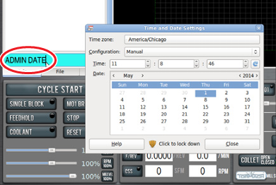

Date and Time
To set or edit controller’s date and time, type ADMIN DATE in the MDI field and click Enter on keyboard (see Figure 3.21). This opens a dialog box to enter or edit date, time, and time zone. Click Close when finished.
Figure 3.21

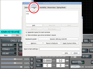

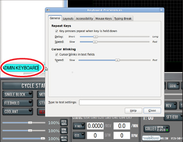

Keyboard Language
If you do not have a USA keyboard (QWERTY) layout, type ADMIN KEYBOARD in the MDI field and click Enter on your keyboard. (See Figure 3.22).
Figure 3.22
Next, click on the Layouts tab to change the layout of the keyboard to a different language (see Figure 3.23). Select a layout and click Close when finished.
Figure 3.23
