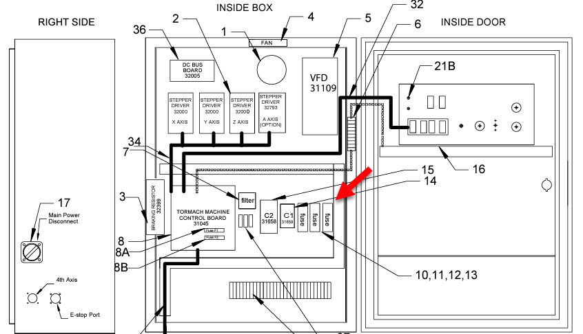

Replace the CMOS battery (stuck at Pathpilot splash screen)
Reseat the power cable
Restore power to the controller
  1. If the monitor and the controller both don't have power:
    1. Examine the power cables for damage or exposed wires and replace if needed.
    2. Replace the FU6 fuse.
PCNC 770 FU6 Fuse Location
Start the controller with only the monitor connected
Reason: There is a USB issue.
  2. Power back up.
      1. To get into BIOS, restart computer and rapidly press Del (for brix, rev c, rev d etc.) or F2 or F10 (tower controllers), If your date and time are accurate, and you still are having issues, restore to factory settings. PP v2 restore from drive.pdf
