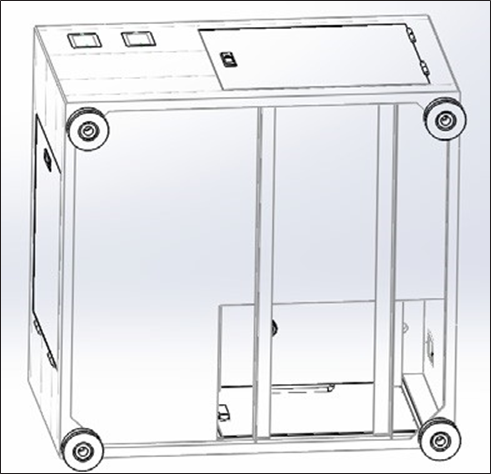

Attaching Feet to Stand
NOTE: Attach feet to Stand after the pallet is removed and while Stand is still on its side (see Figure 1).

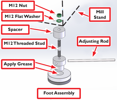

Apply multi-purpose grease to locations indicated in Figure 2 and join parts together.
Insert one M12 Threaded Stud into each foot and slide on Spacer (see Figure 2).
Attach feet to Stand using assembly shown in Figure 2.
Figure 2
Carefully return Stand upright so it rests on feet; position Stand where you plan to complete assembly.
NOTE: Position the Stand at least 12” away from walls or other obstructions.
When Stand is in its final location, level Stand using a carpenter’s level. Adjustments to feet are made using Adjusting Rod to increase or decrease height on each corner (see Figure 2).

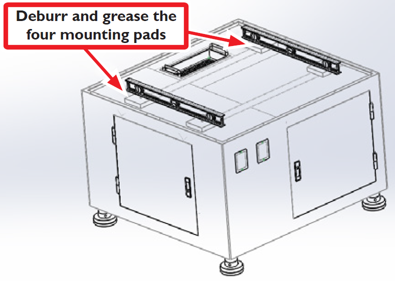

Deburr and grease four mill mounting pads to prevent rust (see Figure 3).

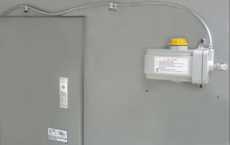

Installing Manual Oiler (optional)
Qty. | PCNC 770 Manual Oiler (PN 31302) | PN |
1 | Manual Oiler | — |
4 | Tubing Clips | — |
6 | M5 x 10 mm Screw | — |
NOTE: If any of these items are missing, contact Tormach Customer Service at (608) 849-8381 for a replacement.
NOTE: For information on installation and use of the 115 VAC Automatic Oiler (PN 31373), refer to documentation that ships with product.
Using two M5 x 10 mm Screws, mount Manual Oiler to pre-drilled holes on left side of mill.
Route oil line (pre-installed at back of mill near Y-axis motor) down back of stand and along left side as shown in Figure 4.
Using four M5 x 10 mm screws, mount Tubing Clips to pre-drilled holes; connect oil line (see Figure 4).
Figure 4
Fill manual oiler reservoir with ISO VG68 Machine Oil (PN 31386).
Retract and release plunger until oil is pushed through system. After that, pull plunger:
Each time mill is powered on
Every four hours of operation

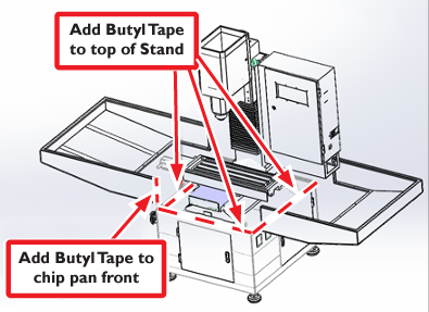

Position chip pans near Stand and test fit; the Left Chip Pan and Right Chip Pan are different.
Seal joints between top of Stand and Chip Pans with Butyl Tape as indicated in Figure 5 prior to installing Left Chip Pan and Right Chip Pan.
Figure 5
Using six M6 x 10 mm Screws, attach Right Chip Pan to Stand.
Repeat step 2 for Left Chip Pan.
Add a strip of Butyl Tape where chip pans meet in front (see Figure 5).
Using two M6 x 20 mm Screws and two M6 Nuts, join chip pans together.

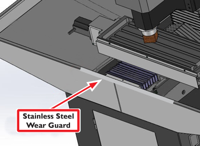

Using four M5 x 10 mm screws, attach Stainless Steel Wear Guard across front of chip pans (see Figure 6).
