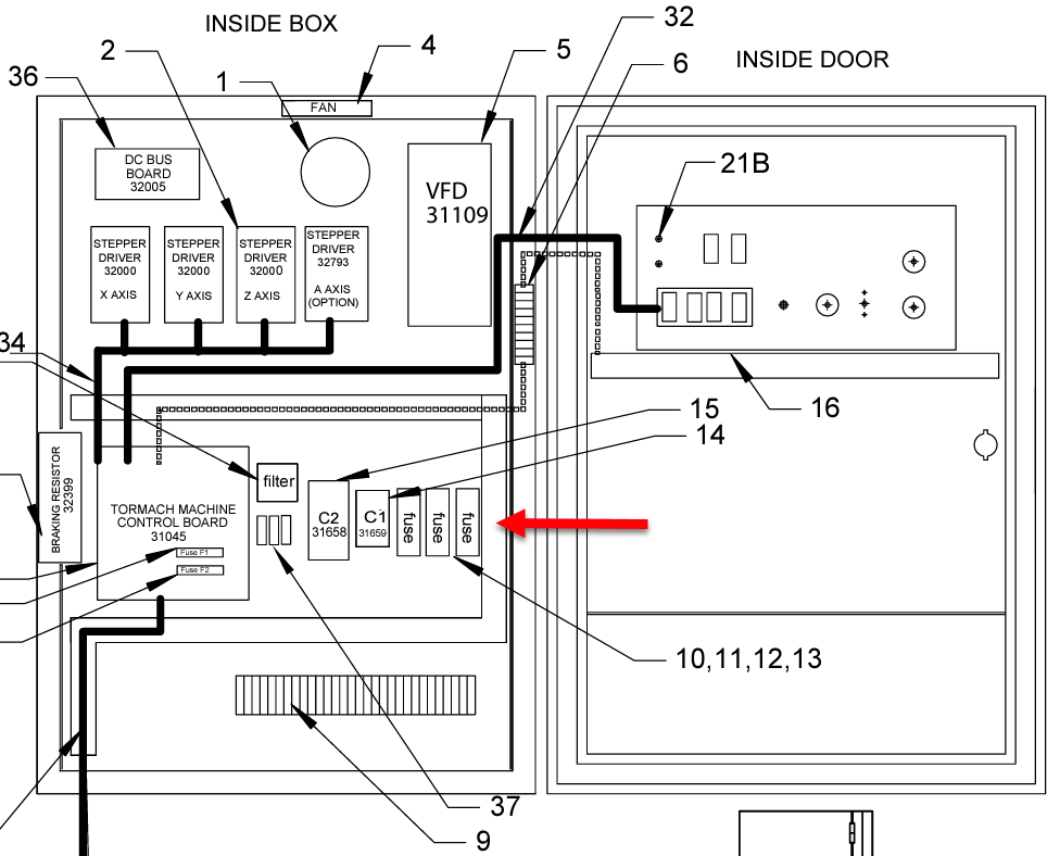

Check the FU1, FU3 and FU6 Fuses
Reason: Fuse is blown.
Identify your machines main fuses.
Power down the machine, and remove both fuses.
Check both fuses using the following process: Checking a Fuse on a Tormach Machine
If any fuse is blown, replace it.
