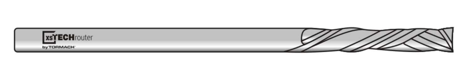

How do I cut plywood on the xsTECH Router?
For milling plywood and other laminates, we recommend using a carbide compression cutter.  Compression cutters have compound helix cutting edges designed to minimize tear-out and chipping of the thin outside facing layers of veneer.
PN 39173 is a 4 mm Compression Cutter and is included in the xsTECH cutting tool start kit.
