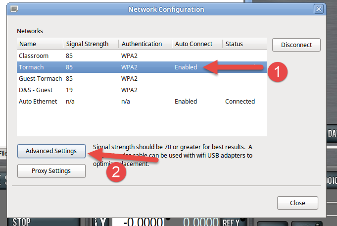

Some wireless networks may require you to register the MAC address of your PathPilot controller in order to access the network.  Here is how to find the MAC address:
  1. Connect to your WiFi network.  It won’t work, but it will auto populate the advanced settings screens with the correct WiFi settings needed in the next step.

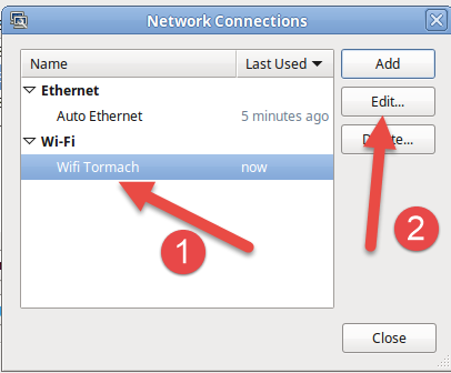

  1. Click Advanced Settings
  1. Select the WiFi network you connected to in step 1 and click Edit

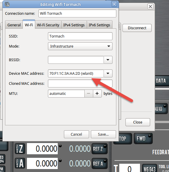

  1. The MAC address shown on the WiFi tab.  Contact your IT department if you need help with additional network configuration.
