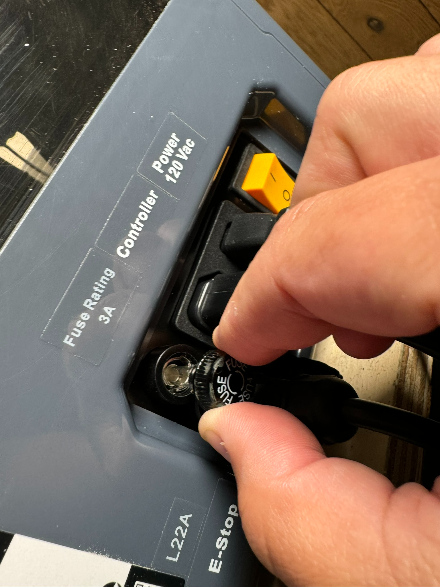

The xsTECH Router has one fuse, accessible from the back panel of the router. To replace it, twist the fuse holder while pushing the holder at the same time.
          Fuse Specification  |
          3A, 250V Fast Blow, 5mm x 20mm  |
