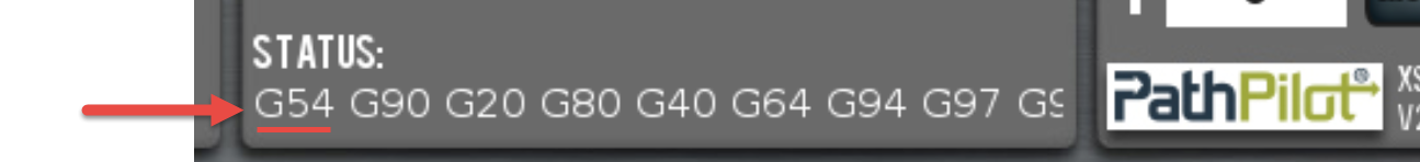

Many CNC machines can store more that one work offset at a time.  Each work offset is assigned to a G code; machine coordinates displayed are relative to the active work offset.  The active work offset can be determined by looking at the status line of the PathPilot display:

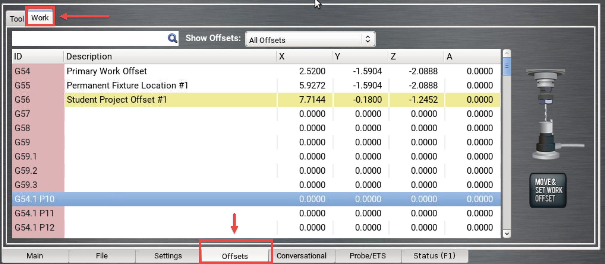

The actual Work Offsets coordinates are stored in the work offset table, which is found in the Offsets tab:
The X, Y, and Z coordinates associated with each offset are the distance of the offset from the reference location of the machine.  While it is possible to edit the coordinates in the work offset menu, it is not part of a common workflow.

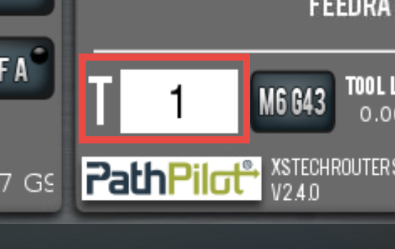

  1. Make sure the machine is referenced, and the active tool (the T field) in PathPilot is the same as the tool in the spindle:

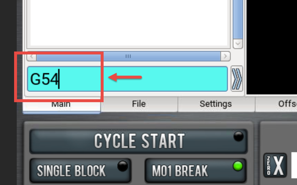

  1. Activate the desired work offset by typing it into the MDI field and pressing Enter.

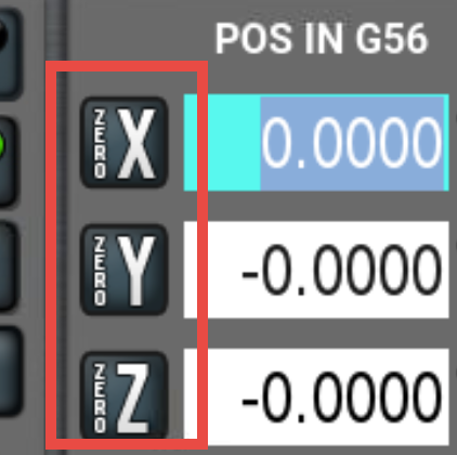

  1. Move X-, Y-, and Z-axes to position the center of the tool tip at the intended work offset location.
  2. Press Zero X, Zero Y, and Zero Z Buttons.  The work offset is now set.
