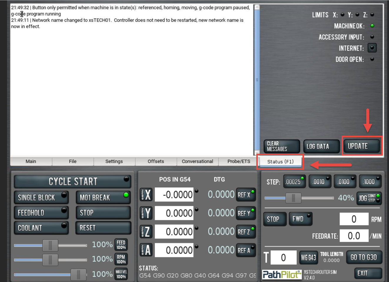

2.  Check for update packages
Select the STATUS tab and then click the UPDATE button

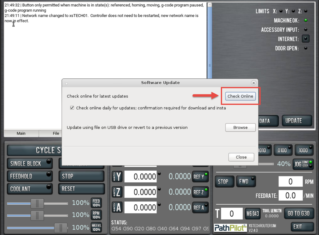

Click Check Online.  If you have the software update patch on a USB drive, connect the USB drive to your pathpilot controller and click Browse.
This will install the latest available update package for PathPilot.

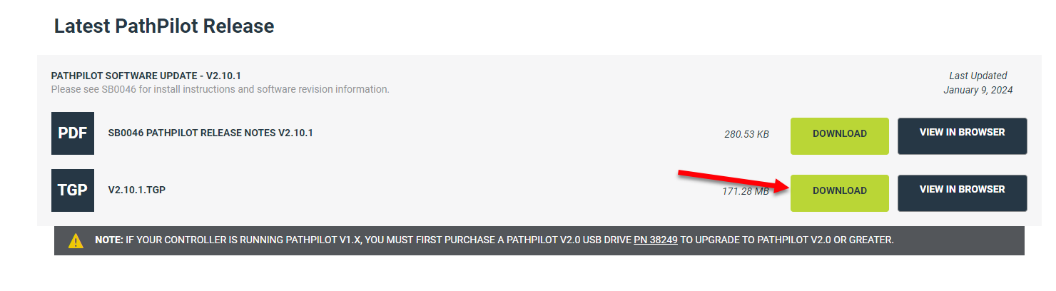

Update via USB
  1. Go to https://tormach.com/support/software/pathpilot/pathpilot-updates-and-notes .
Find the latest version of PathPilot. Click Download, and save it to a USB.

Select the STATUS tab and then click the UPDATE button.
Select the Browse button and select the .TGP file.
