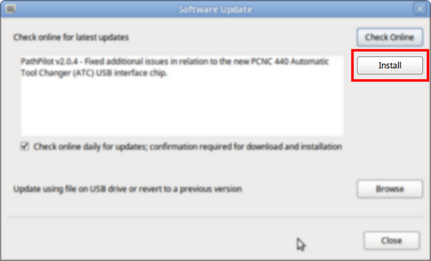

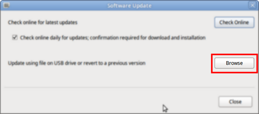

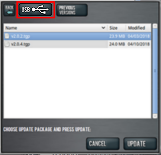

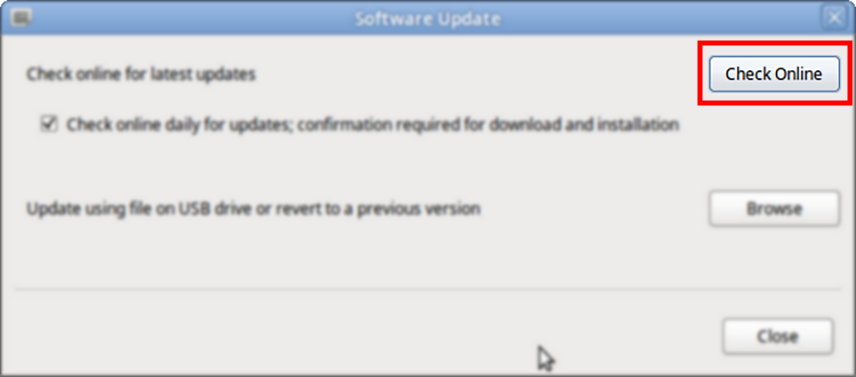

Update PathPilot
Before you begin to install this kit, you must verify that the PathPilot controller is updated to the latest version of PathPilot. This is because only PathPilot v2.2.X and later has settings required to use a servo motor mill configuration.
To update PathPilot, do one of the following:
  1. Select Install.
  1. The update file is downloaded, and a notification dialog box displays.
  2. From the dialog box, select OK.
  3. Follow the on-screen instructions to restart the PathPilot controller.

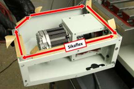

Prepare the Machine for the X-Axis Motor Cover
On the X-axis motor mount, you must drill and tap four holes that you'll use to secure the X-axis motor cover. Use the template (provided in this document) to drill and tap the holes in the correct location.
To prepare the machine for the X-axis motor cover:
  1. Clean the surface of the X-axis motor mount with a mild degreaser (like Simple Green®).

  1. To prevent coolant from entering the X-axis motor cover, you must first apply a layer of Sikaflex before putting back the tool tray. Clean the surfaces of the X-axis motor cover and the tool tray with a mild degreaser (like Simple Green®) to make sure that the Sikaflex bonds.
  2. Find the tube of Sikaflex provided with this kit, and the tool tray that you set aside in "Prepare the Machine".
  3. Put a bead of Sikaflex along the top edges of the X-axis motor cover.
Figure 14: Locations for Sikaflex on the X-axis motor cover
