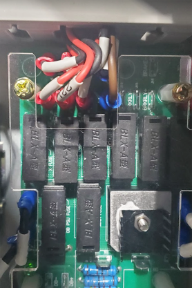

Set the Driver DIP Switches
Depending on which rotary table you're using, set the DIP switches on the motor driver as detailed in the following tables.

Verify the Installation
  1. Make sure that all wires on the motor driver and the DC-BUS board are completely connected.
  2. Replace the wire trough covers.
  3. Connect the rotary table to the A-Axis Encoder connector on the side of the electrical cabinet.
  4. Power on the machine and the PathPilot controller.

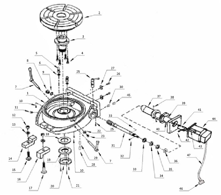

Align the Angle of the Tilt Position
  • Use the Vernier scale to align the angle of the 6 in. Tilting Rotary Table or 8 in. Tilting Rotary Table when moving from horizontal to vertical.
Figure 2: Vernier scale.
NOTE: It's easier to setup chucks or fixtures while the rotary table is in the horizontal position, and then move the rotary table to the vertical position.
Distribute Wear on the Rotary Table
We recommend distributing wear over the whole of the worm gear. Do the following:
  • When doing long runs of constant back-and-forth movement, occasionally reposition the table top and workholding fixture.
  • If the moves are close to 180°, continue rotating in the same direction to the start point, rather than returning in the opposite direction.
  • Program the start point to change a few degrees each time (if the part permits).
Lock the Tilt Position
You must lock the tilt position on the 6 in. Tilting Rotary Table or 8 in. Tilting Rotary Table before machining. To lock the tilt position:
  1. Set the desired tilt of the rotary table.
  2. Tighten the two tilt clamps.
    The tilt position is locked in place.

Turn the Rotary Table by Hand

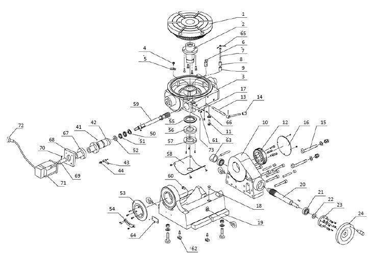

Power is transmitted from the A-axis motor driver to the rotary table by a worm gear at the end of the drive shaft. The eccentric lock stops the eccentric sleeve from rotating.
To turn the rotary table by hand, you must disengage the worm gear. To disengage the worm gear:
  1. Loosen the eccentric lock.
  2. Rotate the eccentric: Turn the motor mount as far as it will rotate in the clockwise direction (counterclockwise on super spacer rotary tables).
  3. Tighten the eccentric lock.
    The worm gear is disengaged.
To reengage the worm gear:
NOTICE! You must use the eccentric lock before engaging the worm drive. If you do not, there is a risk that the motor driver could disengaging during use.
  2. Rotate the eccentric: Turn the motor mount as far as it will rotate in the counterclockwise direction (clockwise on super spacer rotary tables).
    The worm gear is engaged.
  4. Make sure that the worm is completely engaged: If necessary, rotate the rotary table slightly (by hand) to engage the worm gear in the ring gear.
NOTICE! The worm must be completely engaged. If it's not, the rotary table will exhibit excessive backlash.

Adjust the Backlash
NOTICE! You must complete the steps in this procedure to adjust the backlash. If you do not adjust the backlash, it could result in premature wear on the rotary table.
To Set the Backlash by Positioning the Backlash Adjustment Screw
  1. Identify the backlash adjustment screw: Remove the protective cover screw on top of it, or loosen a jam nut.
Figure 1: Backlash adjustment screw on a standard rotary table.
Figure 2: Backlash adjustment screw on a tilting rotary table.
Figure 3: Backlash adjustment screw on a super spacer rotary table.
  1. Loosen the backlash adjustment screw six turns counterclockwise.
  2. Disengage the eccentric lock and clamp handles.
  3. Engage the worm gear: Rotate it completely (counterclockwise on standard and tilting rotary tables; clockwise on super spacer rotary tables).
  4. Verify that the rotary table does not turn. It doesn't turn when the motor is engaged.
  5. Use one hand to put counterclockwise pressure on the motor (clockwise on super spacer rotary tables), and slowly tighten the set screw until you feel resistance to the pressure you're applying.
    Tip! Move slowly — the resistance could be subtle.
    The set screw is just against the worm drive.
  6. Tighten the set screw a quarter-turn. The motor rotates slightly, and creates a gap (for an oil film) between table and worm gear.
  7. Replace the protective cover screw.
To Set the Backlash by the Numbers
  • Adjust for a minimum backlash of 30 arc-seconds. Measured at the outer circumference of an 8-in. diameter circle with a dial indicator, 30 arc-seconds will be 0.0006 in. of lost motion.
Setting the backlash to 60 arc-seconds will sustain a thicker oil film, yielding lower friction and longer life. Measured at the outer circumference of an 8-in. diameter circle with a dial indicator, 60 arc-seconds is 0.0012 in. of lost motion.
We do not recommend setting the backlash greater than 90 arc-seconds (1.5 arc-minutes). It won't improve the life of the mechanism, and could result in chatter during machine operations.
About Backlash
Backlash is an important element in managing overall accuracy. On a rotary table, a number of internal sliding surfaces depend on a hydrodynamic oil film for low friction and long service life. The adjustment of clearances between these surfaces helps to achieve precision and extends service life — much like the adjustment of the lead screw nut and gibs on a mill or a lathe.
If the backlash is adjusted to zero, the worm screw (and other parts) are subjected to excessive wear and friction — which may lead to stalling of the rotary table. As the worm screw turns, the oil shears off at the gear interface, and provides no film to protect against metal-to-metal wear.
Adjust the Lock Nut
You must adjust the lock nut to adjust for wear in the worm gear.
  1. Loosen the socket head cap screw and the set screw on the motor coupling. Do not remove the screws.
  2. Remove the four mounting screws securing the motor to the motor mount.
  3. Remove the motor — with the coupling still attached — from the motor mount.
  4. Put grease on the back side of the spacer.
  5. Use two spanner wrenches to tighten (or loosen) the lock nuts.
Figure 4: Example of tightening the lock nuts with two spanner wrenches.
  1. Adjust the spacer nut so that — when turned by hand — there is no axial play in the worm shaft, and so that the shaft moves freely. Do not over-tighten the lock nut.
Figure 5: Example of turning the spacer nut by hand.

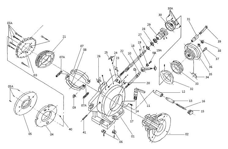

Adjust the Rotary Table
To test for correct axial adjustment:
  1. Disengage the worm.
  2. Rotate the table by hand. You should feel a slight drag. If you do not feel a drag, do the following:
    1. Use a flat-head screwdriver to loosen the three screws in the retaining plate two turns.
    2. Use an Adjustable Pin Spanner Wrench (PN 31118) to tighten or loosen the retaining plate.
Figure 6: Retaining plate on the rotary table.
c. Rotate the plate clockwise to increase drag, or counterclockwise to decrease drag.

Standard Rotary Table Exploded View
Standard Rotary Table Parts List
ID
Base
Table
Taper sleeve
Socket head bolt*
Table clamp
O-ring dash 110*
Handle assembly
Sight glass
O-ring
Dog point set screw
11
Plug
12
Hex nut*
13
Washer
14
Clamp
15
T-bolt
16
L-clamp
17
T-bolt
18
Ring
19
Table nut
20
Retaining plate
21
Fillister head screw
22
Indicator
23
Knob
24
Set screw dog point
25
Eccentric lock
26
Socket head bolt*
27
Locating key
28
Set Screw*
29
Backlash Adjustment Screw (PN 34380)
30
Block
31
Worm gear
32
Key
33
Dowel pin
34
Spacer
35
Lock nut
36
Spacer with keyway
37
Eccentric sleeve
38
39
Motor mount
40
Socket head screw*
41
Coupling
6” (PN 31840)
8” (PN 30715)
42
Set Screw*
43
Socket head screw*
44
Motor complete
6” (PN 32677)
8” (PN 32379)
45
Oil plug
46
Power plug
47
Cable
(not shown)
Oil fitting (PN 35220)
*Standard hardware items
Tilting Rotary Table Exploded View
Tilting Rotary Table Parts List
ID
Table
Taper sleeve
Base
Knob
Indicator
Table clamp
Bolt
Locking pad
Locking pillar
Supporter
11
Positioning screw
12
Helical gear
13
Eccentric axle
14
Table clamp handle
15
Locking lug
16
Cover
17
Backlash adjustment screw (PN 34380)
18
Positioning block
19
Base
20
Screw bar
21
Bearing
22
Sealing
23
Cover
24
Handle wheel
41
Pin
42
Eccentric sleeve
43
Handle
44
Bolt
50
Spacer
51
Spanner nut
52
Spacer
53
Indicate plate
54
Vernier
55
Spacer
56
Locating nut
57
Locating nut
58
Cover
59
Worm gear
60
Positioning block
61
Pin
62
Locating key
63
Block
64
Name plate
65
Eccentric lock
66
Bolt
68
Socket head screw
69
Motor coupling
6” (PN 31840)
8” (PN 30715)
70
Set screw
71
Motor complete
6” (PN 32677)
8” (PN 32379)
72
Power plug
(not shown)
Oil Fitting (PN 35220)
Super Spacer Rotary Table Exploded View
Super Spacer Rotary Table Parts List
ID
Body
Spindle
Index plate
3A
Screw
Masking plate
Bumper plate
5A
Screw
Centering key w/ screw
Brake shoe
7A
Spring
Brake shoe
Screw
Screw arbor
11
Index handle
12
Sleeve
13
Index pin
14
Gear shaft
15
Cover
16
Spring
17
Screw
18
Clamp handle
19
Bushing
19A
Screw
20
Vernier scale
21
Ring gear
22
Worm gear
23
Indicating plate
24
Pin w/ inclined surface
25
Handle
26
Name plate
27
Spacer
28
Screw nut
29
Eccentric sleeve
30
Shaft sleeve
31
Set screw
32
40
Locating pin for masking plate
41
Screw
(not shown)
