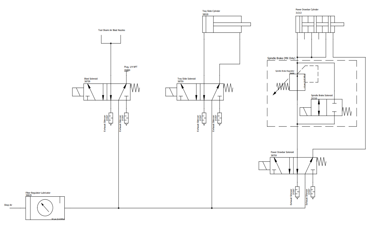

Make Air Connections
  2. Route the loose ends of the two 1/4 in. plastic tubes connected to the ATC main assembly through the enclosure knockout, up the energy chain, and toward the Power Drawbar.
  3. Trim and connect the loose ends of the 1/4 in. plastic tubes in the following order:
Figure 12: Air in port in the ATC main assembly.
d. If you haven't already done so, connect your shop's air supply to the FRL.

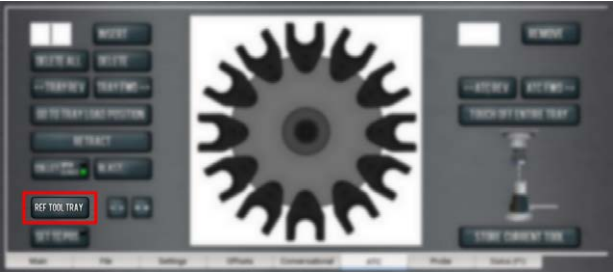

  1. Verify that there’s no tool in the spindle.
  2. From the PathPilot interface, on the ATC tab, select Ref Tool Tray.
Figure 21: Ref Tool Tray button on the ATC tab.
The tool tray spins.

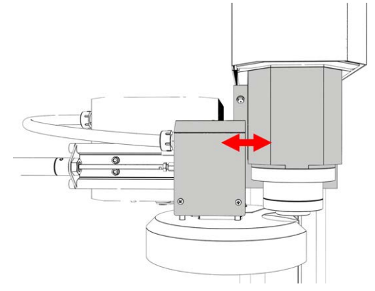

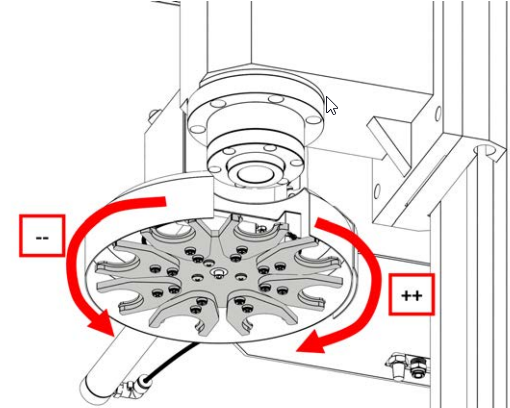

  5. If the tool's shank isn't aligned, do the following:
  • Adjust the Alignment of the Tool in the Y Direction (toward or away from the Z column) Determine if the tray must move clockwise or counterclockwise. From the PathPilot interface, in the ATC tab, either select -- to step the tool tray counterclockwise or ++ to step the tool tray clockwise.
 Figure 23: Moving the tool tray clockwise or counterclockwise.
  • Adjust the Alignment of the Tool in the X Direction (left or right) Determine if the tray must move left or right. Use two wrenches to loosen the jam nut on the end of the cylinder rod, making sure that you don't spin the rod end when adjusting the jam nut. Then, either turn the rod end one-half turn further on to the cylinder rod to move the tool tray to the left, or turn it one-half turn off of the cylinder rod to move the tool tray to the right. Once finished, tighten the jam nut.
 Figure 24: Moving the tool tray left or right.
Repeat adjustments until the tool's shank is concentric with the collet in the spindle.

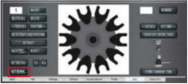

Set the Tool Change Height
  2. On the ATC tab, select Set TC POS
 Figure 25: Set TC POS button on the ATC tab.

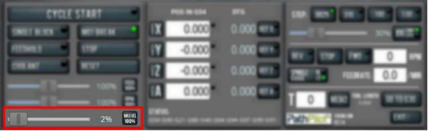

  1. From the PathPilot interface, on the Main tab, drag the Maxvel Override slider to the left. This reduces the maximum velocity by the percentage shown.
 Figure 27: Maxvel Override slider on the Main tab.
  1. Do a test tool change. Because the maximum velocity is reduced, it's easier to verify the alignment of the ATC and stop the machine if further adjustment is required.
Tip! Use the Spacebar key to pause the tool change, if needed.
Figure 8: Set TC POS button on the ATC tab.
