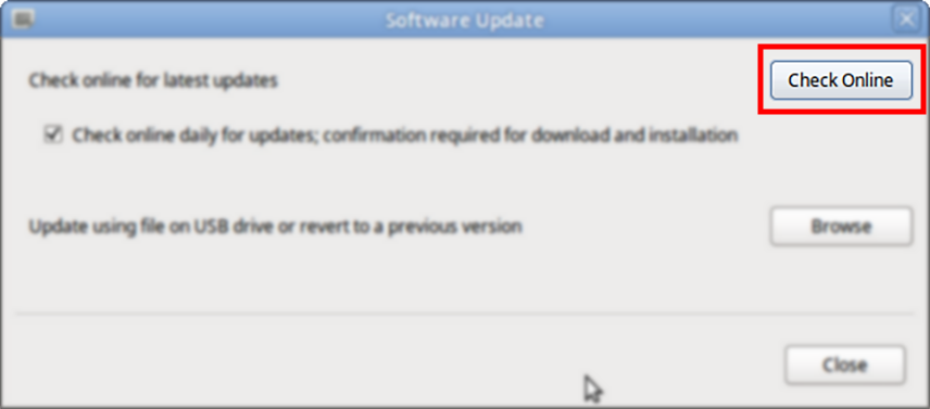

Update PathPilot
Before you begin to install this kit, you must verify that the PathPilot controller is updated to the latest version of PathPilot. This is because only PathPilot v2.4.2 and later has settings required to use a BT30 spindle mill configuration.

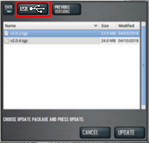

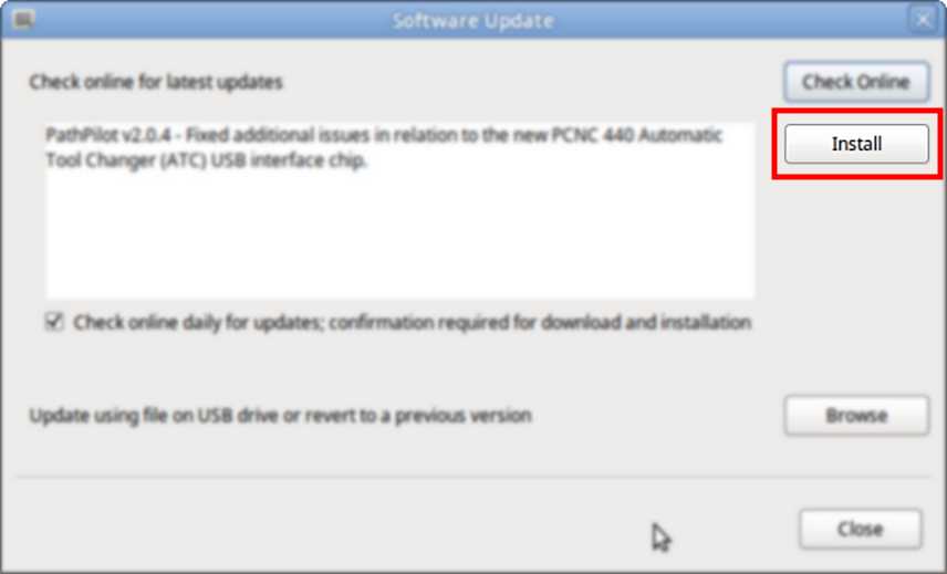

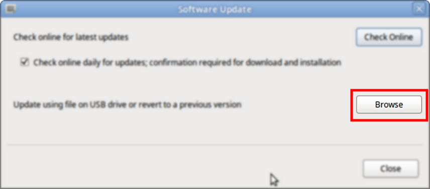

To update PathPilot, do one of the following:
  1. Select Install.

Figure 5: Software Update dialog box.
Figure 6: Browse dialog box.

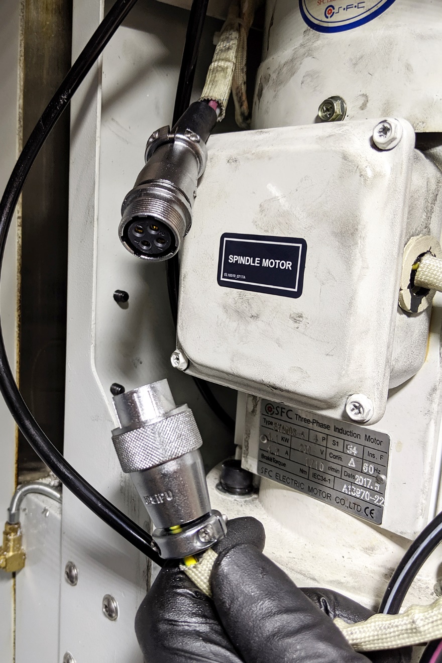

Prepare the Machine
  1. Remove any tooling, fixtures, workpieces, or parts from the machine.
  2. Jog the spindle nose until it's approximately 6 in. (15.2 cm) above the machine table.
  3. Power off the machine and the PathPilot controller.
  4. Disconnect any pneumatic air lines on the machine, and verify that the lines are empty.
  5. Open the spindle cover and lock it in the up position.
  6. Disconnect the spindle motor quick-connect fitting.
Figure 1: Spindle motor quick-connect fitting disconnected.

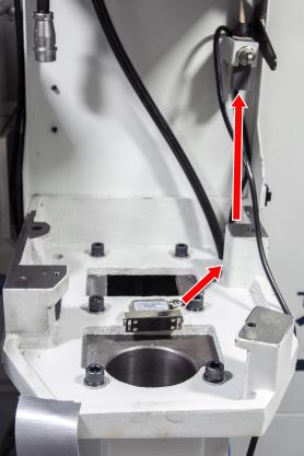

  1. Route the wire from the encoder along the floor of the casting, up behind the spindle door switch, and up through the energy chain.
Figure 17: Encoder wiring management.
Tip! We recommend using a piece of heavy-gauge wire as a pull to route the encoder wire through the energy chain.
  1. Identify surfaces on which to secure the encoder wire to the machine with the provided cable ties and cable tie holders. Then, clean the surfaces where you'll put the cable tie holders.

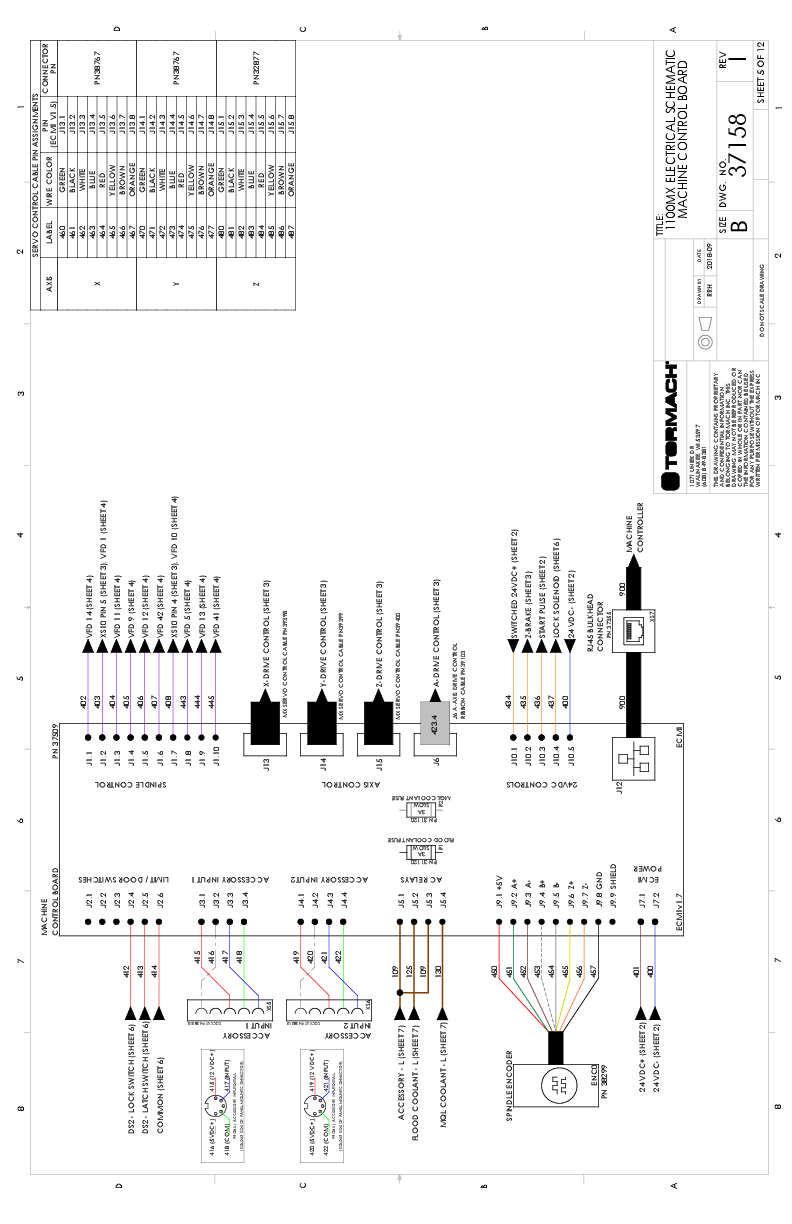

  1. Inside the electrical cabinet, remove the top wire trough cover and set it aside.
  2. On the ECM v1.5 board, identify the J9 connector. For information, see "Machine Control Board”.
  3. If necessary, remove any tabs from the wire troughs surrounding the connector so that you can easily make wire connections.
  4. Connect the terminal block with the encoder wires to J9 on the ECM v1.5 board.
Figure 20: Encoder wire connected to J9 on the ECM v1.5 board.

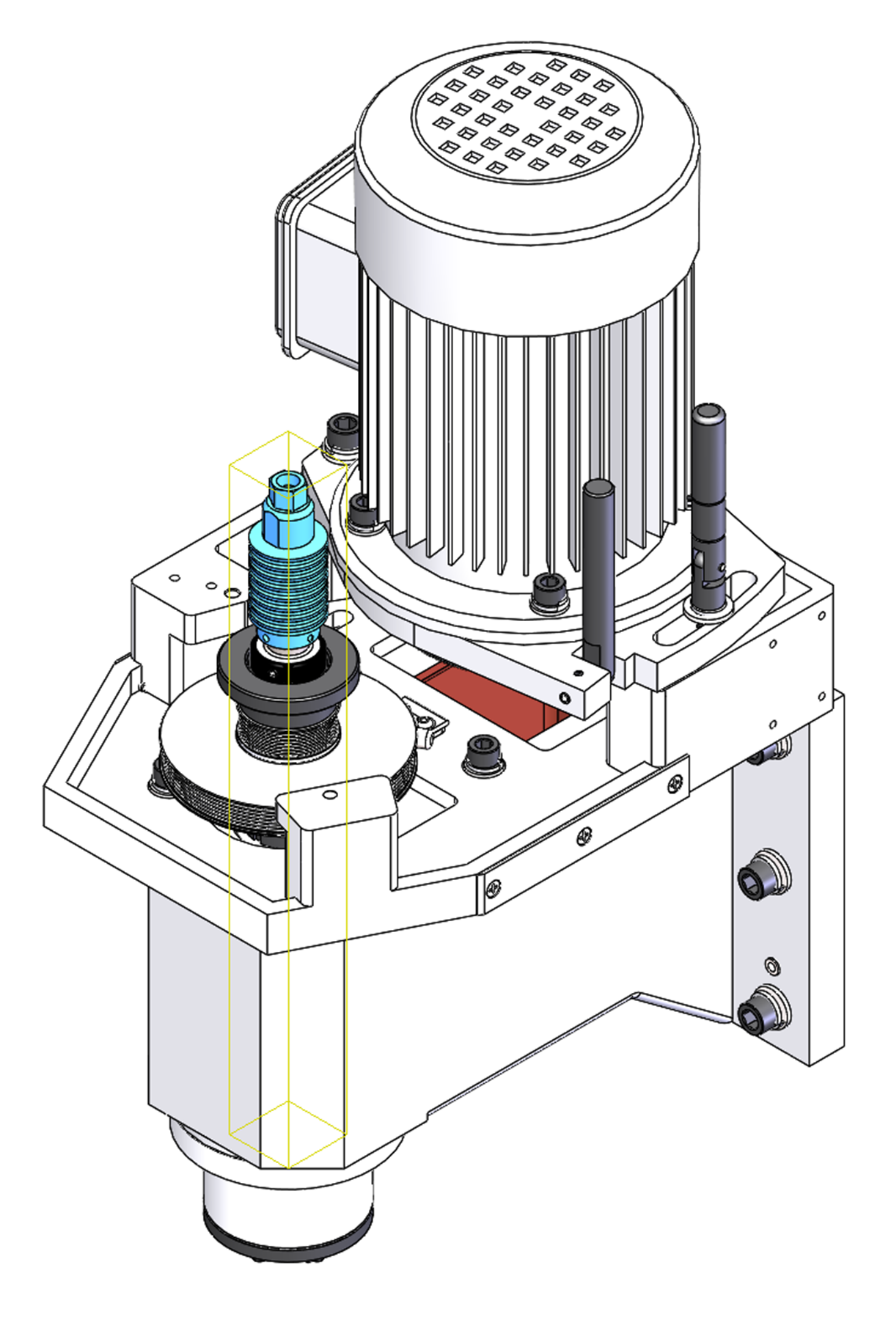

Install the BT30 Spindle and Align the Encoder
Tip! For more information while installing BT30 components on the machine, it may help to refer to the "Spindle Cartridge".
    3. Press the Reset button.
  2. Find the BT30 spindle provided in this kit.

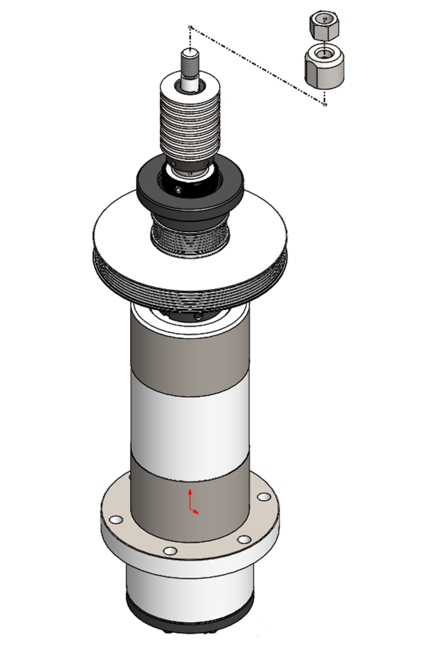

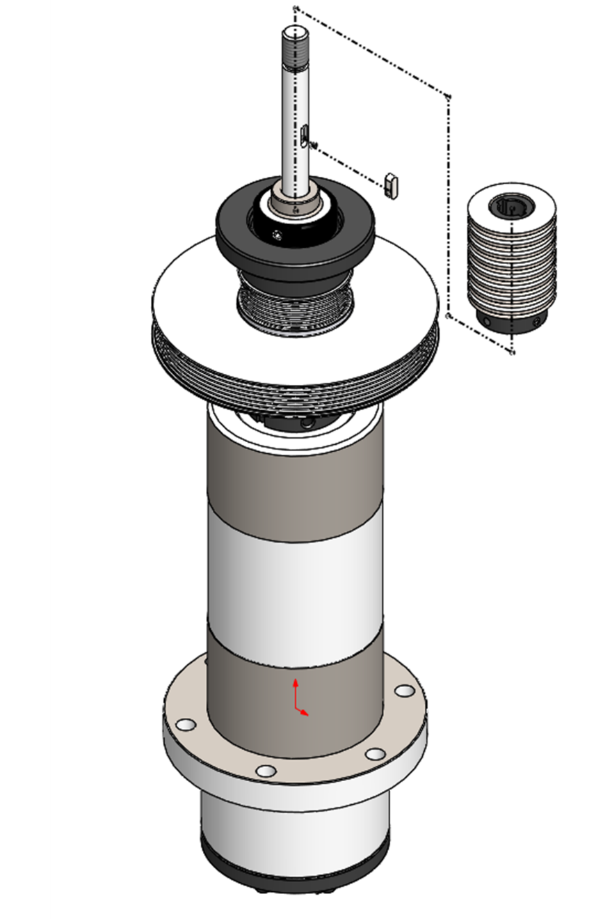

  3. Disassemble the BT30 spindle:
    1. Use a 4 mm hex wrench to prevent rotation of the drawbar shaft.
Figure 21: Preventing the drawbar shaft from rotating.
b. From the top of the drawbar, remove the jam nut with a 19 mm open-ended wrench and remove the disc spring compression nut with a 25 mm open-ended wrench. Some drawbar assemblies also include a number of shim washers beneath the disc spring compression nut. If your spindle includes these, save them and reinstall them in the same location in Step 22.
Figure 22: Jam nut and disc spring compression nut removed from the drawbar.
c. Loosen the two set screws on the disc spring guide with a 2 mm hex wrench, and then remove the following items from the drawbar stack assembly:
  • Disc springs, 16
  • Disc spring guide
Figure 23: Disc springs and disc spring guide removed from the drawbar.

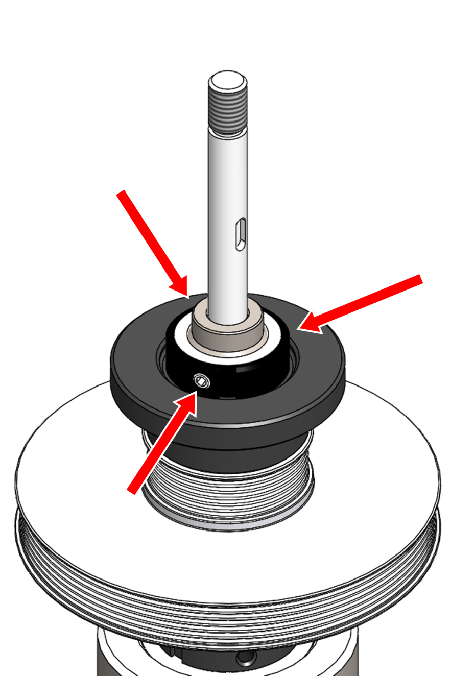

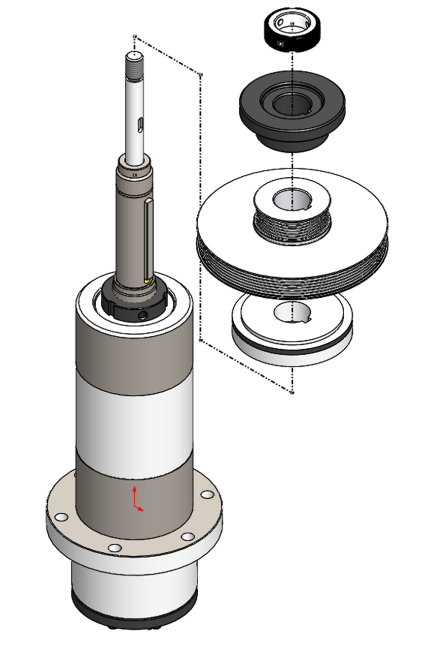

d. Loosen the three set screws that secure the retention nut with a 3 mm hex wrench.
Figure 24: Three set screws on the retention nut.
e. Remove the retention nut with the provided spanner wrench. Set the retention nut aside.
Figure 25: Removing the retention nut.
Tip! For a better grip on the pulley, we recommend using the old 260 Poly-V belt to hold it in place.
f. Remove the following items from the BT30 spindle:
  • Encoder ring
  • Power drawbar flange
  • Pulley
Then, set all items aside.
Figure 26: All items from a disassembled BT30 spindle.

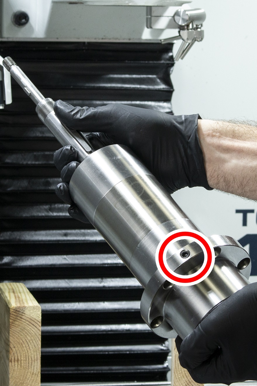

  3. Identify the hole on the spindle flange as shown in the following image.
Figure 27: Hole on the spindle, which you must verify is pointing toward the machine column to install.
  1. Turn the spindle so that the hole is pointing toward the machine column. Then, put the spindle between the two blocks of wood on the machine table.

  10. Install the pulley and power drawbar flange over the top of the spindle as shown in the following image.
Figure 29: Encoder ring, pulley, and power drawbar flange installed.
  1. Reinstall the retention nut with the provided spanner wrench. Secure it by tightening its three set screws with a 3 mm hex wrench.
  2. Install the disc spring guide and disc springs. Install disc spring compression nut, jam nut, and any shim washers. Verify that the drawbar preload witness marks are aligned.
Figure 30: Disc spring guide and disc springs installed.
NOTE: If the witness marks rubbed off during the installation, tighten the disc spring compression nut until it's snug, secure it with the jam nut, and make further adjustments after completing the Power Drawbar upgrade and/or installation. For information, see (refer to the section regarding insufficient preload of drawbar springs).
  1. Install the provided 250 Poly-V belt in high belt position, and then apply tension with the belt tensioner.
  2. Reconnect the motor quick-connect fitting.

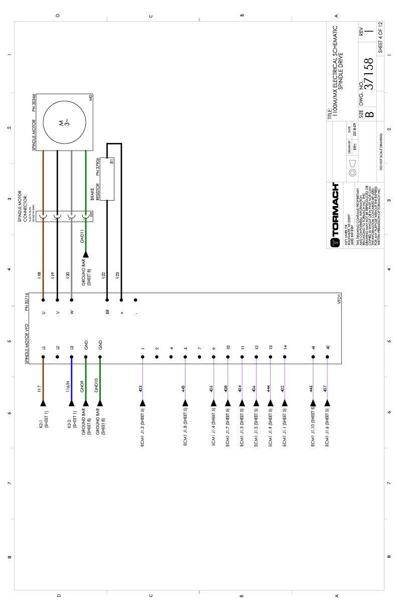

Install the VFD (Serial Number MA10629 and Below Only)
  2. Open the electrical cabinet door and identify the variable frequency drive (VFD).
  3. Remove the lower wire trough cover from the electrical cabinet and set it aside.
  4. Remove the access panel from the VFD with a flat-blade screwdriver and set it aside.
  5. Remove all of the wires connected to the VFD with a flat-blade screwdriver, Phillips screwdriver, or torque driver as necessary.
  6. Loosen the four mounting screws that secure the VFD to the electrical cabinet with a Phillips screwdriver. Set the mounting screws aside, and remove the VFD from the electrical cabinet.
  7. Find the new VFD provided in this kit. Then, remove its access panel with a flat-blade screwdriver, and install it in the electrical cabinet with the four mounting screws that you set aside in Step 6.
  8. Install the wires that you removed from the old VFD in Step 5 into the new VFD. Use the following images (and the "Spindle Drive" wire schematic) to verify all connections.
Figure 31: VFD wiring.
Figure 32: VFD wiring.
Figure 33: VFD wiring.
  1. After double-checking and confirming wire connections, replace the access panel on the VFD.
  2. Organize the wires from the VFD into the lower wire trough, and then replace its cover that you set aside in Step 8.
  3. Close the electrical cabinet door.

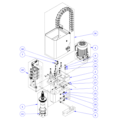

Resources

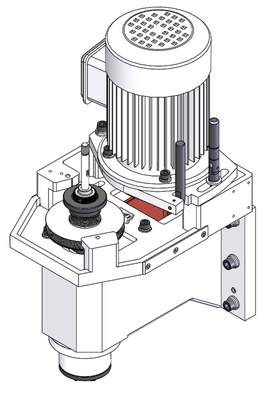

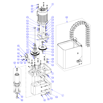

Spindle Drive
Machine Control Board (Sheet 5)
 Spindle Head
1100M
1100MX
1100M
ID
1100 Head Casting (PN 30323)
1100 Spindle Motor Mount (PN 30324)
Spindle Pulley1
Power Drawbar Flange1
Bearing Nut, M25 × 1.5, Set Screw (Angled)1
Drawbar, R8 (7/16-20), 305 mm (PN 38793)
Power Drawbar Alignment Bushing (PN 31330)
1100 Spindle Motor Pivot Plate (PN 30341)
Spindle Motor, 1100 (PN 30346)Spindle Motor, 1100
Motor Pulley Spacer, 1100 (PN 30347)
11
Key, 8 mm × 7 mm - 40 mm (PN 30348)
12
Pivot Bushing (PN 30350)Pivot Bushing
13
Pulley Washer (PN 30351)
14
Tensioning Handle Detent Pin (PN 30336)
15
Spring, 1 × 4.8 × 20 (PN 30338)
16
Pivot Plate Pin (PN 30340)
17
Spindle Motor Handle (PN 30339)
18
Screw, Cone Point Set, M5 x 0.8 - 8 (PN 30337)
19
Washer, Flat, M10 (PN 30325)
20
1100 Motor Pulley (PN 37733)
21
Pivot Plate Clamp Bolt (PN 30342)
22
Pivot Plate Clamp Handle (PN 30345)
23
Clamp Handle Detent Pin (PN 30343)
24
Spring, 1 × 4.8 × 20 (PN 30344)
25
Pin, 4 mm - 16 mm (PN 30395)
26
Washer, Split Lock, M12 (PN 30321)
27
Washer, Flat, M12 (PN 30322)
28
Pin, Taper, 8 mm - 40 mm (PN 30320)
29
Wear Strip, Spindle Door (PN 38451)
30
Screw, M5 × 0.8 -14 (PN 37901)
31
Spindle Lock Base (PN 38716)
32
1100M Spindle Lock Bar (PN 38717)
33
Washer, M6, Nylon (PN 38714)
34
Screw, M8 × 1.25 - 10 mm (PN 31682)
35
Spring, 6 mm × 20 mm (PN 31559)
36
Ball, 6 mm, Steel (PN 38225)
37
Washer, Split Lock, M10 (PN 31684)
11
38
Screw, Socket Head Cap, M10 × 1.5 - 30 (PN 31894)
39
Screw, Socket Head Cap, M8 × 1.25 - 20 (PN 31895)
40
Washer, Flat, M12 (PN 32473)
41
Screw, Socket Head Cap, M12 × 1.75 - 45 (PN 30349)
42
Washer, Flat, M10 (PN 30919)
43
Screw, Socket Head Cap, M12 × 1.75 - 50 (PN 32476)
44
Screw, Socket Head Cap, M6 × 1 - 45 (PN 38715)
45
Screw, Socket Head Cap, M6 × 1 - 20 (PN 30832)
46
Key, 6 mm × 6 mm - 55 mm1
47
Spindle Pulley Spacer1
48
Tormach Tooling System (TTS) Adapter Collet: R8 (PN 50568)
49
Screw, Socket Head Cap, M8 × 1.25 - 30 (PN 30544)
50
Spindle Housing, 80 mm (PN 37701)
53
Spindle Shaft, R8 (PN 37702)
54
Spindle Nose Closure, 80 mm (PN 37703)
55
1100 Bearing Spacing Sleeve (PN 37704)
56
1100 Upper Bearing Shield (PN 37705)
57
Nut, Bearing, M35 × 1.5, Set Screw (PN 37567)
58
Pin, 3.5 mm × 9 mm (PN 38353)
59
Power Drawbar Spring Washer (PN 31319)
60
Screw, Socket Head Cap, M4 × 0.7 - 16 (PN 37751)
62
R8-TTS Spindle Cartridge Assembly, 1100M (PN 37269)1
63
Spindle Cover Exploded View
1R8-TTS Spindle Cartridge Assembly, 1100M (PN 37269) includes the following balanced and matched parts: #3, #4, #5, #46, and #47.
1100MX
ID
Spindle Cover, 1100 (37690)
1100 Spindle Motor Pivot Plate Assembly (37714)
BT30 Spindle Cartridge Assembly, 1100MX (PN 39590)
Magnetic Encoder, Readhead (PN 38299)
Mill Coolant Manifold Assembly (PN 38346) (Optional)
11
12
13
14
15
16
17
18
19
1100MX/770MX Power Drawbar Kit (PN 50433)
20
1100MX Spindle Belt (PN 50402)
Spindle Cartridge
ID
Magnetic Encoder, Spindle Ring (PN 38298)
Spindle Pulley, 1100MX (PN 39576)
Flange, BT30 Power Drawbar (PN 39577)
Key, Straight, 6 mm × 6 mm - 64 mm (PN 39579)
Disc Spring Guide, MX BT30 Spindle (PN 39597)
Disc Spring Compression Nut, MX BT30 Spindle (PN 39598)
Disc Spring, 40 mm × 20.4 mm × 2.0 mm × 3.10 mm (PN 39689)
16
Nut, Jam, M12 × 1.75 (PN 39602)
Drawbar, BT30 Spindle (PN 39574)
Clamping Unit, BT30 (PN 39690)
11
Key, Straight, 4 mm × 4 mm - 12 mm (PN 39601)
12
O-Ring, 9 mm × 12 mm × 1.5 mm, Buna-N (PN 39584)
13
Nut, Bearing, M25 × 1.5 (PN 39589)
14
Drawbar Core Assembly, MX BT30 Spindle (PN 39599)
