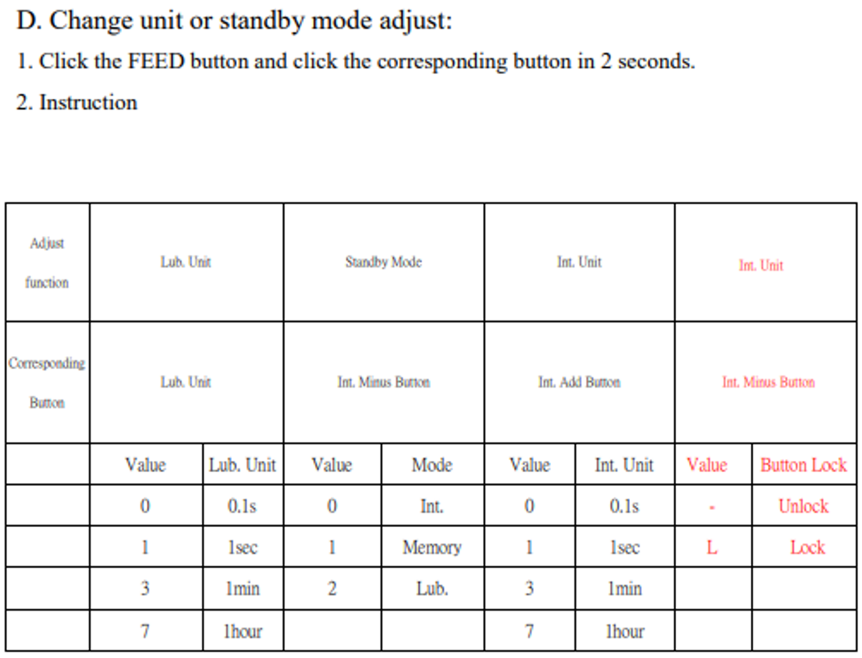

If you have an auto oiler, that seems to be counting down the interval time in seconds, rather than minutes, follow this procedure to change units, to minutes.
![](../__attachments/3602448490/image-20230112-144050.png?inst-v=aeb7ea93-b7a1-46e6-b02b-d6d51696a167)
