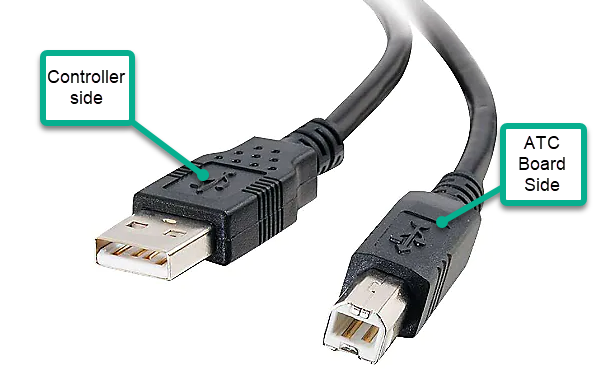

  1. All machines with an ATC communicate through a USB to USB-B cable. Identify this cable on your machine.
  2. Reseat the cable on both ends and then, in the PathPilot interface, check to see if the ATC tab does not disappear after 30 seconds. If the ATC tab does disappear, try replacing this cable and and rechecking PathPilot for the ATC tab.

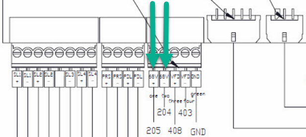

  3. Check for 68 Vdc across wires 204 and 205 at the ATC control board.
    M/MX ATC Board

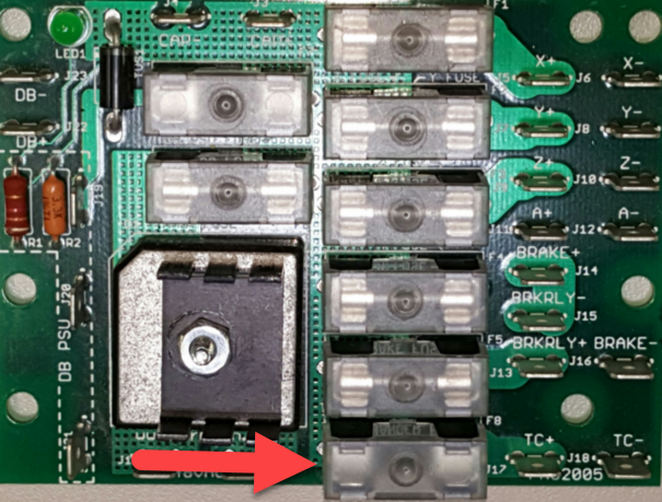

  4. If you do not have +68 Vdc across wires 204 and 205, move to the DC bus board in the electrical cabinet and check the F8 fuse for continuity. If you do not have continuity, replace the fuse.
    Note: This value should be close to zero and absolutely no more than 5 ohms.
    M/MX DC Bus Board
