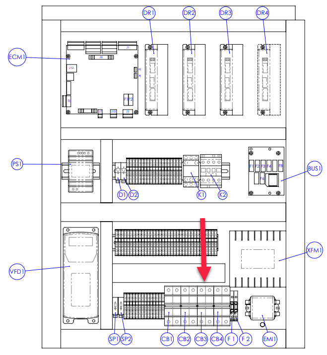

Controller Won't Power On - 1100MX
Replace the CMOS Battery (stuck at Pathpilot splash screen)
Reseat the Power Cable
Restore Power to the Controller
  • If the monitor and the controller both don't have power:
    • Examine the power cables for damage or exposed wires and replace if needed.
    • Reset the CB3 circuit breaker.
Location of CB3 in M/MX Electrical Cabinet
