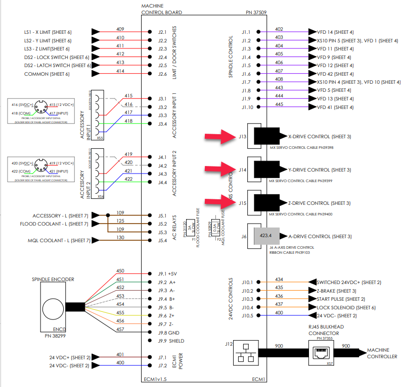

  2. Examine the data cables at the machine control board and the servos removing then re-connecting them to ensure they are seated.
    1. Machine control board: Degson style
      1. 424 (J13) (X-axis)
      2. 425 (J14) (Y-axis)
      3. 426 (J15) (Z-axis)
    2. Servos: Molex style
1100MX ECM Board

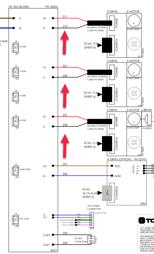

  1. Examine the power cables at the DC-Bus and the servos removing then re-connecting them to ensure they are seated.
    1. DC-Bus: Spade connector
      1. 210/211 (X-axis)
      2. 220/221 (Y-axis)
      3. 230/231 (Z-axis)
1100MX DC Bus Board

Reason: There's a blown fuse on the DC-BUS board.
    1. If the green LED is not illuminated: Go to All Axes Won't Move When Commanded - 1100MX
  3. Power off the machine.
      1100MX DC Bus Board
Function
Fuse Number
Amperes
Speed
X-Axis
F1
8 A
Fast
Y-Axis
F2
8 A
Fast
Z-Axis
F3
8 A
Fast
A-Axis
F4
8 A
Fast
Main DC-BUS fuse
F6
10 A
Slow
ATC
F8
5 A
Fast
To learn how properly check a fuse, go to Checking a Fuse on a Tormach Machine
