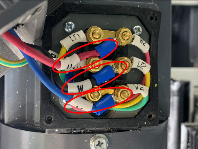

In the event that your RapidTurn motor in spinning in the improper direction, no need to worry. This is an easy fix!
Adjustable wrench
Phillips Screwdriver
Open up the RapidTurn motor junction box
Swap the position of two of these wires: U, V, W
DO NOT MOVE U1, V1, W1, or U2, V2, W2!
