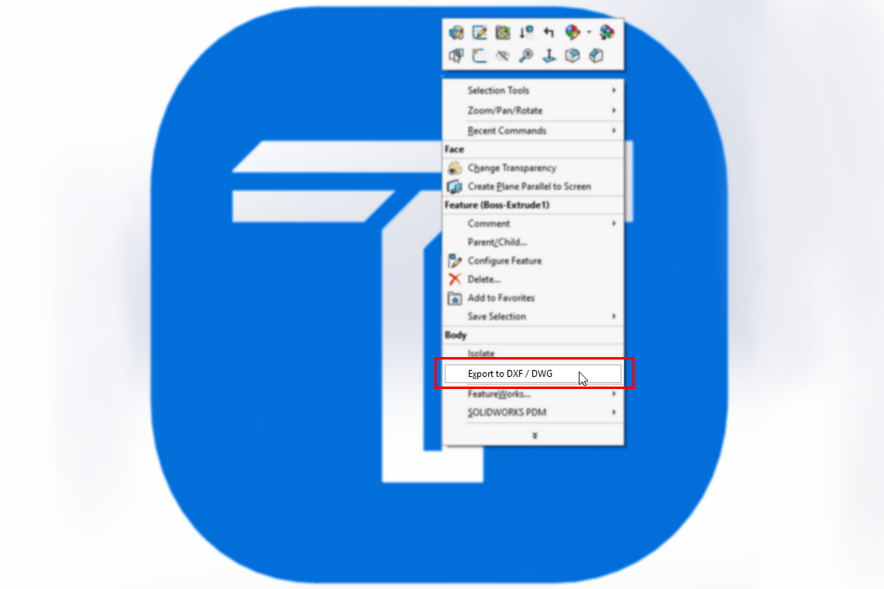

To create DXF files for cutting:
  1. Model the part as a flat body in SolidWorks. Use the sheet metal design tools or a extrude a flat sketch to create the geometry.
  2. Export the DXF by right-clicking the desired surface in SolidWorks and selecting Export to DXF/DWG.
Figure 1: Example of exporting a surface in SolidWorks to DXF/DWG.
This approach avoids including unwanted items like axis markings, sketch boundaries, or notes in the DXF file.

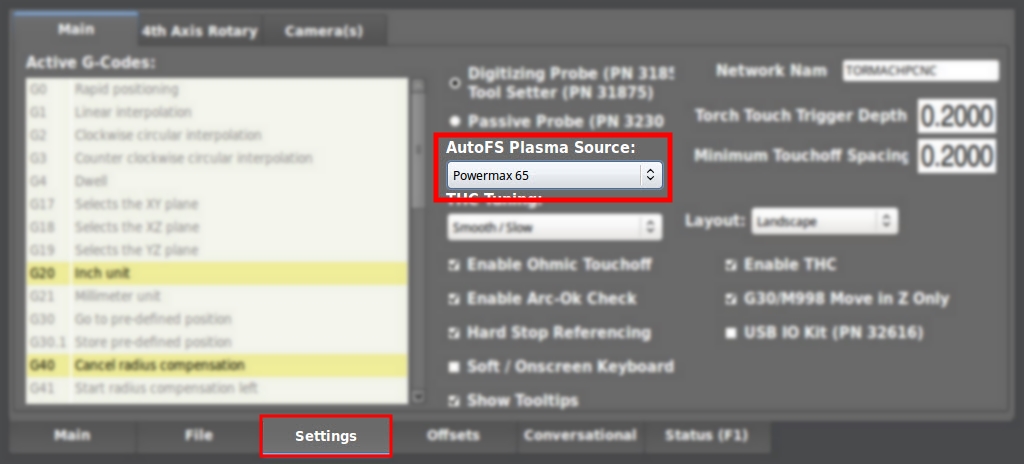

  1. On the Settings tab, select which plasma source you're using from the Auto FS Plasma Source drop-down menu.
  1. Before running your program, select the material you're cutting from the AutoFS dropdowns on the Main tab of PathPilot.
    The DROs turn green, which indicates that they were automatically set.

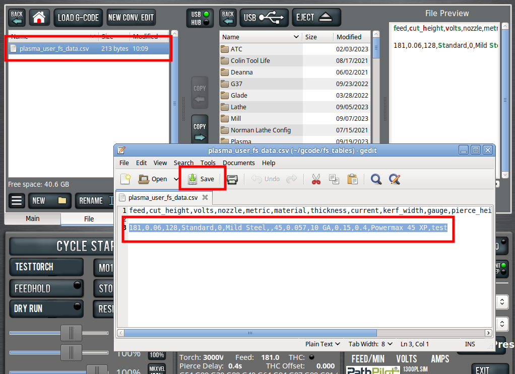

Deleting Custom AutoFS Presets
  1. From the File tab, navigate to the fs_tables folder, and open the plasma_user_fs_data.csv file.
  2. Highlight the line of the preset you want to delete and delete it. Then, save the file.
NOTE: This file is read on boot only, so the preset remains visible until the controller is power cycled.
