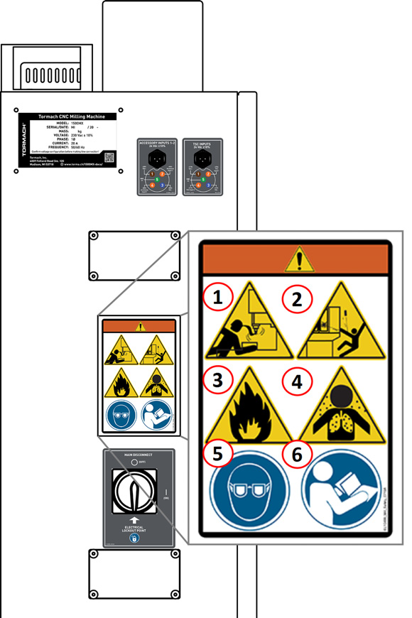

Next to the Main Disconnect
  1. WARNING! Entanglement / Entrapment Hazard. The machine operates under automatic control — it can start at any time and crush, cut, entangle, or pinch body parts. Always keep clear of positions on the machine where unexpected or unintended machine motion could cause harm. Before operating this machine in any way, you must verify that all operators know the location of the machine's Emergency Stop button.
  2. WARNING! Ejection Hazard. Fixtures, tooling, workpieces, or other loose items can become dangerous projectiles and can cause death or serious injury. Before operating this machine in any way, you must verify that you have appropriately secured all components.
  3. WARNING! Fire Hazard. The machine and its enclosure are not designed to contain fire or explosions. Only use materials and coolants that are intended for the specific machining operation. Never use flammable or explosive items.Before operating the machine in any way, you must read all Safety Data Sheets (SDSs) for any workpiece materials, coatings, coolants, lubricants, and other consumables used.
  4. WARNING! Inhalation Hazard. The machine and its enclosure do not protect you from airborne particulates. Chips, dust, and vapors from certain materials can be toxic or otherwise harmful. Before operating the machine in any way, you must read all Safety Data Sheets (SDSs) for any workpiece materials, coatings, coolants, lubricants, and other consumables used.
  5. Personal Protective Equipment: Eyes. Prevent injury by always wearing protective safety eyewear. Before operating this machine in any way, you must verify that your eyewear is impact-resistant and rated for ANSI 787+.
  6. Operator Knowledge. Before operating this machine in any way, you and all other operators must read and understand all instructions. If you don't, there's a risk of voided warranty, property damage, serious injury, or death.

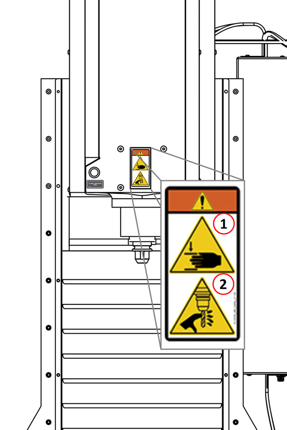

On the Spindle Nose
Figure 3: Example of a safety decal on the spindle nose.
  1. WARNING! Crush Hazard. Moving parts can entangle, pinch, or cut you, causing death or serious injury. Before operating this machine in any way, you must verify that all body parts, long hair, and clothes are clear of the machine's extent of motion.
  2. WARNING! Cut Hazard. Tools and swarf can cut you. Only hold tools by the tool holder. Before inserting or removing tools from the machine, you must verify that all motion is completely stopped.

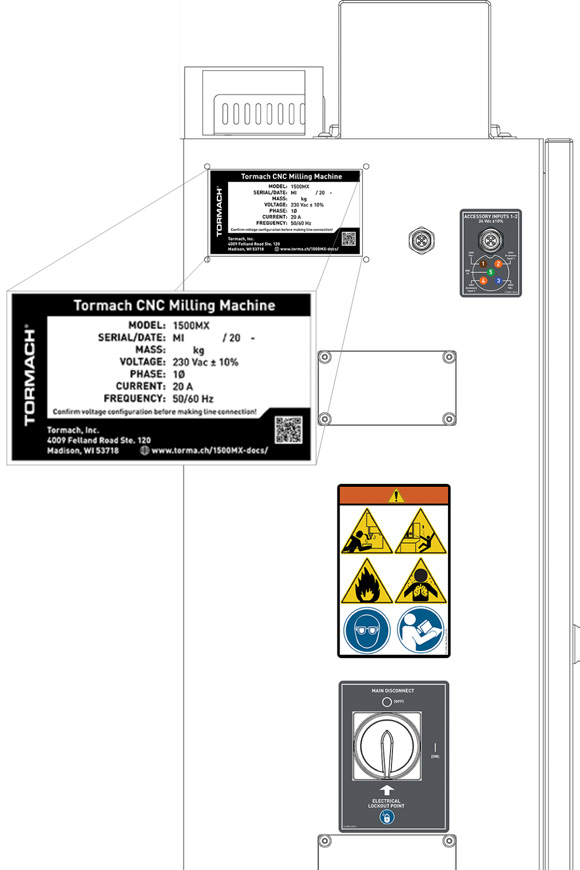

Serial Number Plate

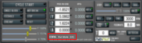

Run Mode (Mode 1)
When the enclosure doors are open, and the machine is in run mode, no motion can occur. For example, you can't jog the axis or control the spindle.

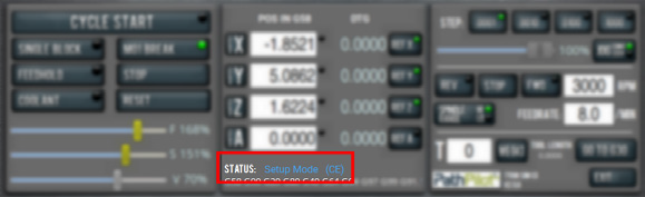

Setup Mode (Mode 2)
It's the machine owner's responsibility to verify that only personnel who are trained in operation, maintenance, or both shall access setup mode. Setup mode is intended only for qualified machinery operators and maintenance professionals, and only to set up a program or do maintenance procedures. When you're not using setup mode, you must verify that the machine is in run mode.
  • Mode Identification To identify which mode the machine is in, read the Status read-only field.
Figure 5: PathPilot indicates the controller’s current mode.

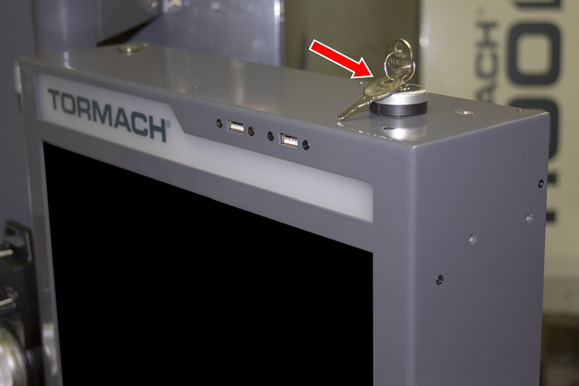

  • Key Use To access setup mode, you must have a key. Use the key on the top of the operator console to switch between modes.
 Figure 6: Setup mode key in the operator console.

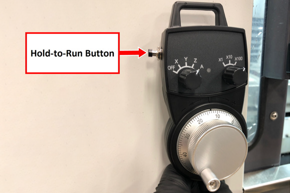

  • Hold-to-Run Device Use For machine motion to occur in setup mode, you must use a hold-to-run device. Hold-to-run devices include:
The button on the side of the operator console's pendant.
Figure 7: Hold-to-run button on the pendant

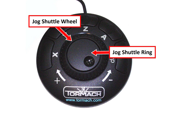

The jog shuttle wheel (the outer portion), which springs back to neutral when you release it.
 Figure 8: Jog shuttle components.
