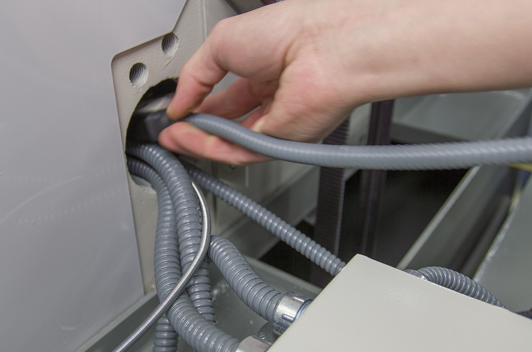

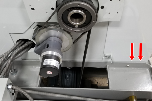

  1. Route the door switch cables through the base casting of the lathe (to the left of the belt guard cover).
Figure 1: Routing the door switch cables through the base casting hole.
  1. Continue to route the door switch cables under the lathe casting and toward the front of the machine.
Figure 2: Door switch cables routed to the front of the machine.

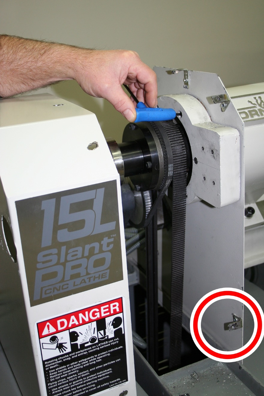

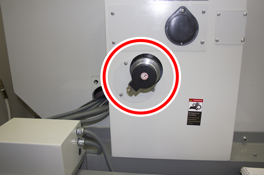

  1. Identify the rotary encoder on the belt guard cover.
Figure 3: Rotary encoder on the belt guard cover.
  1. Disconnect the power connector from the rotary encoder.
  2. Remove the five screws that secure the belt guard cover to the machine with a Phillips screwdriver, and set aside the belt guard cover and its screws.
  3. Identify the five belt guard cover mounting brackets. Then, loosen the top three brackets and the lower left bracket with a Phillips screwdriver, and remove and set aside the lower right bracket and its screws. The bracket that's completely removed is shown in the following image.
Figure 4: Lower right belt guard cover mounting bracket.

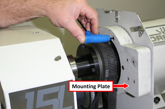

  1. Loosen the six socket head cap screws on the mounting plate with a 5 mm hex wrench.
Figure 5: Loosening the socket head cap screw on the mounting plate.
  1. Move the mounting plate to the left (away from the headstock). In the next section, you'll install the left side panel between it and the sheet metal guard, as shown in the following image.
Figure 6: Left side panel installed between the mounting plate and the sheet metal guard.

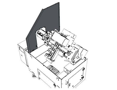

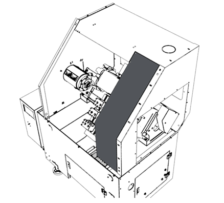

  1. Slide the left side panel over the spindle so that it's between the mounting plate and the sheet metal guard.
Figure 7: Left side panel installed between the mounting plate and the sheet metal guard.
  1. Verify that the panel is on the inside of the stand as shown in the following image.
Figure 8: Correct position of the left side panel, which is inside of the machine stand.

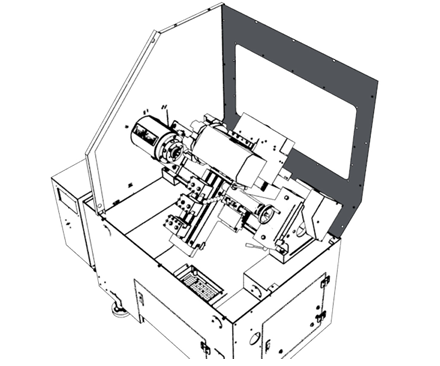

  1. Put the rear panel on the back of the stand so that the end of the panel is inside of the left side panel. Attach the rear panel to the left side panel with four M5 screws and a 3 mm hex wrench.
Figure 9: Rear panel installed.

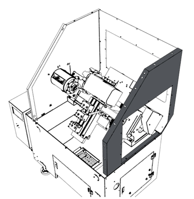

  1. Put the right side panel on the right end of the stand so that the rear panel is inside of the right side panel. Attach the right side panel to the rear panel with six M5 screws and a 3 mm hex wrench.
Figure 10: Right side panel installed.

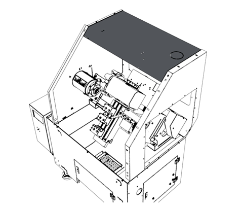

  1. Put the top panel between the side panels so that it's inside of the side panels' flange. Attach the top panel to the side panels and the rear panel with five M5 screws and a 3 mm hex wrench.
Figure 11: Top panel installed.
  1. Put the front right panel on the inside of the right side panel. Attach the front right panel to the right side panel and the top panel with six M5 screws and a 3 mm hex wrench.
Figure 12: Front right panel installed.

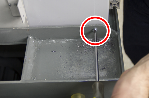

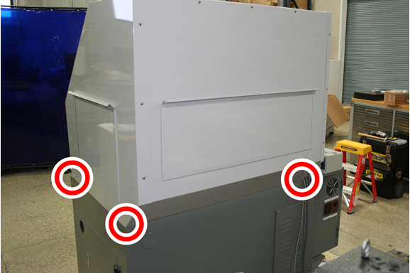

  1. Secure the enclosure to the machine stand with three M8 × 25 - 12 button head cap screws.
Figure 13: Corners on which to secure the enclosure to the machine stand.

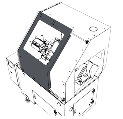

  1. Secure the left side panel to the machine stand with an M8 × 1.25 - 20 button head cap screw, an M8 nut, and a washer.
Figure 14: Securing the left side panel to the machine stand.

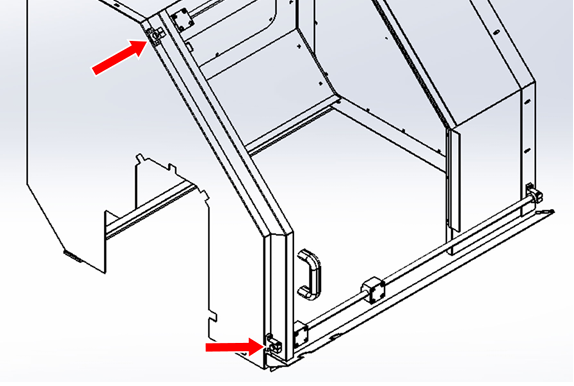

  1. Attach two of the linear rail supports to the left side panel with four M5 screws and a 3 mm hex wrench.
Figure 15: Linear rail supports attached to the left side panel.

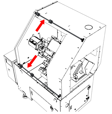

  1. Slide two linear bearings onto both door rails, and then slide one bumper onto each end of both door rails.
  2. Insert the left end of one linear door rail assembly into the top linear rail support on the left side panel. Then, attach it to the right side panel using the remaining linear rail support with two M5 screws and a 3 mm hex wrench.
  3. Repeat Step 3 for the bottom linear door rail.
Figure 16: Door rail assemblies installed.

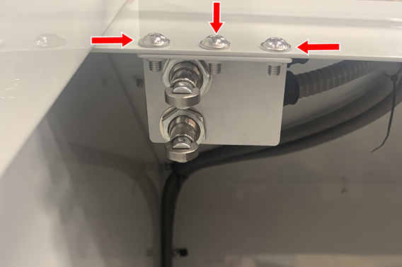

  2. Install the door switch mounting bracket with three M5 screws as shown in the following image. Verify that the bracket is mounted so that the screws are below the flange. If they're not, the screws interfere with the door switches.
Figure 18: Door switch installed.

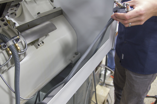

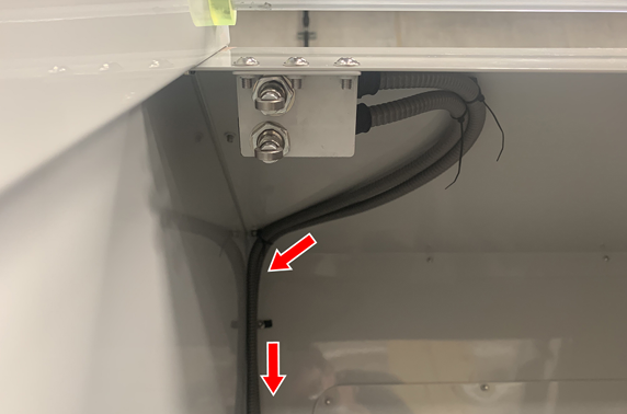

  1. Route the door switch cables through the machine, and secure them in place with cable ties, cable tie holders, and M5 screws. Verify that the cables are routed in the direction shown in the following image.
Figure 19: Door switch cable routing.
  1. Install the door switch trip bracket on the left side of the door with two M5 screws and a 3 mm hex wrench.
Figure 20: Door switch trip bracket installed.

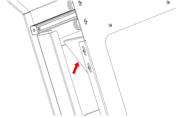

  1. Align the door rails:
    1. Loosen the two mounting screws that secure the upper left linear rail support to the enclosure panel.
    2. Slide the door closed, and then re-tighten the M5 screws on the upper left linear rail support with a 3 mm hex wrench.
    3. Open and close the door to test for smooth motion. If the door doesn't move smoothly, repeat Step 11 to adjust the remaining three linear rail supports.

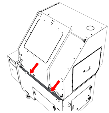

  6. Install the front drip tray to the inside of the machine stand with three M6 × 1 - 16 socket head cap screws, nuts, and washers.
Figure 21: Drip tray installed across the front of the enclosure.

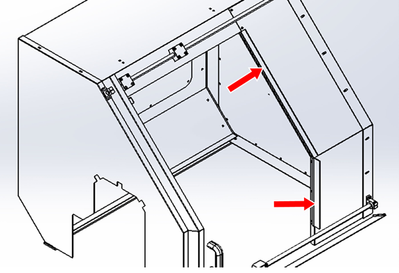

  1. Install the door brush to the left side of the front right panel with M5 screws and a 3 mm hex wrench.
Figure 22: Door brush installed to the left side of the front right panel.
