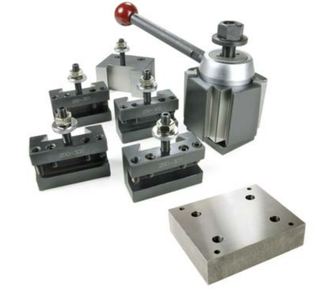

This document gives instructions on installing and using the Quick Change Tool Post Kit on a 15L Slant-PRO lathe.
Product Information
Product: Quick Change Tool Post Kit for 15L Slant-PRO (PN 33272)
Size
M8 × 40 mm Socket Head Screw
#1 Tool Holder for Quick Change Post (PN 33123)
CXA
#2 Tool Holder for Quick Change Post (PN 33124)
CXA
#4 Tool Holder for Quick Change Post (PN 33125)
CXA
Tool Post Handle
Quick Change Tool Mount Plate (33202)
Quick Change Tool Post (PN 34129)
CXA
Required Tools
  • Adjustable wrench
  • Dead-blow hammer
  • Magnetic dial test indicator
  • Metric hex wrench set
  • Rust preventative
