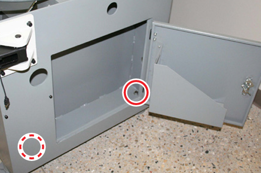

  2. Four pallet bolts are used to temporarily attach the pallet to the lathe; identify two right-hand bolts located inside the controller cabinet (see Figure 2).
Figure 2
  1. Loosen and remove nuts and washers from two bolts inside the controller cabinet.

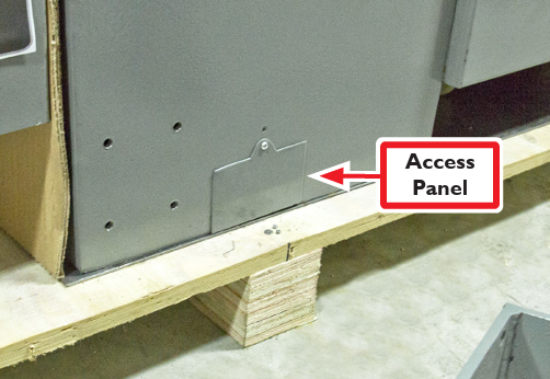

  2. Identify two small Access Panels on left side of lathe (see Figure 3).
Figure 3
  1. Using a Phillips screwdriver, remove Access Panels; set aside.
  2. Loosen and remove nuts and washers from two bolts inside the Access Panels.

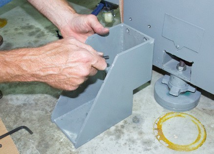

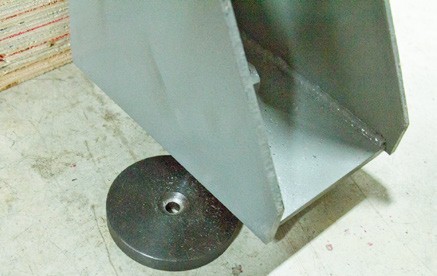

  3. Using four M8 x 20 mm Socket Head Cap Screws and four M8 Flat Washers, attach one Lifting Foot to each of the four corner attachment sites (see Figure 4); securely tighten.
Figure 4
  1. Slide a Lifting Pad underneath each of the four installed Lifting Feet; align hole on Lifting Pad with Lifting Foot’s bolt hole (see Figure 5).

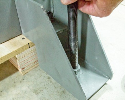

  1. Attach one M20 x 250 mm Threaded Rod through each Lifting Foot and into its Lifting Pad (see Figure 6).
Figure 6

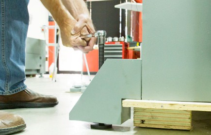

  1. Using a socket wrench, gradually adjust each Lifting Foot to raise the lathe evenly until lathe is clear of the floor (see Figure 7).
Figure 7

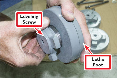

  1. Unscrew Leveling Screw on each Lathe Foot until close to full height (see Figure 8); apply a dab of grease on threads.
Figure 8

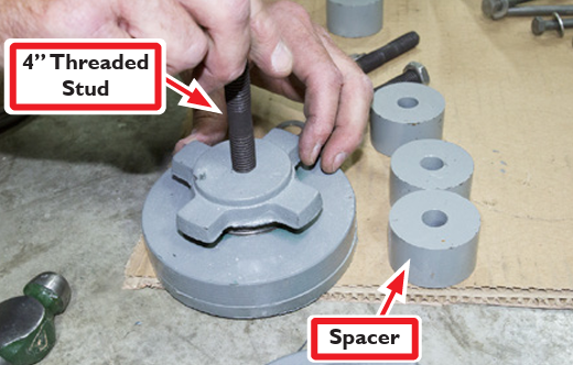

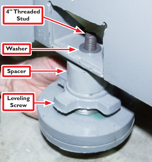

  1. Screw one 4” Threaded Stud into each Lathe Foot (see Figure 9); slide a Spacer onto each stud.
Figure 9
  1. Insert each lathe foot assembly into base of lathe via a lag bolt hole (see Figure 10). Slip a Washer onto each Threaded Stud and secure feet tightly with nuts.
Figure 10
