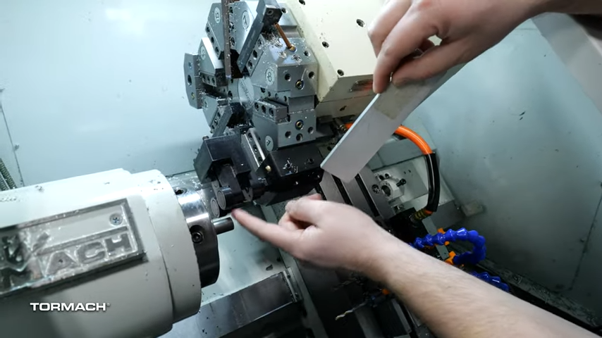

How to Set Tool Offsets for the Bar Puller
Like any cutting tool, the bar puller requires correct tool offsets to function properly.
Z-Axis Offset:
This can be set visually. Simply align the front rollers of the bar puller with the end of your part and set Z0 at that point. Precision isn’t critical here.
X-Axis Offset:
Setting the X offset is more nuanced because the bar puller grips the material with spring-loaded rollers. To determine the center of the rollers:
  • Use a shim or piece of flat material that spans both rollers.
  • Slowly jog the tool in until the shim can no longer move freely — this is your contact point.
  • Measure the roller radius (0.531 in), add the shim thickness (e.g., 0.25 in), and the bar radius (e.g., 0.3125 in for 5/8” stock). Multiply the result by two to get the total X-axis offset.
  • Enter that final diameter into your tool offset table.

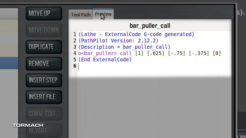

Programming the Bar Puller with PathPilot
Tormach provides a macro that automates the bar puller operation. The macro takes the following arguments:
  • Tool number: Which tool in the turret or quick-change post is your bar puller?
  • Material diameter: In inches.
  • Z position to grip: Where the bar puller contacts the material.
  • Pull distance: How much the bar is pulled forward from its previous position.
  • Mounting type: 0 for turret mount, 1 for quick-change post.
You can insert this call into your part program as a separate subroutine. In PathPilot®, use the “Insert File” function to add it easily.
