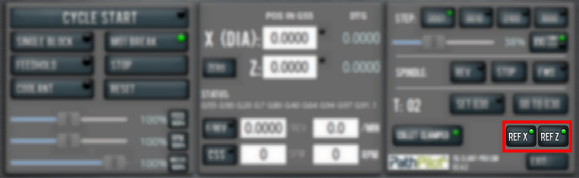

Reference the Machine
NOTE: The machine automatically references when it's powered on.
Figure 2: Reference buttons.
For more information on referencing the machine, see “About Referencing”.
About Referencing
The axes are referenced during assembly and do not need re-referencing after powering on or once the Emergency Stop button is released. You must reference the X- or Z-axis at the following times:
  • After replacement of a linear motion component such as linear rails, ballscrew, or servo motor
  • Disconnection of an encoder battery and powering off of the machine
  • Disconnection of the encoder cable from the servo motor
When referencing the X- and Z-axis, the machine moves to the end of travel, presses against the bumper on the ballscrew until torque increases, and then backs off to the index pulse of the encoder.

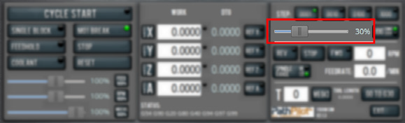

Figure 4: Jog Speed slider.

Jog the machine using the keyboard, Jog Shuttle, or Operator Console pendant. Whichever device you're jogging with, you can either:
For more information, see "Jog Controls Reference".
  • A keyboard key is pressed
  • The Operator Console's pendant wheel is turned in the desired direction
  • Roughly positioning the machine (for example, to move the cutting tool away from the workpiece).
  • Moving the machine a certain distance at a constant speed(for example, to manually face off a workpiece).

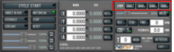

About Step Jogging
While jogging in step mode, the machine moves one step at a time. The jog step sizes range depending on the programming mode you are using:
Step jogging mode is useful to finely move the machine, like when you're indicating a workpiece or manually setting tool offsets.
The jog keys on the keyboard only move the machine in steps when step mode is indicated in PathPilot. The inner wheel on the jog shuttle always moves the machine in steps, regardless of which mode is indicated in PathPilot. The Operator Console's pendant moves the machine in the step size that's selected with the three-position switch.

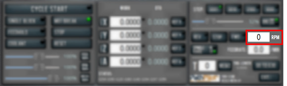

Manually Control the Spindle
  2. In the RPM DRO field, type the desired RPM speed. Then select the Enter key.
Figure 6: RPM DRO field.
  1. Select FWD to start the spindle in the forward direction, or REV to start the spindle in the reverse direction.
  2. Select Stop to stop the spindle.

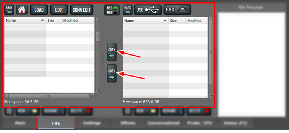

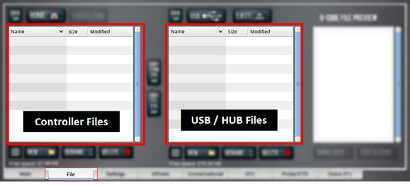

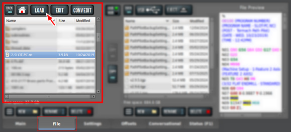

Load G-Code
To load G-code:
  2. Select Load.
Figure 7: Controller Files window on the File tab.
Figure 8: File tab.
  2. Select either Copy ← or Copy →.
Figure 9: File tab.
  1. If you're using a USB drive, select Eject.

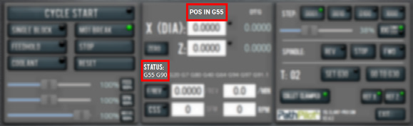

Set Work Offsets

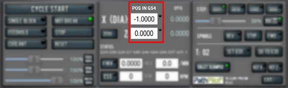

In the the X (Dia) DRO field, all values are expressed in terms of the diameter of the workpiece, not the radius.
Example
If the active tool is 2 in. away from the spindle centerline, 4.000 displays in the X DRO field.
  • Select Zero.
Figure 10: Work Offset DRO fields.
To change work offsets:
Figure 11: Work offset indicated in the PathPilot interface.
About Work Offsets
Work offsets allow you to think in terms of X and Z coordinates with respect to the part, rather than thinking of them with respect to the machine position. This means that you can jog the machine to an arbitrary location (like the end of a workpiece) and call that location zero.

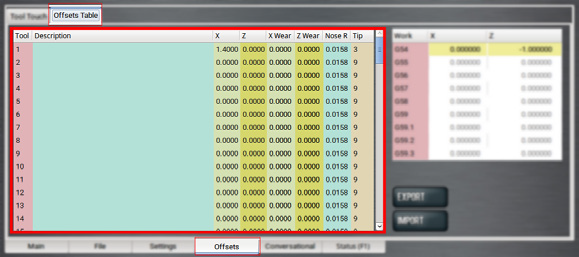

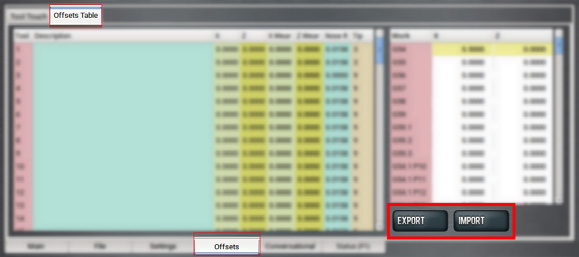

Set Tool Geometry Offsets
Before running a G-code program, PathPilot must know the geometry of the tools that are required for the program. For more information on using tool length offsets, see "About Tool Offsets".
NOTE: You can import a .csv file with tool geometry offset data. For information, see "Import and Export the Tool Table".
To set tool geometry offsets:
  1. Verify that the machine is powered on, out of reset, and the axes have been referenced.
  2. From the PathPilot controller, on the Offsets tab, select the Offsets Table tab.
  3. Find the Tool Table window.
Figure 12: Tool Table window on the Offsets tab.
  1. Touch off the tool geometry offsets. For information, see "Touch Off the Tool Geometry Offsets".
  2. (Optional) Select a field to edit. When finished, select the Enter key.

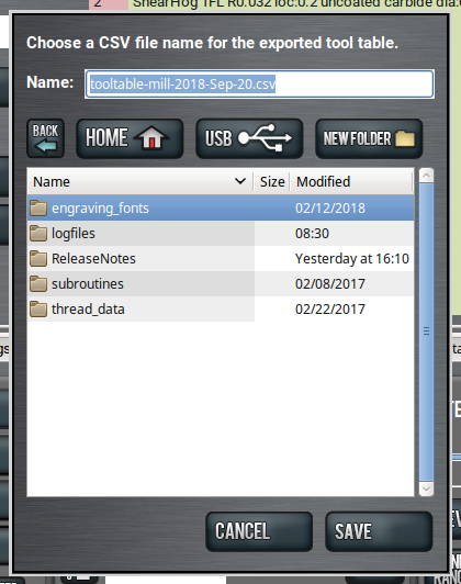

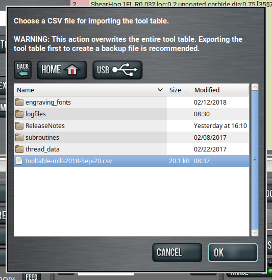

Figure 13: Export and Import buttons on the Offsets tab.
Import a .csv File
  4. From the Offsets tab, on the Offsets Table tab, select Import.
Figure 14: Import dialog box.
  1. From the Offsets tab, on the Offsets Table tab, select Export.
Figure 15: Export dialog box.
  2. Select Save.
  4. Select Eject.

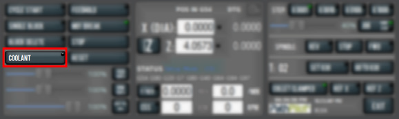

Operate the Coolant Pump
To turn coolant on or off:
  • Select Coolant.
Figure 16: Coolant button.
About Coolant
This is a section of the 15LX operator's manual. To view the whole manual, go to Tormach document UM10860.
