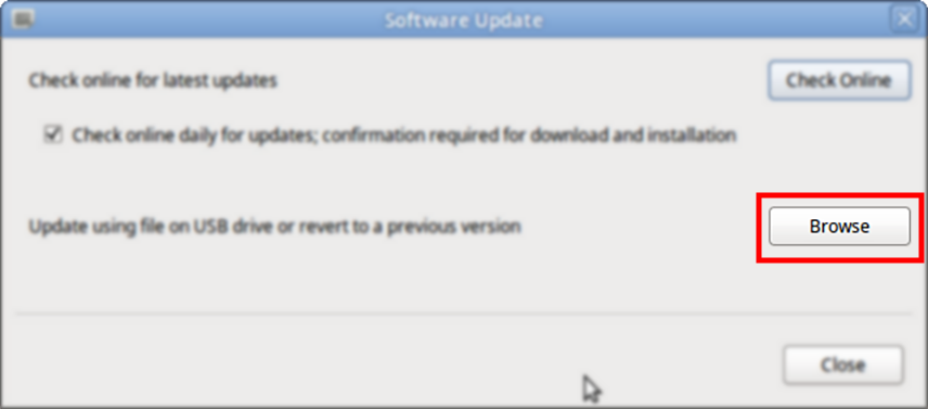

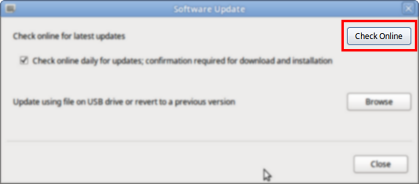

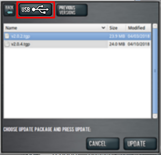

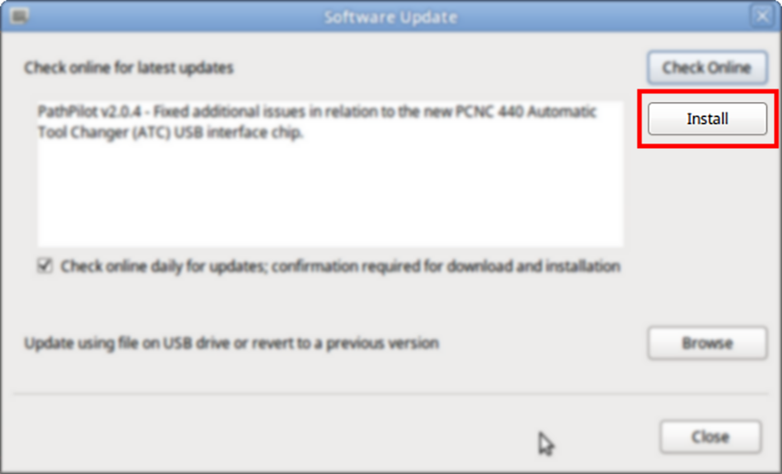

Update PathPilot
Before you begin to install this kit, you must verify that the PathPilot controller is updated to the latest version of PathPilot. This is because only PathPilot v2.4.2 and later has settings required to use a BT30 spindle mill configuration.
To update PathPilot, do one of the following:
  1. Select Install.
Figure 4: Update button on the Status tab.
Figure 5: Software Update dialog box.
Figure 6: Browse dialog box.

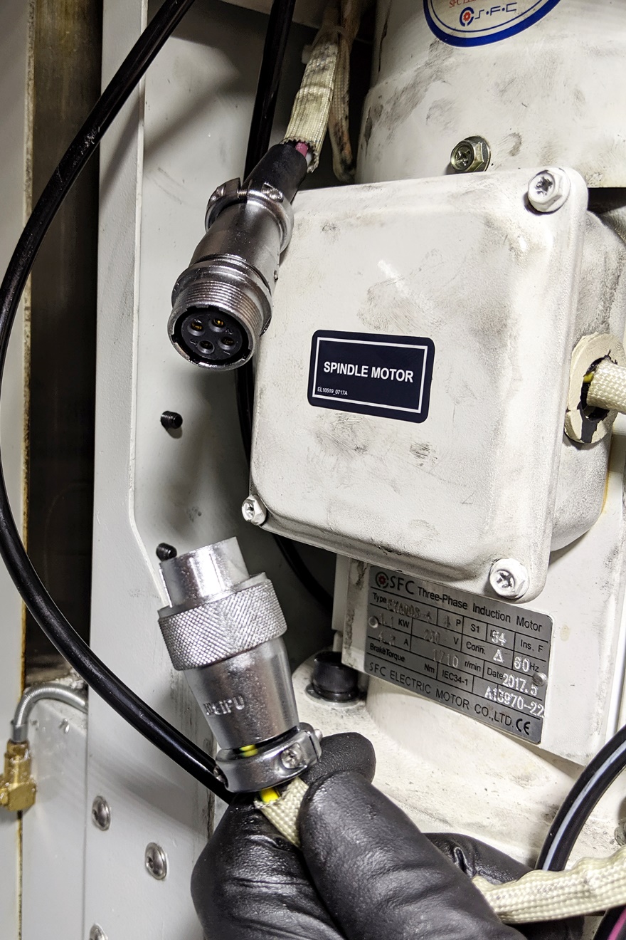

  6. Disconnect the spindle motor quick-connect fitting.
Figure 1: Spindle motor quick-connect fitting disconnected.

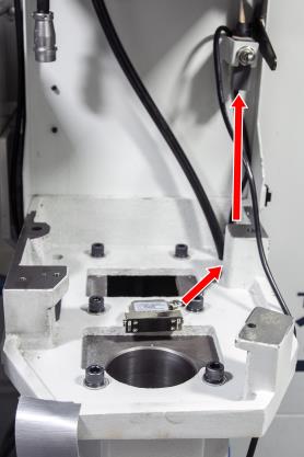

  1. Route the wire from the encoder along the floor of the casting, up behind the spindle door switch, and up through the energy chain.
Figure 17: Encoder wiring management.

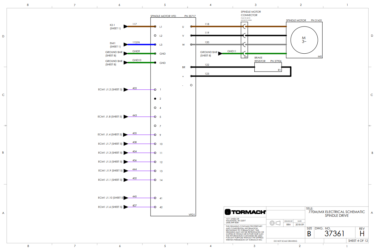

  3. Find the 9-position terminal block provided in this kit.
  4. Identify the pin connection locations on the terminal block. Pin 1 is closest to the small triangle on the outside edge of the connector, as shown in the following image. Pins 2 through 8 follow in sequential order.
Figure 19: Triangle on the terminal block, which indicates the location of pin 1.

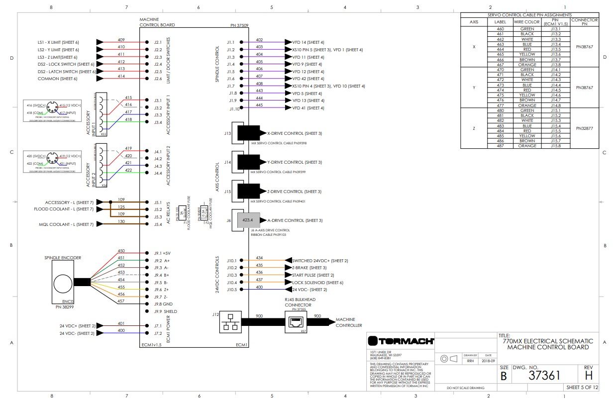

  1. Find the encoder wire that you routed through the cord grip into the electrical cabinet. Then, connect each encoder wire to the terminal block as detailed in the following table.
Connector Terminal Number
Encoder Wire Color
J9.1
Red
J9.2
Green
J9.3
Brown
J9.4
White
J9.5
Gray
J9.6
Yellow
J9.7
Orange
J9.8
Black
J9.9
No Connection
  1. Inside the electrical cabinet, remove the top wire trough cover and set it aside.
  2. On the ECM v1.5 board, identify the J9 connector. For information, see "Machine Control Board".
  3. If necessary, remove any tabs from the wire troughs surrounding the connector so that you can easily make wire connections.
  4. Connect the terminal block with the encoder wires to J9 on the ECM v1.5 board.
Figure 20: Encoder wire connected to J9 on the ECM v1.5 board.

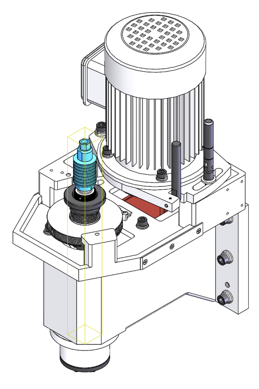

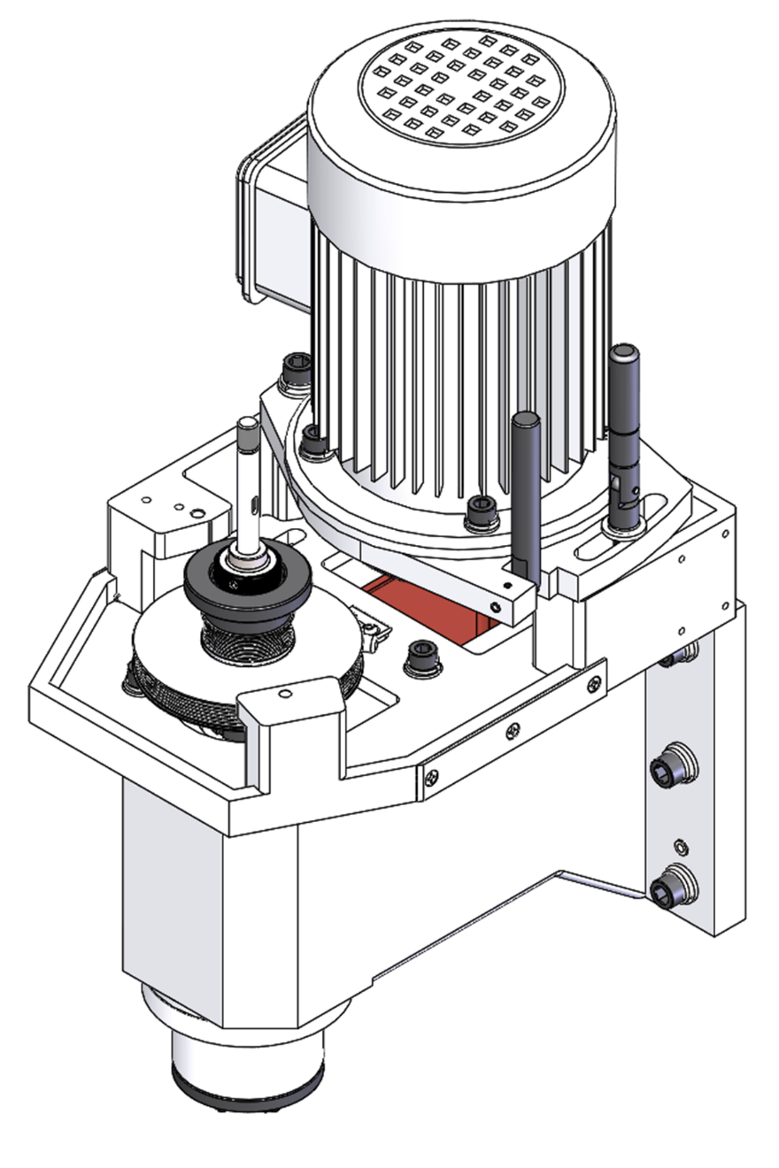

Install the BT30 Spindle and Align the Encoder
Tip! For more information while installing BT30 components on the machine, it may help to refer to the "Spindle Cartridge".

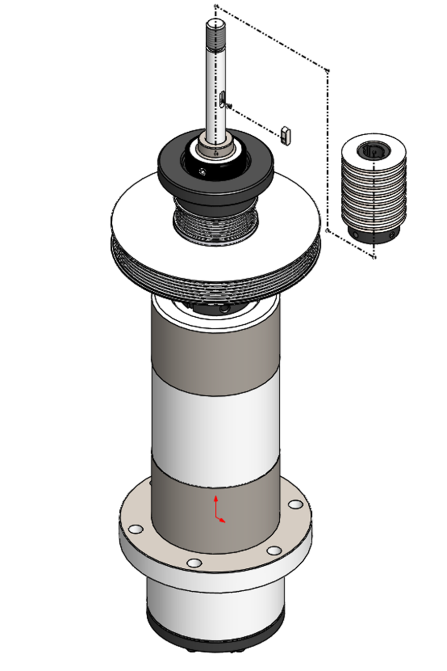

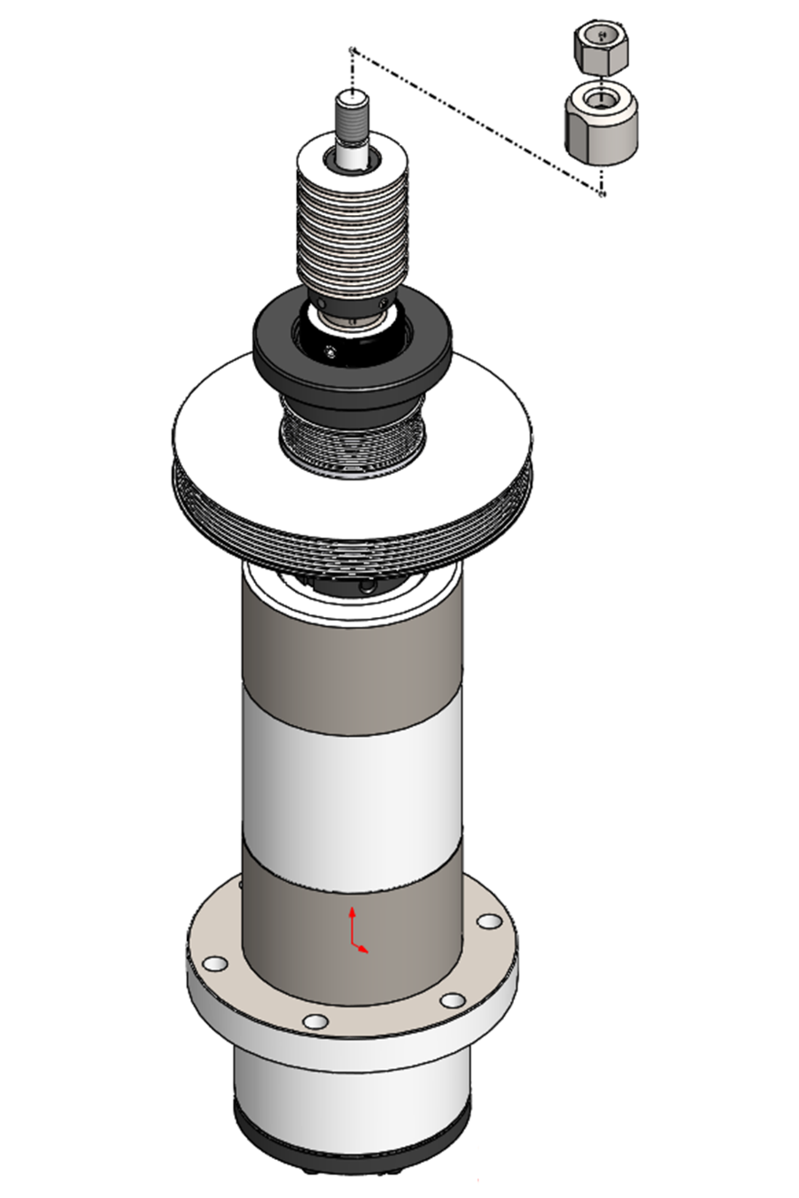

  3. Disassemble the BT30 spindle:
    1. Use a 4 mm hex wrench to prevent rotation of the drawbar shaft.
Figure 21: Preventing the drawbar shaft from rotating.
b. From the top of the drawbar, remove the jam nut with a 19 mm open-ended wrench and remove the disc spring compression nut with a 25 mm open-ended wrench. Some drawbar assemblies also include a number of shim washers beneath the disc spring compression nut. If your spindle includes these, save them and reinstall them in the same location in Step 22.
Figure 22: Jam nut and disc spring compression nut removed from the drawbar.
c. Loosen the two set screws on the disc spring guide with a 2 mm hex wrench, and then remove the following items from the drawbar stack assembly:
  • Disc springs, 16
  • Disc spring guide
Figure 23: Disc springs and disc spring guide removed from the drawbar.

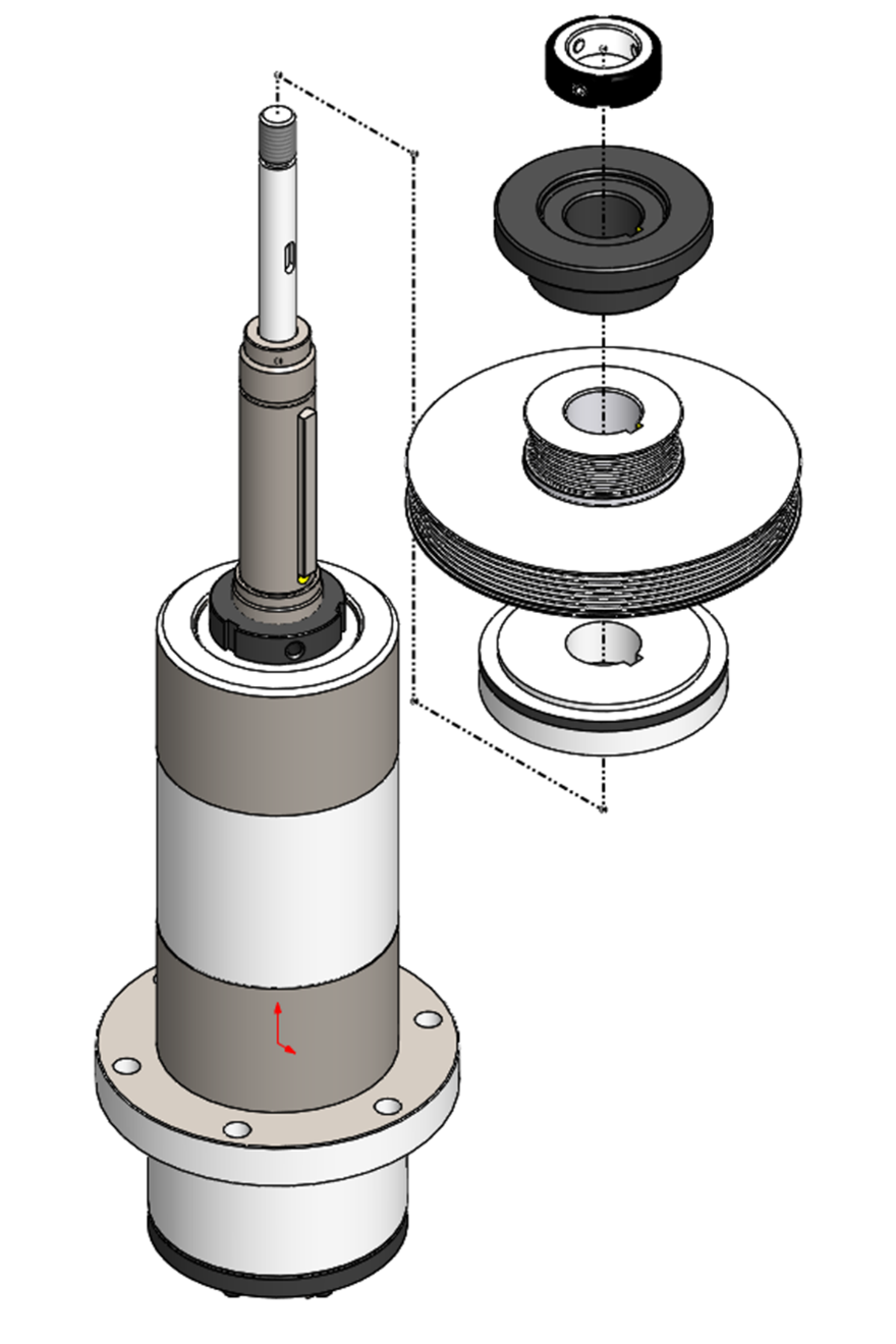

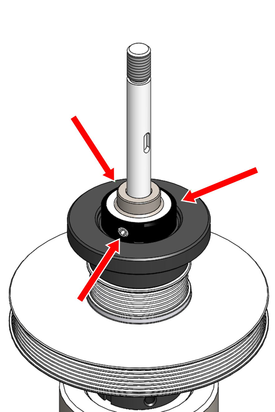

d. Loosen the three set screws that secure the retention nut with a 3 mm hex wrench.
Figure 24: Three set screws on the retention nut.
e. Remove the retention nut with the provided spanner wrench. Set the retention nut aside.
Figure 25: Removing the retention nut.
Tip! For a better grip on the pulley, we recommend using the old 260 Poly-V belt to hold it in place.
f. Remove the following items from the BT30 spindle:
  • Encoder ring
  • Power drawbar flange
  • Pulley
Then, set all items aside.
Figure 26: All items from a disassembled BT30 spindle.

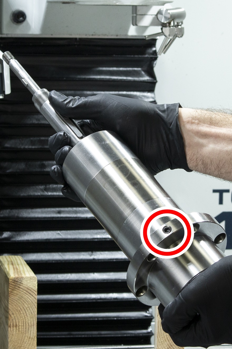

  3. Identify the hole on the spindle flange as shown in the following image.
Figure 27: Hole on the spindle, which you must verify is pointing toward the machine column to install.
  1. Turn the spindle so that the hole is pointing toward the machine column. Then, put the spindle between the two blocks of wood on the machine table.

  6. Install the encoder ring with the magnetic ring pointing up (away from the machine table). Then, remove any stickers from the encoder ring.
  7. Position the encoder tangent to the encoder ring, setting the distance using a piece of paper (approximately 0.003 in.).
  8. Tighten the two flange screws to secure the encoder in place. Remove the shim.
  9. Rotate the spindle by hand to confirm that there's no risk of entanglement.
  10. Install the pulley and power drawbar flange over the top of the spindle as shown in the following image.
Figure 29: Encoder ring, pulley, and power drawbar flange installed.
  1. Reinstall the retention nut with the provided spanner wrench. Secure it by tightening its three set screws with a 3 mm hex wrench.
  2. Install the disc spring guide and disc springs. Install disc spring compression nut, jam nut, and any shim washers. Verify that the drawbar preload witness marks are aligned.
Figure 30: Disc spring guide and disc springs installed.
NOTE: If the witness marks rubbed off during the installation, tighten the disc spring compression nut until it's snug, secure it with the jam nut, and make further adjustments after completing the Power Drawbar upgrade and/or installation. For information, see (refer to the section regarding insufficient preload of drawbar springs).

  2. Reconnect the motor quick-connect fitting.
Install the VFD (Serial Number MB10540 and Below Only)
  2. Open the electrical cabinet door and identify the variable frequency drive (VFD).
  3. Remove the lower wire trough cover from the electrical cabinet and set it aside.
  4. Remove the access panel from the VFD with a flat-blade screwdriver and set it aside.
  5. Remove all of the wires connected to the VFD with a flat-blade screwdriver, Phillips screwdriver, or torque driver as necessary.
  6. Loosen the four mounting screws that secure the VFD to the electrical cabinet with a Phillips screwdriver. Set the mounting screws aside, and remove the VFD from the electrical cabinet.
  7. Find the new VFD provided in this kit. Then, remove its access panel with a flat-blade screwdriver, and install it in the electrical cabinet with the four mounting screws that you set aside in Step 6.
  8. Install the wires that you removed from the old VFD in Step 5 into the new VFD. Use the following images (and the "Spindle Drive" wire schematic) to verify all connections.
Figure 31: VFD wiring.
Figure 32: VFD wiring.
Figure 33: VFD wiring.
  1. After double-checking and confirming wire connections, replace the access panel on the VFD.
  2. Organize the wires from the VFD into the lower wire trough, and then replace its cover that you set aside in Step 8.
  3. Close the electrical cabinet door.
Verify the Installation
    3. Press the Reset button.
  2. From the PathPilot interface, on the Main tab, in the MDI Line DRO field, type Admin Config. Then select the Enter key.
    In the dialog box, select OK.
  3. From the Tormach Machine Configuration screen, select 770MX. Then, select Save and Start.
    The PathPilot interface loads.
  5. On the Main tab, in the MDI Line DRO field, type Admin Encoder Test. Then select the Enter key.
    Follow the on-screen instructions.

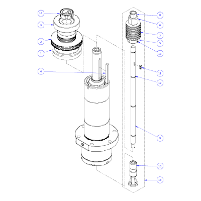

Resources
Spindle Drive
Spindle Head

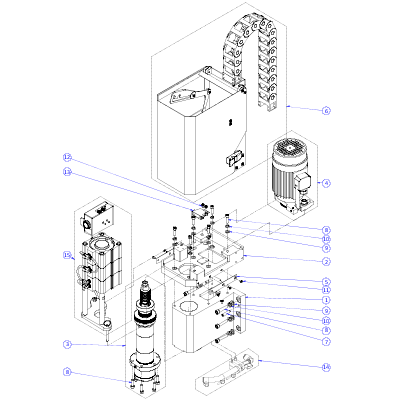

770M
770MX
770M
ID
770 Head Casting (PN 31522)
770 Spindle Motor Base (PN 31548)
770 Motor Mount Plate (PN 31549)
Tightening Washer (PN 31536)
Spindle Lock Base (PN 38716)
770M Spindle Lock Bar (PN 38718)
Washer, M6, Nylon (PN 38714)
Screw, M8 × 1.25 - 10 mm (PN 31682)
Spring, 6 mm × 20 mm (PN 31559)
Ball, 6 mm, Steel (PN 38225)
11
Pivot Bushing (PN 31555)
12
Adjustable Base Handle (PN 31556)
13
Pin (PN 31558)
14
Motor Pulley, 770 (PN 31571)Motor Pulley, 770
15
Motor Pulley Spacer, 770 (PN 31595)
16
Spindle Motor, 770 (PN 31431)Spindle Motor, 770
17
Wear Strip, Spindle Door (PN 38451)
18
Tapered Dowel Pin, 8 × 40 mm (PN 31544)Tapered Dowel Pin, 8 × 40 mm
19
Pin, Pull-out, 6 × 45, M4 × 0.7 Thread (PN 31557)
20
Square Key, 5 × 20 (PN 31535)
21
Power Drawbar Spring Washer (PN 31319)
22
Screw, Socket Head Cap, M6 × 1 - 45 (PN 38715)
23
Screw, Socket Head Cap, M6 × 1 - 20 (PN 30832)
24
Screw, Socket Head Cap, M8 × 1.25 - 30 (PN 30544)
25
Screw, Socket Head Cap, M5 × 0.8 - 14 (PN 31563)
26
Washer, Flat, M8 (PN 30531)
27
Washer, Split Lock, M8 (PN 32339)
28
Screw, Cone Point Set, M5 x 0.8 - 8 (PN 30337)
29
Screw, Socket Head Cap, M10 × 1.5 × 50 (PN 31597)
30
Screw, Socket Head Cap, M12 × 1.75 × 35 (PN 35762)
31
Washer, Flat, M12 (PN 32473)
32
Washer, Flat, M10 (PN 30919)
33
Washer, Split Lock, M10 (PN 31684)
34
Tormach Tooling System (TTS) Adapter Collet: R8 (PN 50568)
35
Power Drawbar Alignment Bushing (PN 31330)
36
Drawbar, R8 (7/16-20), 305 mm (PN 38793)
37
Power Drawbar Flange1
38
Spindle Pulley1
39
Screw, Flat Head Cap, M5 × 0.8 - 12 (PN 38894)
40
Bearing Nut, M25 × 1.5, Set Screw (Angled)1
42
Spindle Pulley Spacer1
43
R8-TTS Spindle Assembly, 770M (PN 37960)1
44
Spindle Cover Exploded View

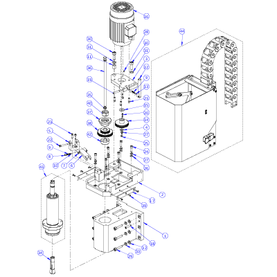

1R8-TTS Spindle Assembly, 770M (PN 37960) includes the following balanced and matched parts: #37, #38, #40, #42, and #43.
770MX
ID
BT30 Spindle Assembly, 770MX (PN 39591)
770 Spindle Motor Pivot Plate Assembly (PN 50449)
770 Spindle Cover (PN 37698)
18
12
12
11
12
13
Magnetic Encoder, Readhead (PN 38299)
14
Mill Coolant Manifold Assembly (PN 38346) (Optional)
15
1100MX/770MX Power Drawbar Assembly (PN 39711)
16
770 Spindle Pulley Belt (PN 31435)770 Spindle Pulley Belt
Spindle Cartridge
ID
Magnetic Encoder, Spindle Ring (PN 38298)
Spindle Pulley, 770MX (PN 39586)
Flange, 770MX BT30 Power Drawbar (PN 50453)
Key, Straight, 6 mm × 6 mm - 64 mm (PN 39579)
Disc Spring Guide, MX BT30 Spindle (PN 39597)
Disc Spring Compression Nut, MX BT30 Spindle (PN 39598)
Disc Spring, 40 mm × 20.4 mm × 2.0 mm × 3.10 mm (PN 39689)
16
Nut, Jam, M12 × 1.75 (PN 39602)
Drawbar, BT30 Spindle (PN 39574)
Clamping Unit, BT30 (PN 39690)
11
Key, Straight, 4 mm × 4 mm - 12 mm (PN 39601)
12
O-Ring, 9 mm × 12 mm × 1.5 mm, Buna-N (PN 39584)
13
Screw, Flat Point Set, M4 × 0.7 - 5 (PN 50455)
14
Nut, Bearing, M25 × 1.5 (PN 39589)
15
Screw, Flat Point Set, M10 × 1.5 - 8 (PN 50454)
16
Screw, Socket Head Cap, M5 × 0.8 - 20 (PN 30357)Screw, Socket Head Cap, M5 × 0.8 - 20
17
BT30 Clamping Unit Installation Tool (PN 50385)
18
Drawbar Core Assembly, MX BT30 Spindle (PN 39599)
